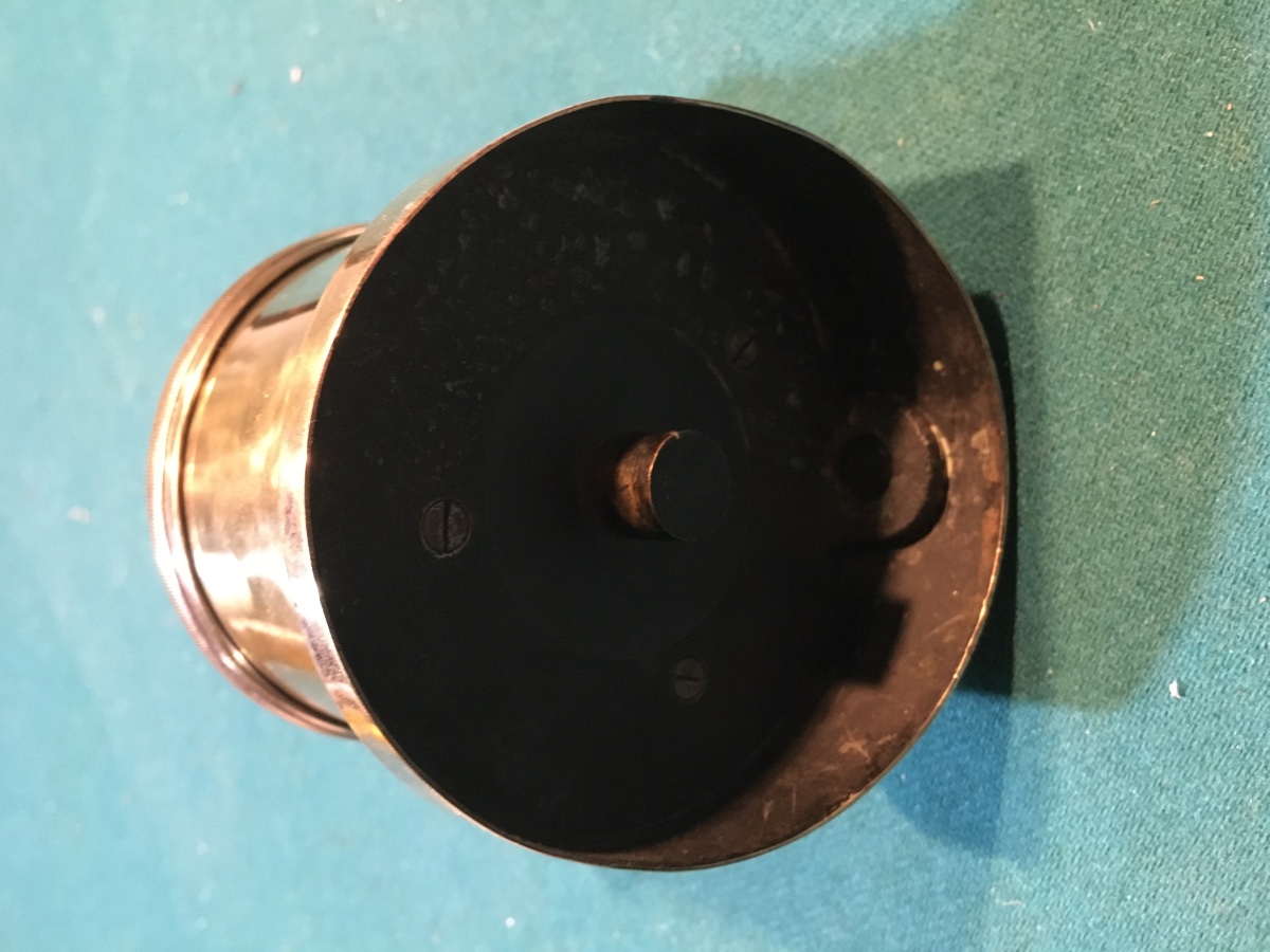

Here is a Phinney Walker rim wind with a angled case. How does something like this mount on the dash? It has a set screw on the bottom. I’m thinking that perhaps there was some sort of bracket that it mounted to in the firewall. Any help much appreciated

Mike, yes , you are missing the mounting bracket. I think I have one that would show what’s missing. Easily made. Nice clock! The small hole cover is often missing, so you are good to go there.

Great thanks. I’d love to see a picture/Know how to make one. Thanks Mike

Mike, I have two here that are different. I’ve got another that’s off for repair. There will be a plain looking bracket of some sort that will get screwed to the dash. your clock will hang on this bracket, and opening the cap at th bottom, and reaching a screwdriver up inside will attach it securely to the bracket, making it rather difficult to steal. Putting a $10 clock on an original vehicle was quite the expense back then. I’ll post a picture of another type, this one hangs on two angled tabs, and then the screw will secure. Yours uses that big center pin, I think. Good luck, I’m sure you can make something that will work.
