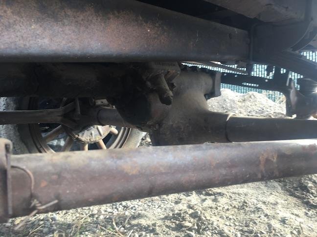

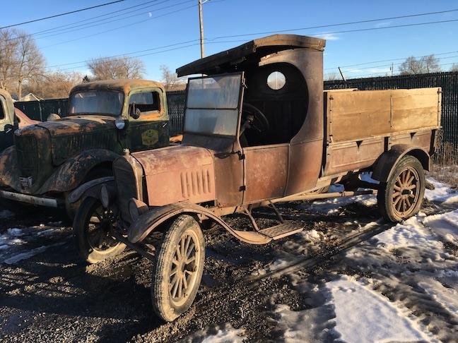

Anybody know what this is?? It's on a C Cab TT a guy in Billings is getting ready to sell.
2020 1 25 tt truck It's not mine, I can probably get some more info but I think at this point he just wants to know what this trans is. I don't recall every seeing one like it. transmission.JPG

Right its not a Lincoln brand TT accessory.

It’s not a lincoln, as I have one on my Tt. I believe it’s a Fuller brand, made in Kalamazoo. Not 100% sure , but an educated guess. I had one 20 years ago, and was able to remachine it a bit to make it an overdrive. I’m starting to forget more than i remember.

Right on Tim, very educated guess.

Neat gizmo. Since it's for a TT, I would imagine it's a direct and over, but it doesn't say that anywhere I can find. Does anybody know for sure?

Yes, I know for sure they were under and direct. Very few original TT transmissions were OD. Pulling power is what was needed back then. I’m recalling now the one I had was in pretty poor shape. In my opinion, they were not built very stout compared to other brands. Surprising because the fuller company made a whole car before they shifted( pun) to the transmission line. They continued building transmissions way after the model T and A days, so they must have been reliable. Perhaps the one example I had might have had a million hard miles on it. That’s one reason I remade it as an overdrive unit. It was a challenge but worthwhile.

If you read the advert., you just cut the torque tube, the original driveshaft passes right through the unit. Also, no neutral, another good feature.
