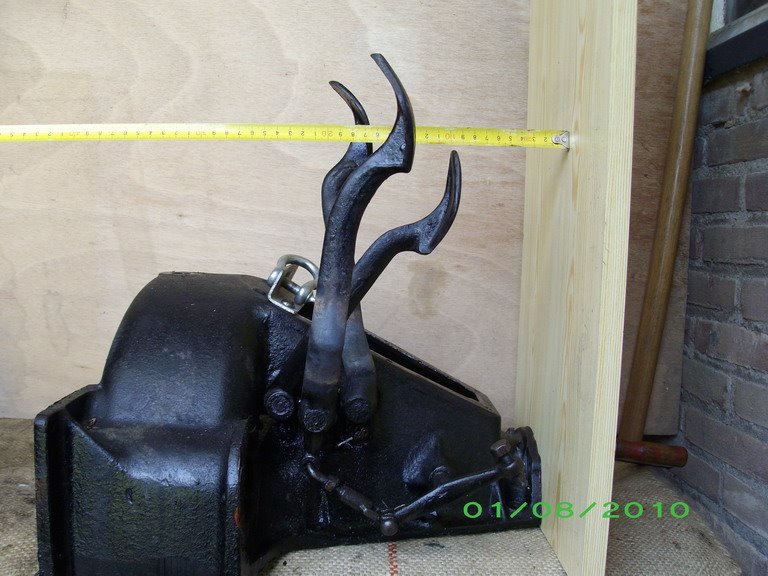

Here is another's photo with measure of the approx. distance for the brake pedal at full release (rearward). May want to check. The tape measure is metric.
Converts to English approx. 6 3/4"

Dan, thanks for the photo example. My brake pedal is forward considerably more than yours. Now all I have to do is buy a metric tape measure..... :lol:
Quick edit: I just measured the distance from the rear of the hog's head to the middle of the brake pedal.......8 1/2".......so there's definitely a bend involved. Funny thing is, the pedal looks normal which is why I didn't spot it until after assembly. No matter, we heat and bend!
