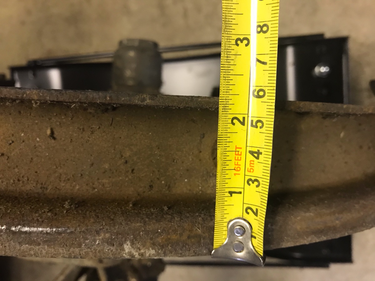

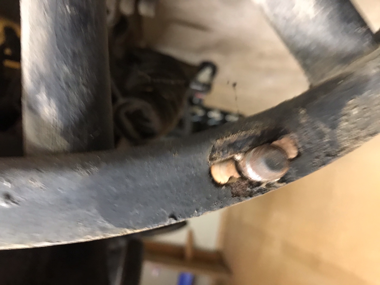

Here are a couple of other photos of the wheel. Unfortunately, I cut off one edge of the wheel, but I don't think it has a notch cut out of it like the ones in the EBay ad.

Ok looking good so far. Do the fellows have a notch about 180ish from the latch holding the ends together?

Here are some other pics of the whole wheel. No notch that I can see.

Milford, my first suggestion at this point is to find a set of proper wheels and rims for you car, the 30X3-1/2's.
Looking back over the photos I am seeing a mixed bag of parts, maybe.
In your ad for the rims, the photo shows one with the dimple which should be the 26/27 style that would need a notch in the fellow like I showed above. In your above photos, the first rim you show with the tape is 2-3/4 to 3" across the back, but from the other side is about 3-1/2" and the wheel shows no notch. Were they the same rim? The 1928 did not have the notch or dimple.
If you wish to continue with the wheels on the car:
Measure across the top of all 4 fellows and rims. Dose not matter where they are on the car just the measurements. Are all the rims/fellows about the same width?
Side by side; narrower 26/27 and wider 28 rims; While I am no expert, I am learning more as I go along. Nice thing about Ford in the era they were mostly standardized, well except for rims and wheels but that is another story at this point.

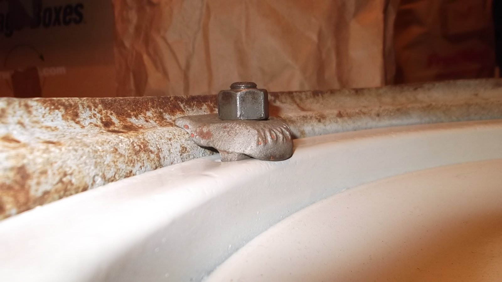

Just for comparison purposes here of some pics of a 21” Ford wheel and split rim. Looking at the Ford and Chev differences the most noticeable is the notch in the chev felloe for the lugs. The bolt hole is probably the same size in both fellows.
Other than that the wheels look pretty close.

If the fellow on the 1926/27 Chevrolet wheels are both the same, wood or disk, the Ford 21" rim will not fit on the 1926/27 21" Chevrolet wheel for those years, been there, tried that
The ridge on the Ford or Chevrolet fixed lug rim will not let them go on and the fixed lug holes do not line up.
I have a number of 21" rims, both Ford and Chevrolet, mounted fixed lug type. They range in width of about 3-1/4 to 3-1/2 inches which would be the right size. I was going thru the process of grinding off the ridge on one of the not so good ones. You have to remove the lugs and plug weld the holes then try to keep the ridge you are grinding down at an even height. To keep the rim from moving on the wheel, a locating lock is needed on the rim. The rim I tried this with, things were just not lining up, the lock needed to be on top of the latch assembly basically and would not let the rim bolt to pass thru as is, still working on it. (working with 26/27 disk wheels with spacers on Ford hubs) The approx. 1925-26 Chevrolet wood wheel used 21" rims with fixed lugs like the 26/27 Ford, same except the valve stem hole is in different locations, but these wheels that we are trying to help with are not the 25/27. Those I have rims for!
