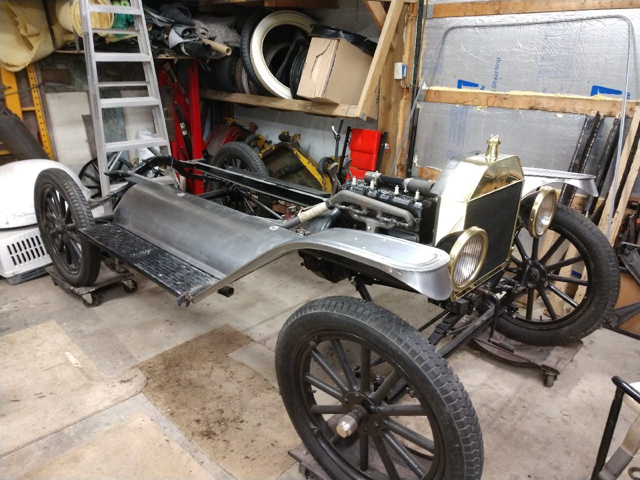

Post by FordorGalore » Tue Dec 31, 2019 3:16 pm
Its starting to look like a Centerdoor. Still nothing is fastened but its time is coming.

Re: '16 Centerdoor restore...
Post by mtntee20 » Tue Dec 31, 2019 3:40 pm
Hi Don,
Love your work. Looks Great.
Question: In your last photo, I see a hole in the rear quarter panel. I expect that hole if for the fender mounting bracket. This bracket is straight, threaded on the inside to go through a D-pillar bracket with a nut to mount. In your photo, the D-pillar looks very similar to our 19-20 but I don't see your D-pillar brackets. I can post a photo of our D-pillar brackets and fender mounting bracket if you would like.
Thanks for posting all of the photos.
Good Luck,
Terry Miller
Post by FordorGalore » Tue Dec 31, 2019 3:55 pm
Thank you Terry, I do have the "D" pillar bracket and fender mount. I just haven't gotten to that point yet. I really appreciate your offer!! Happy New Year !! :)

Working on the top rails and checking the distance of the overhang. I'm using the rain gutter for a guide on both. The gutter seems to be happy about it. Still NOTHING is fastened or finished here. Just having fun with it. ;)

Post by Wayne Sheldon » Tue Jan 07, 2020 3:47 pm
Looking good!

On to the tuning stage. Thought I would check the fit of the cowl and front side panels. I'm thinking this is about as good as its going to get. Still nothing is fastened in the final sense.
