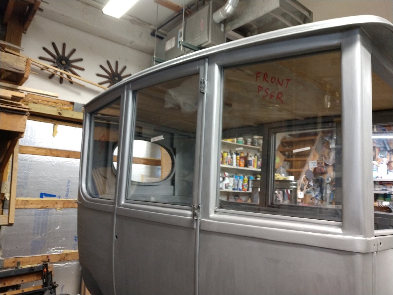

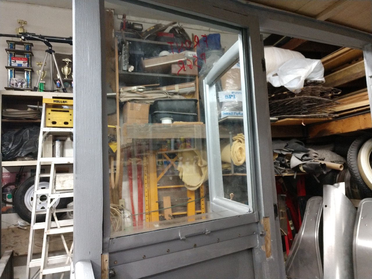

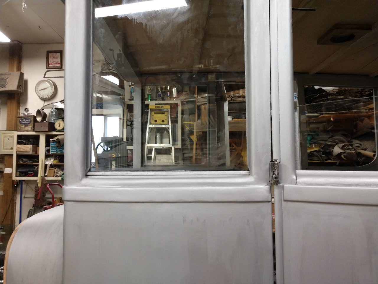

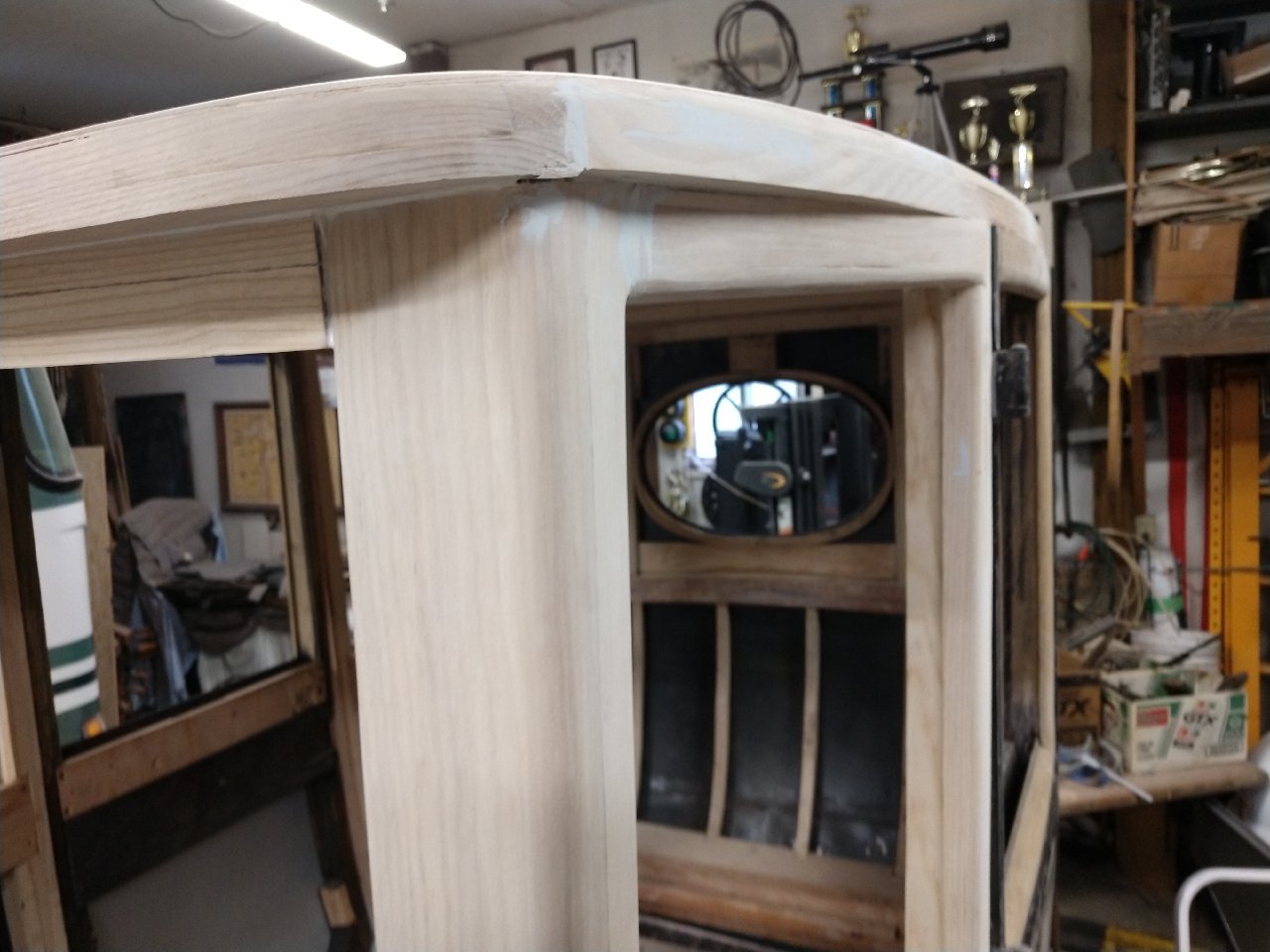

Both doors are rebuilt and ready for another 50 years (I hope). Now the sanding begins... Mike Husted straightened me out on the rear seat so its back to being correct.

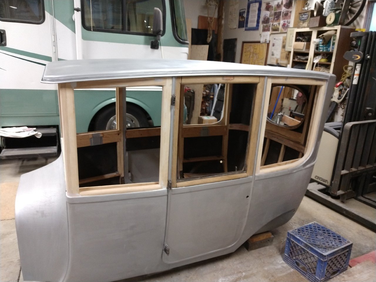

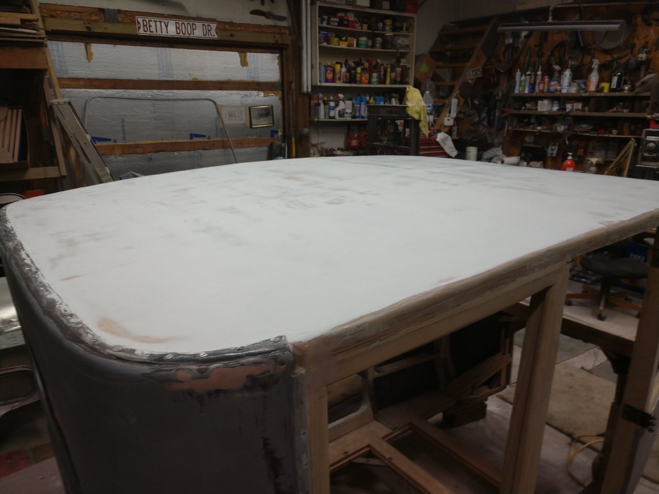

Post by FordorGalore » Mon Feb 17, 2020 3:52 pm

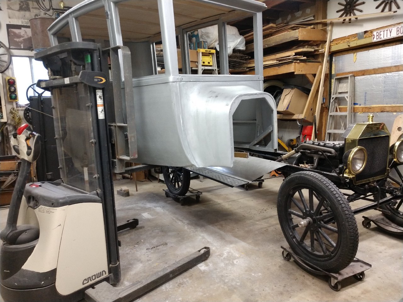

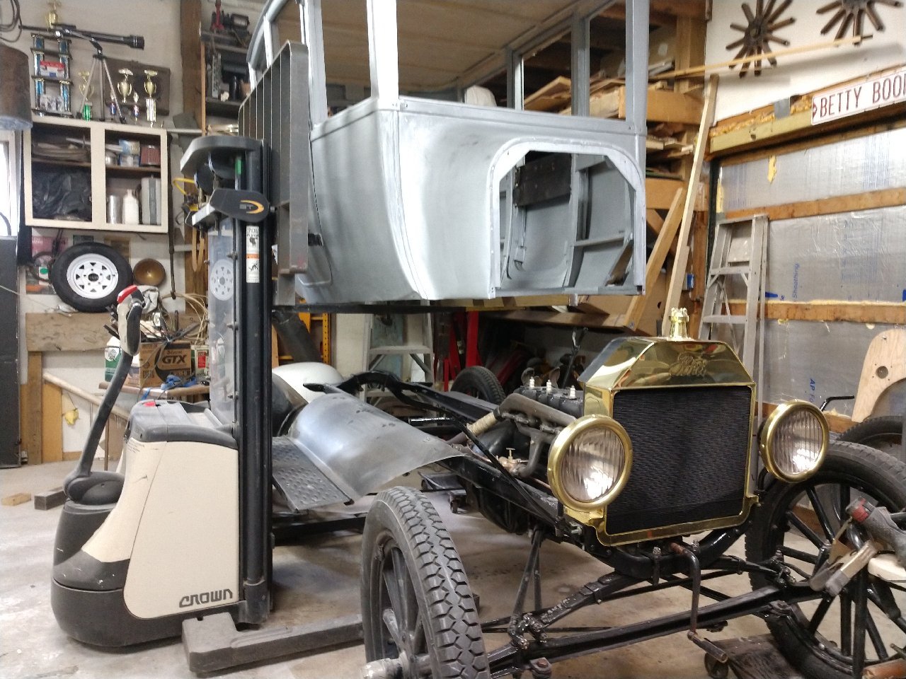

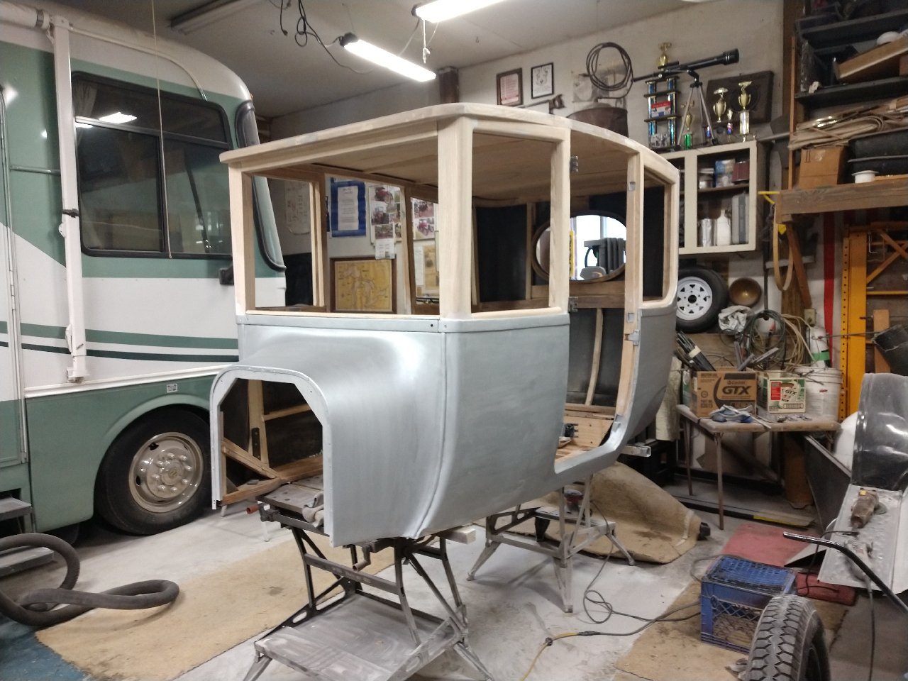

Stage 1 of the body work is done. Now on to the fine tuning and weeks of sanding.

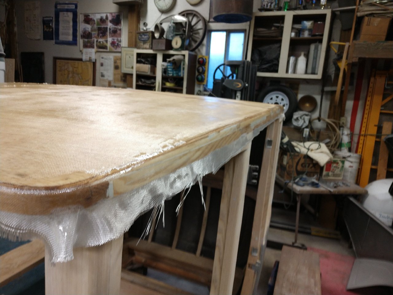

Post by FordorGalore » Wed Feb 19, 2020 4:09 pm

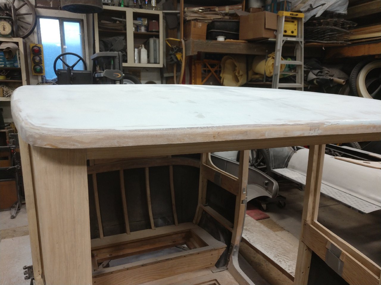

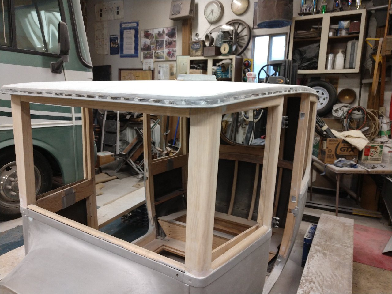

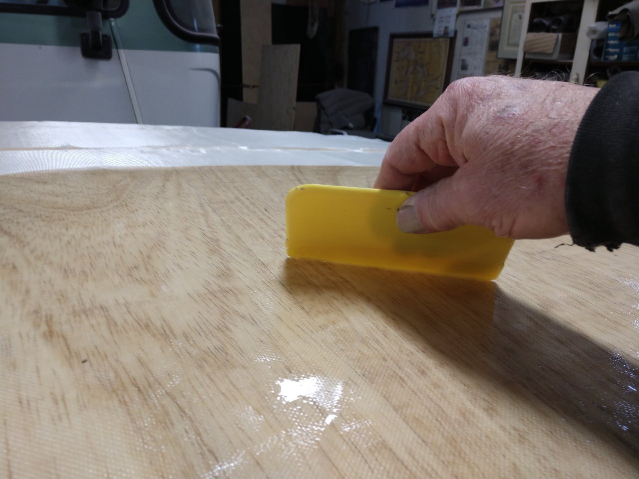

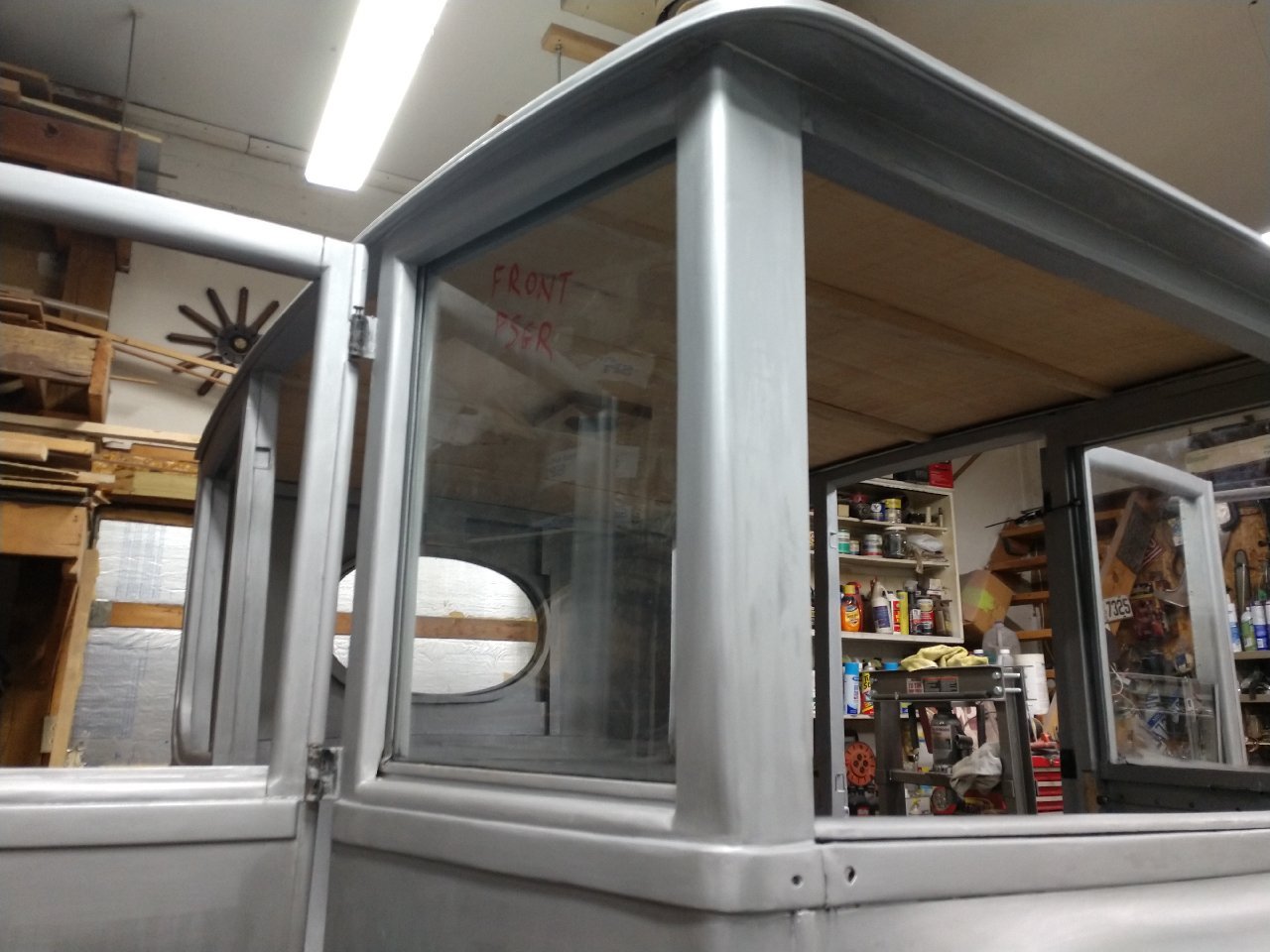

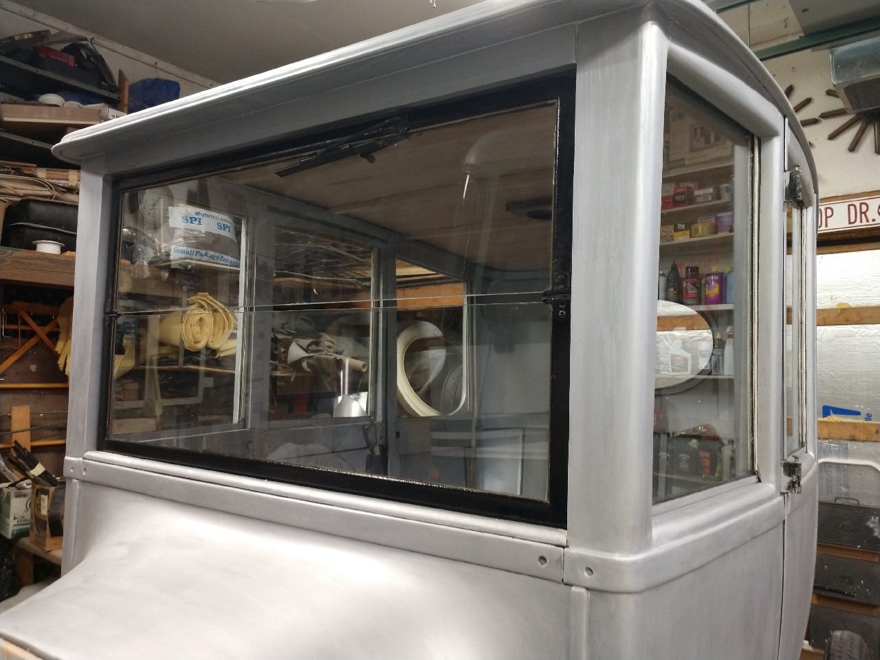

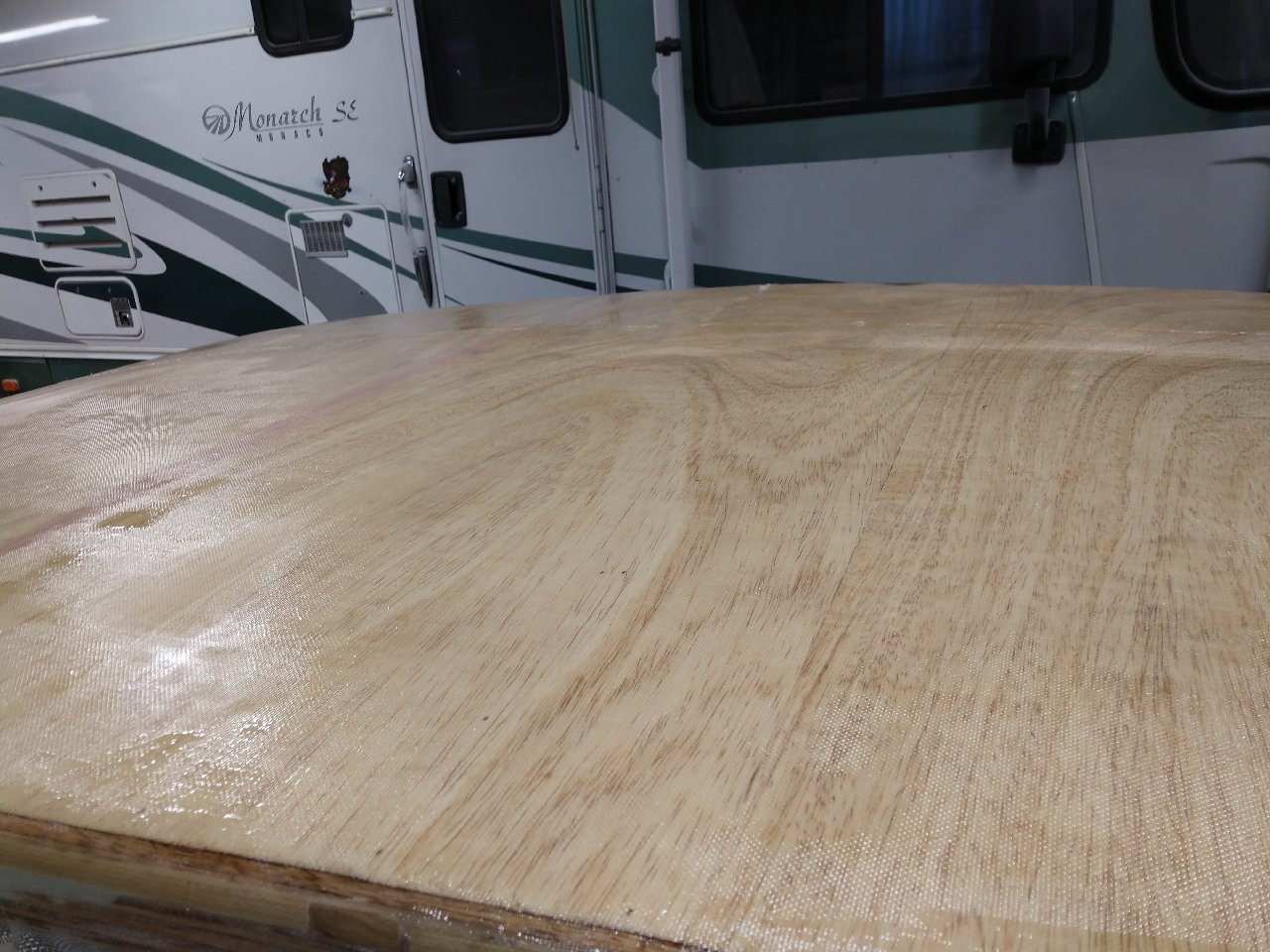

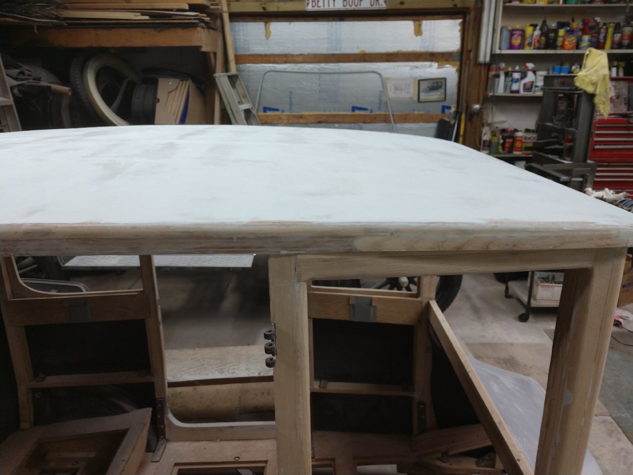

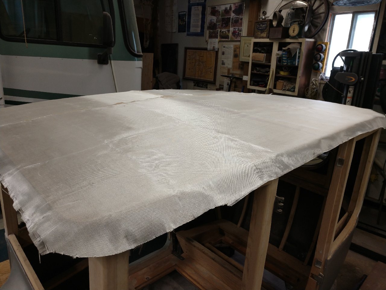

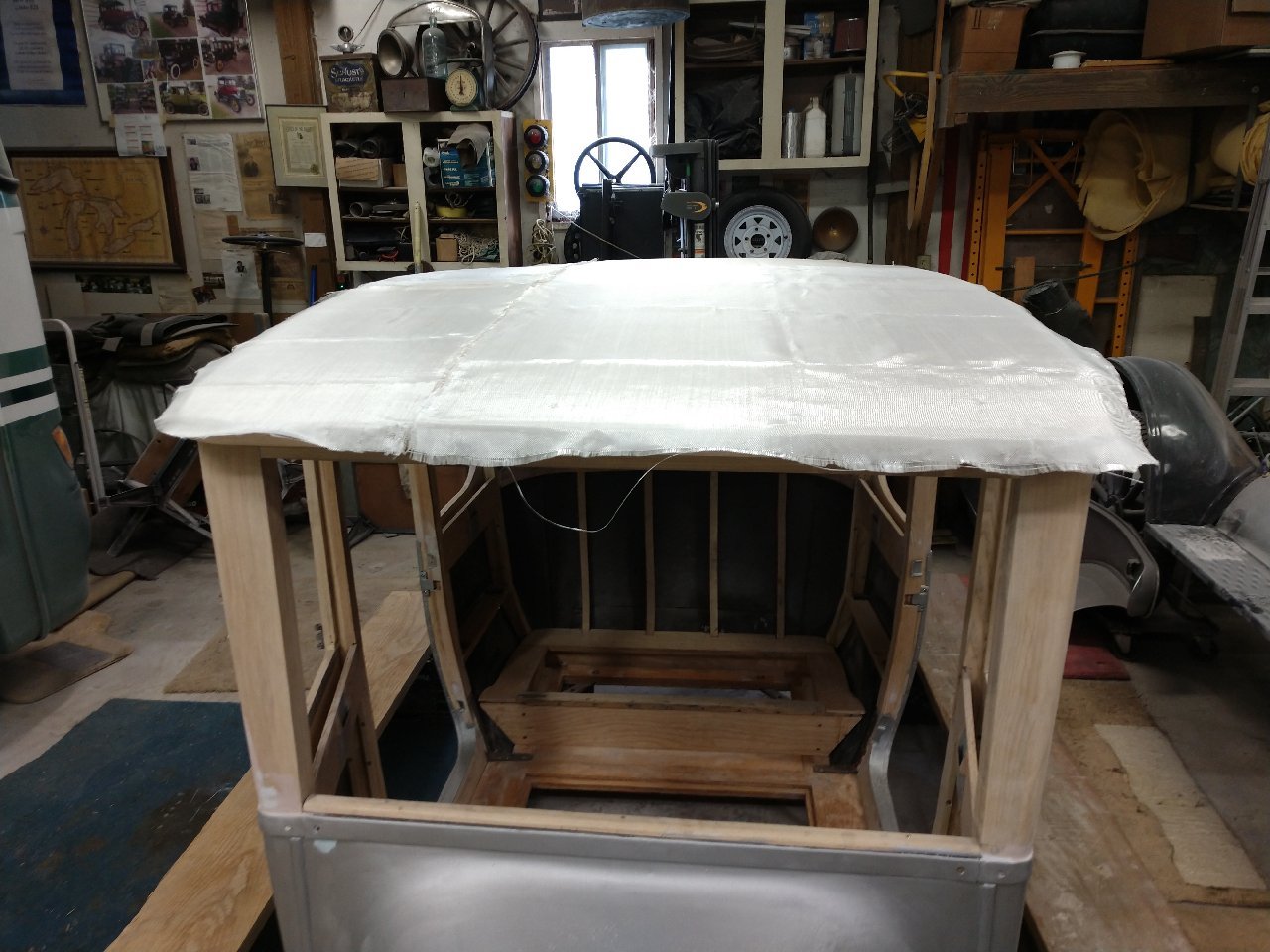

Decided to get the top sealed today. West Epoxy and fiberglass matting should last many many decades.

Don,
What happens next to the top? Is it just painted to match the car or do you add the long grain cobra product on top of your fiberglass?
FordorGalore
Posts: 430
Joined: Fri May 03, 2019 8:20 am
First Name: fore
Last Name: door
* REQUIRED* Type and Year of Model Ts owned: 1922 centerdoor 1927 fordor 1916 centerdoor
Location: Nowhere Michigan
Re: '16 Centerdoor restore...
Post by FordorGalore » Wed Feb 19, 2020 8:26 pm
The top will be sanded and painted. However, I know the later centerdoors had a 5 or 6 inch border of leatherette that encircled the top. It gave the appearance of the top being covered but it actually wasn't. I don't know if the 15-16 Centerdoors had that or not. If you look at the picture of the all the Centerdoors at the factory, I don't see any evidence of that leatherette border. I will have to wait and see what the experts think. Jus part of the fun Denny...
Well, I wasn't going to post this. Some folks get emotional when they see how I do things. "Henry didn't do that!!" and they are absolutely correct. But i'm not Henry and I tend to build these cars using marine materials and methods. For instance this top is a "floating top" design. My thinking is it needs to flex and absorb shock yet be structurally sound. It also needs to be light weight so the car isn't as top heavy. It also has to be tied to the metal which means two materials that expand and contract at different rates need to get along. This is my way of doing that.

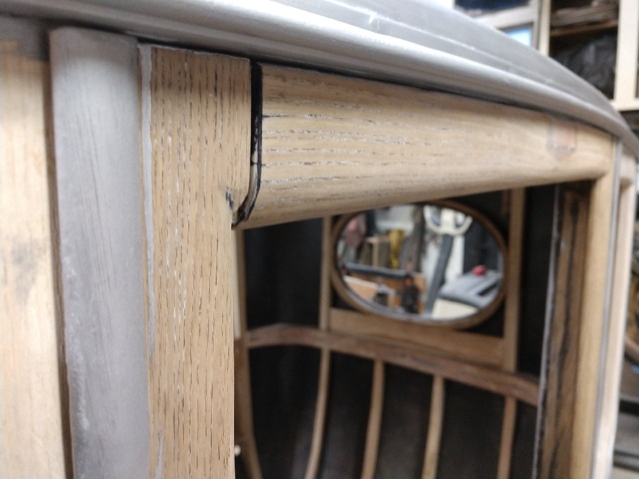

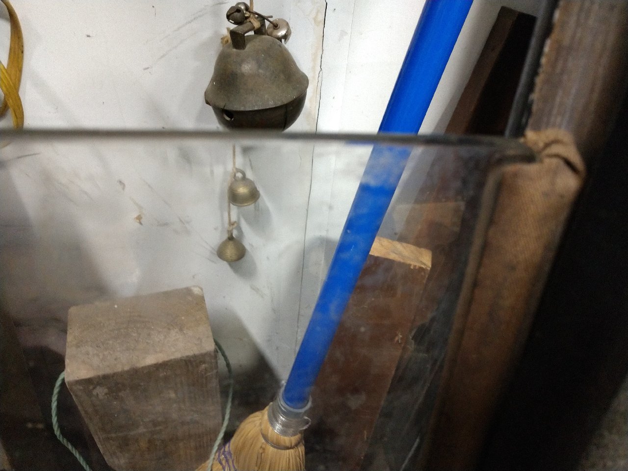

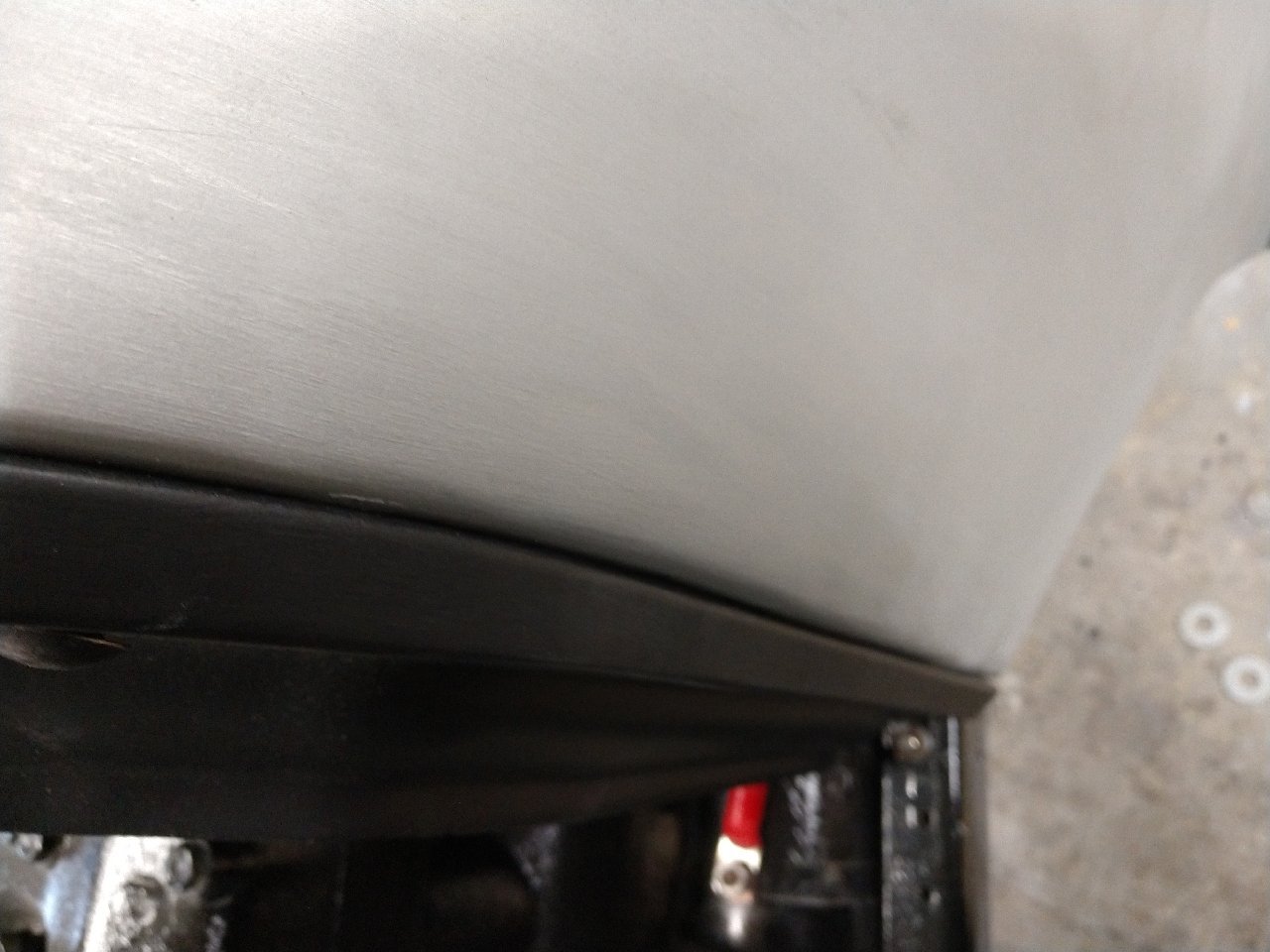

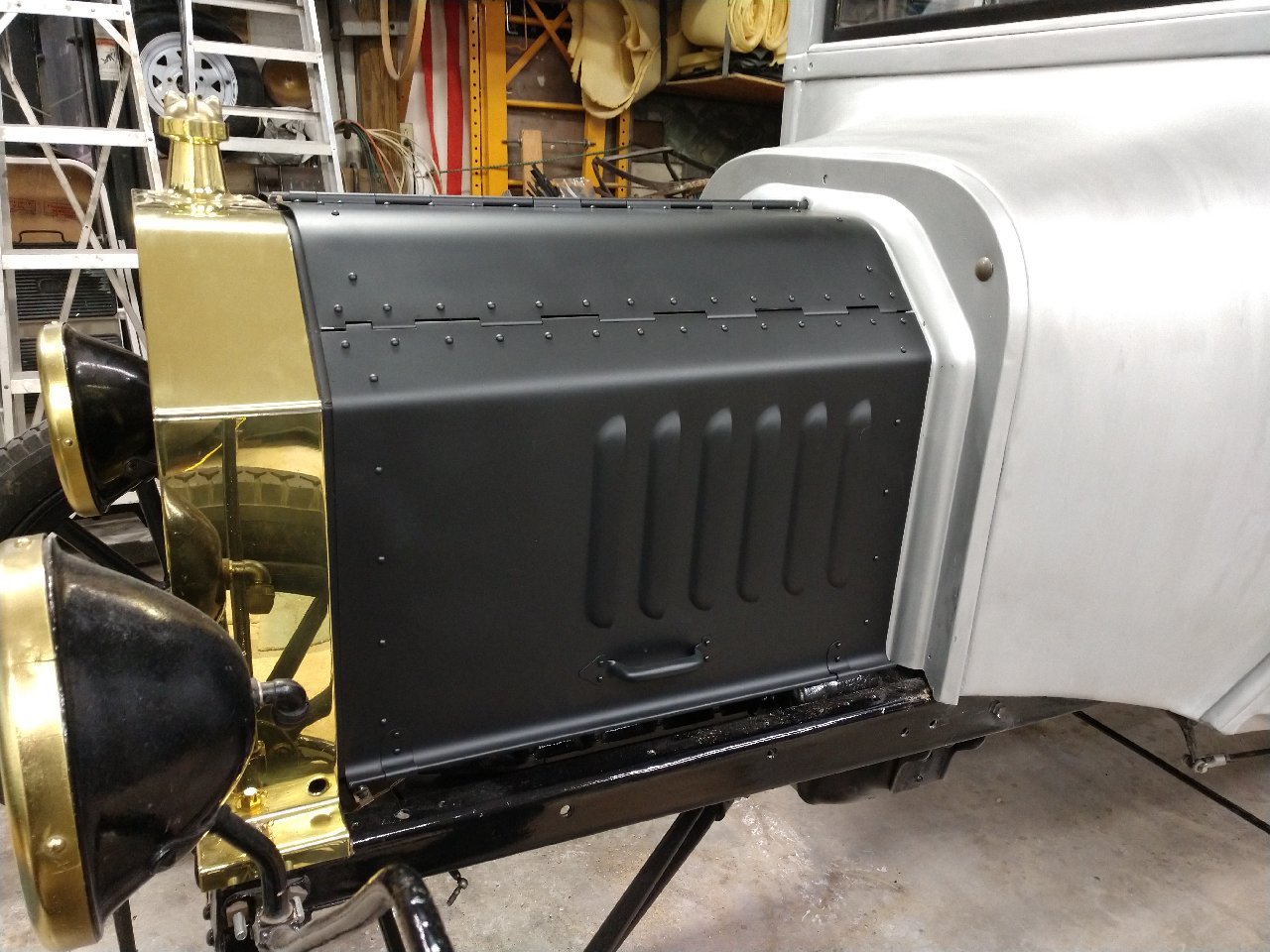

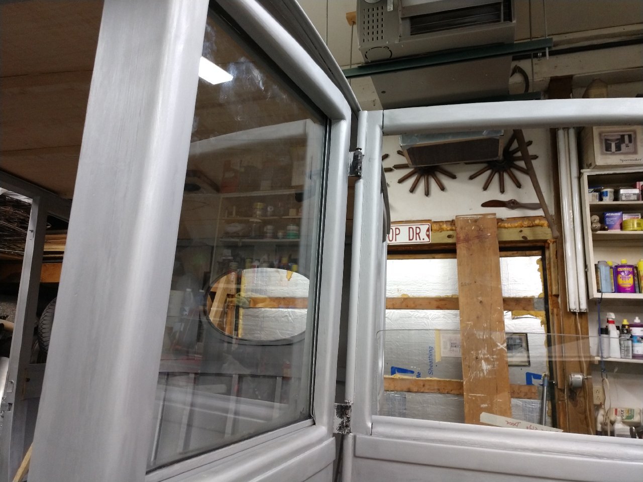

Post by FordorGalore » Fri Feb 28, 2020 2:28 pm

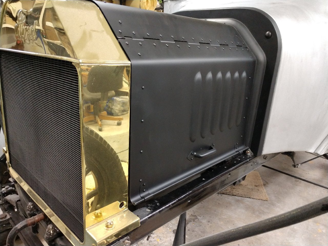

Tight is right but this is ridiculous !! Time to get the file out ….

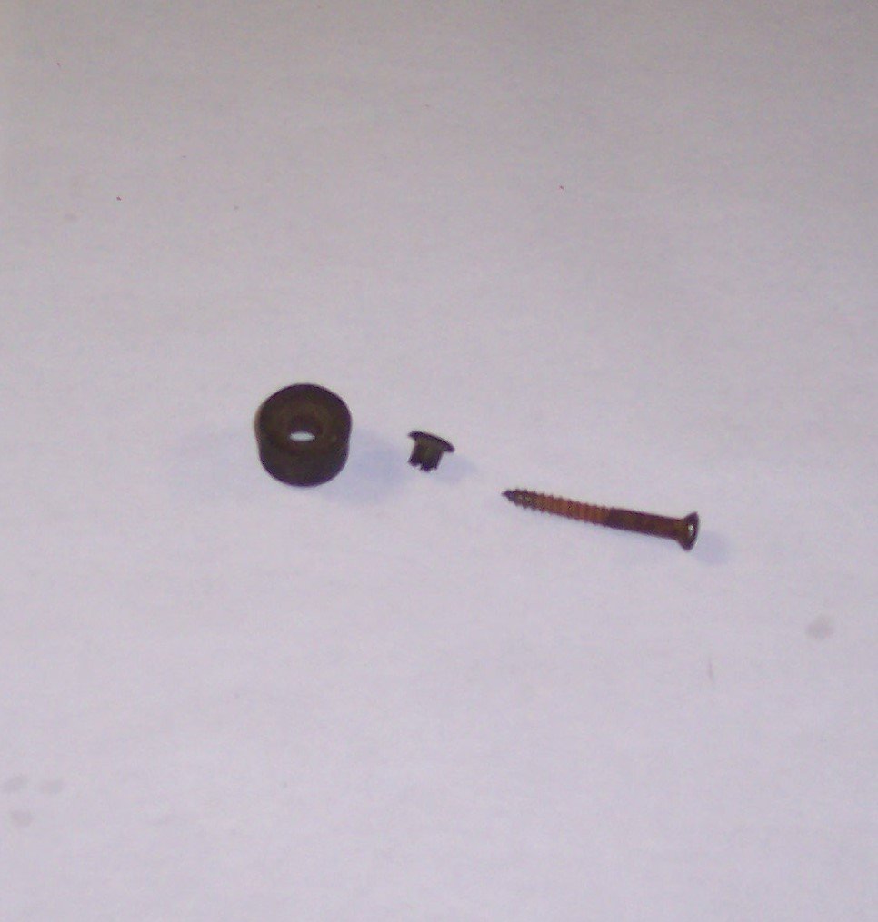

On the horn button combo,I was under the impression that this was not used until late 17 . My un restored 17 still has the separate button on the top of the steering column and the lite switch button on the firewall.
FordorGalore
Posts: 430
First Name: fore
Last Name: door
Post by FordorGalore » Fri Feb 28, 2020 7:45 pm

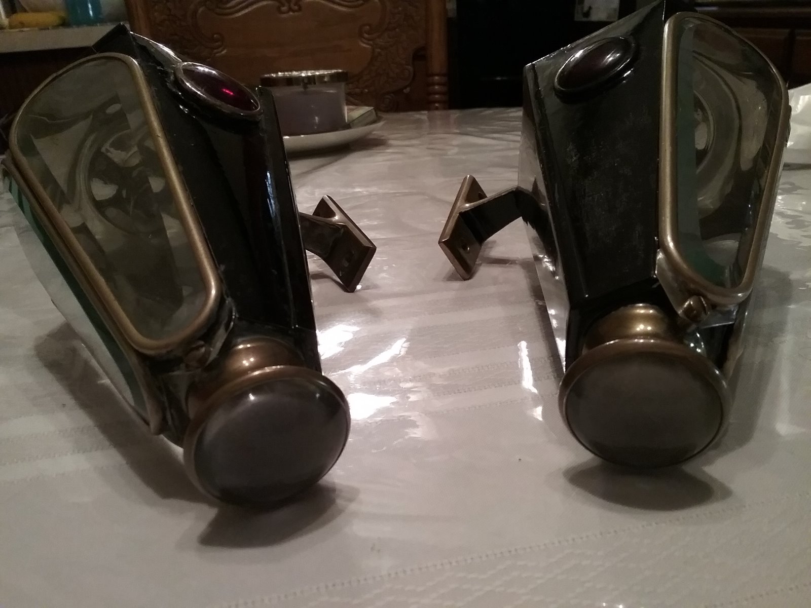

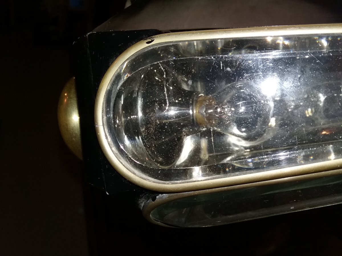

Jim, Mike Husted had me check the horn button out for a 15-16. It does have 4 connections on it and the button has the rib style knobs on the outside edge. He explained that by turning the horn button the low beams come on. The light switch on the firewall is pulled out for high beams. NOW, I may have that backwards as high or low beams on the horn button. Mike called twice today and the amount of information is just amazing, that guy is as sharp as a tack. We also discussed the wiring for the carriage lamps. The mag only system was plagued with many problems as far as the light system goes. I wish my history teachers would have been 1/10th as knowledgeable as Mike is. I just love listening to the guy, its FUN !!
FordorGalore
Posts: 430
First Name: fore
Last Name: door
Post by FordorGalore » Fri Feb 28, 2020 8:36 pm

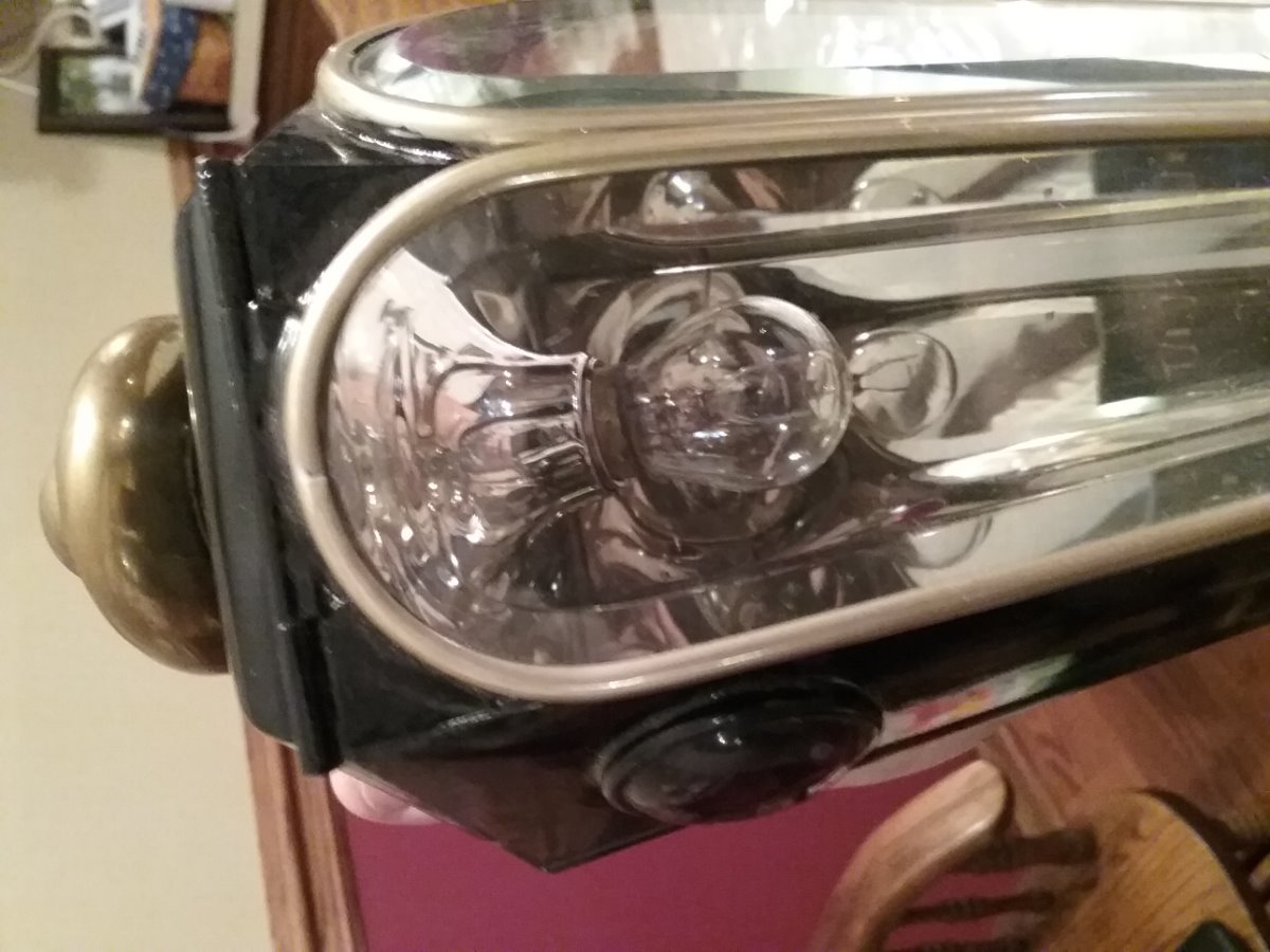

I should have added that this has two bulb sockets on the passenger side headlight and one socket on the driver side headlight. I should also admit I haven't gotten close to really figuring out any electrical on this thing. So don't hold me too it Jim. Maybe Mike Husted could chine in on the subject.

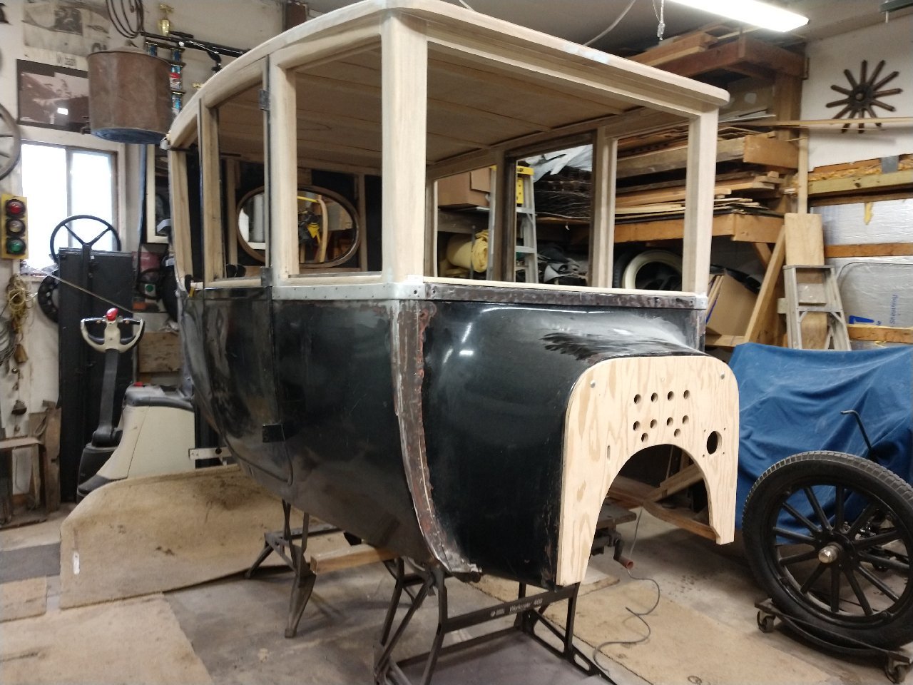

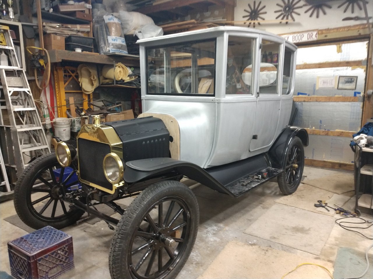

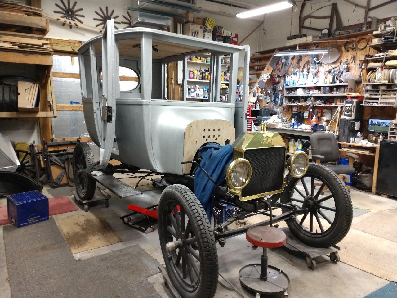

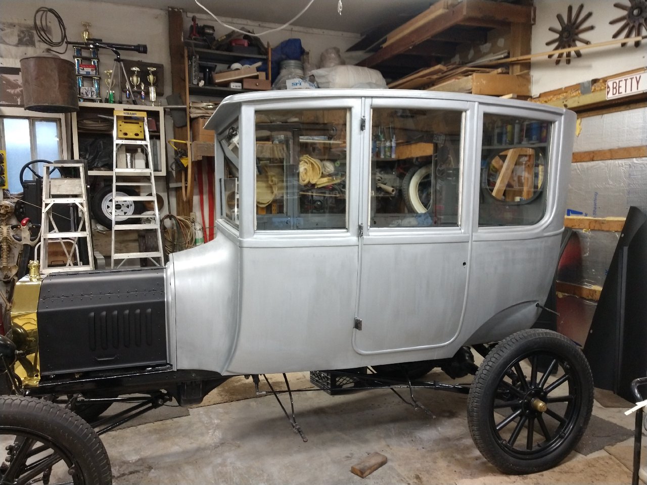

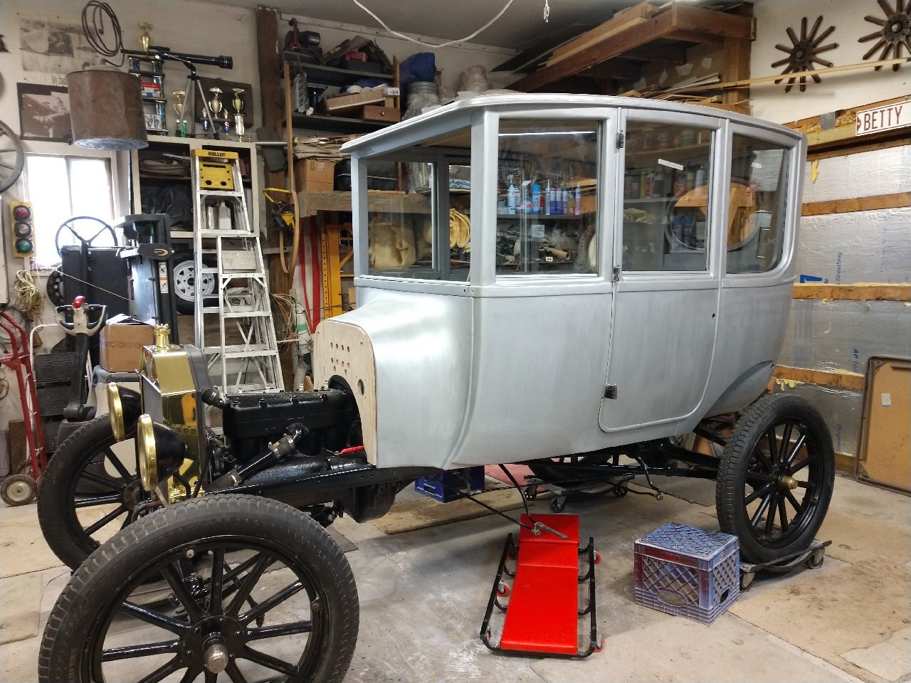

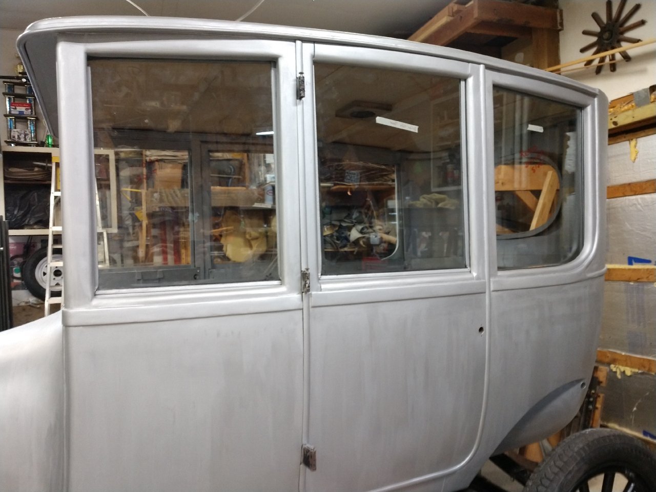

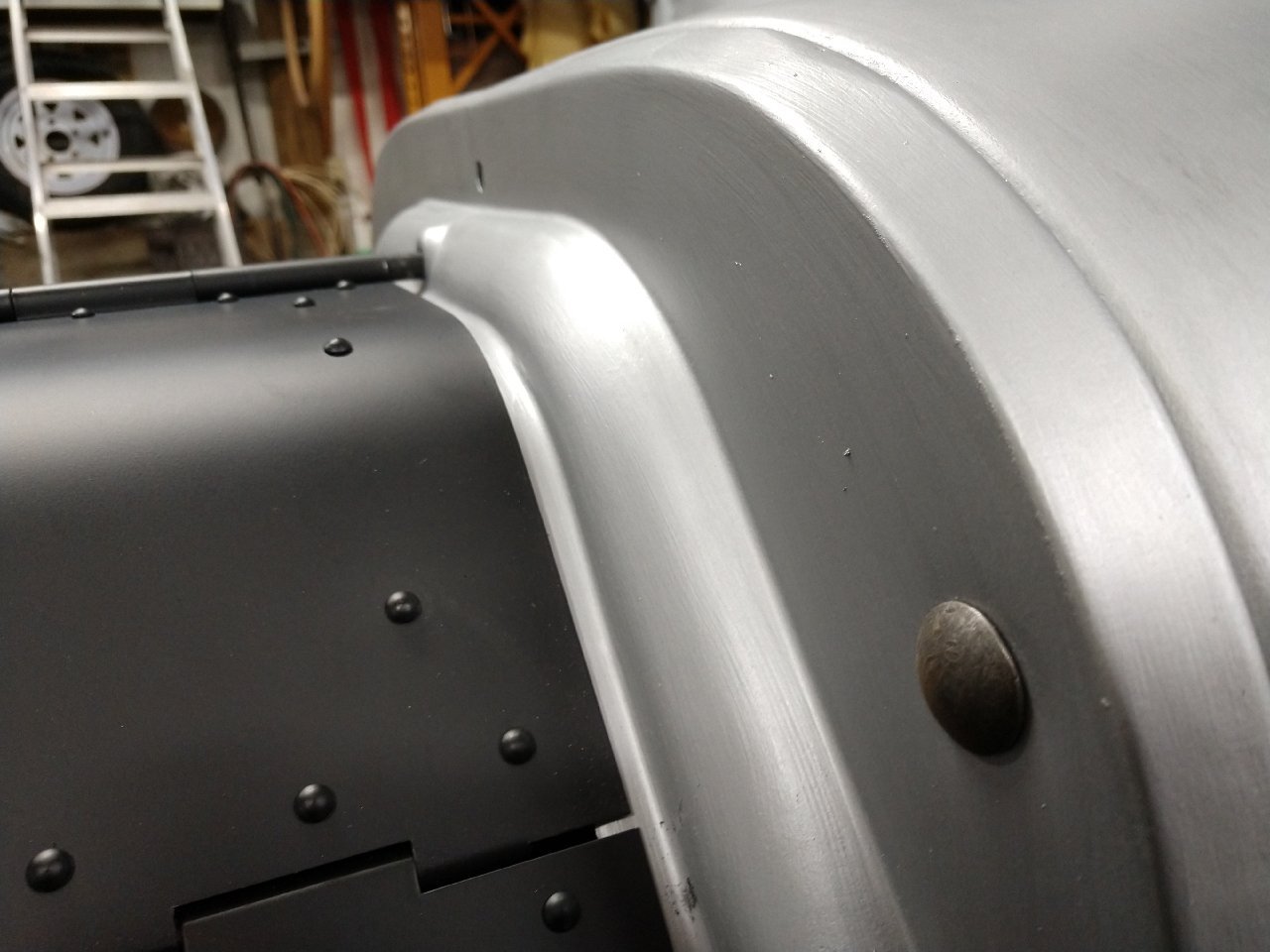

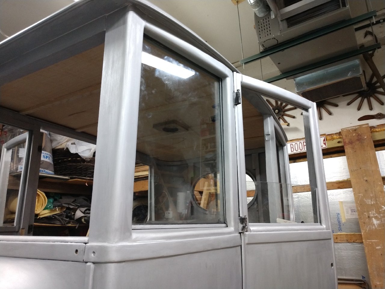

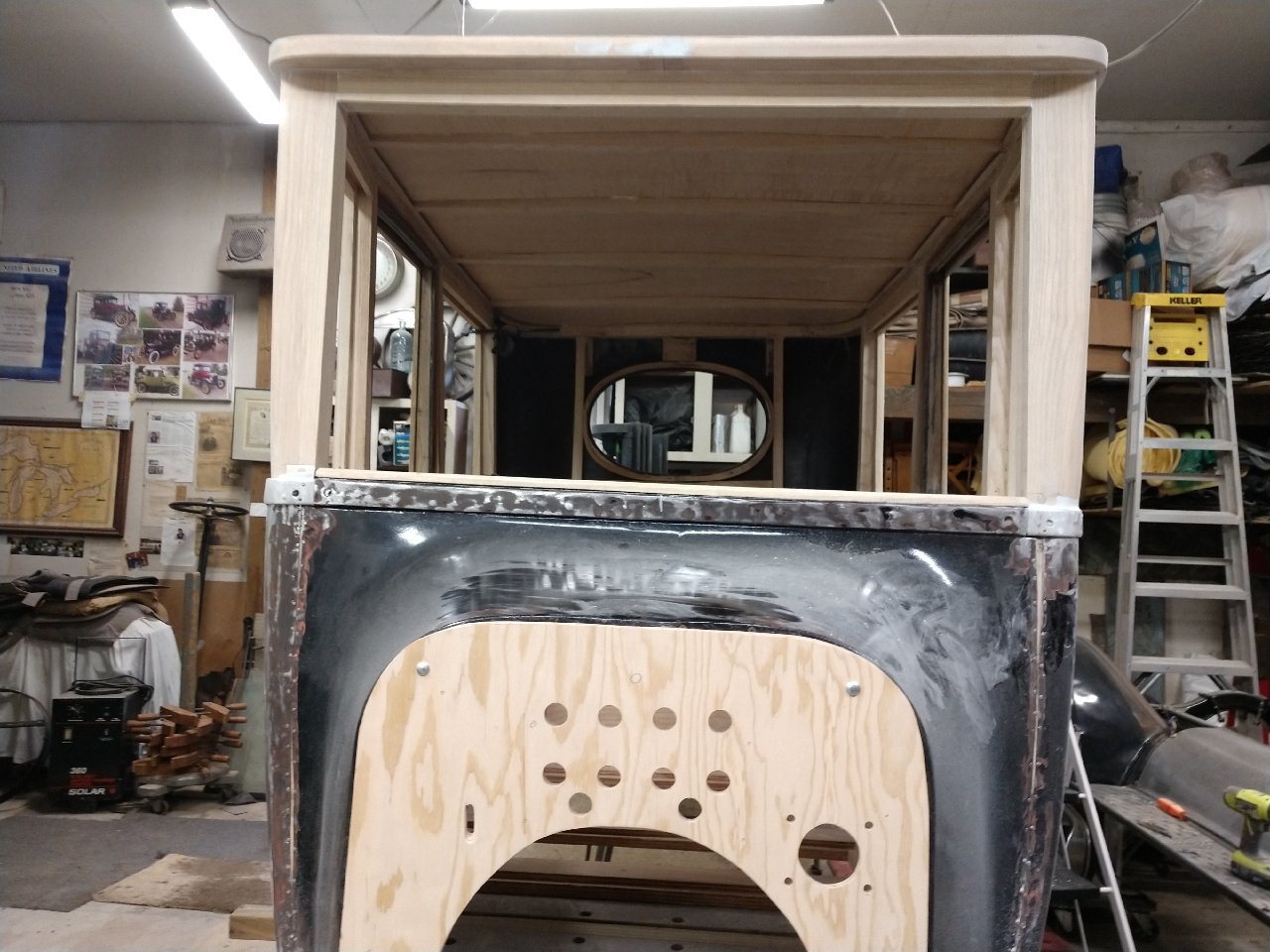

Post by FordorGalore » Sun Mar 01, 2020 3:27 pm

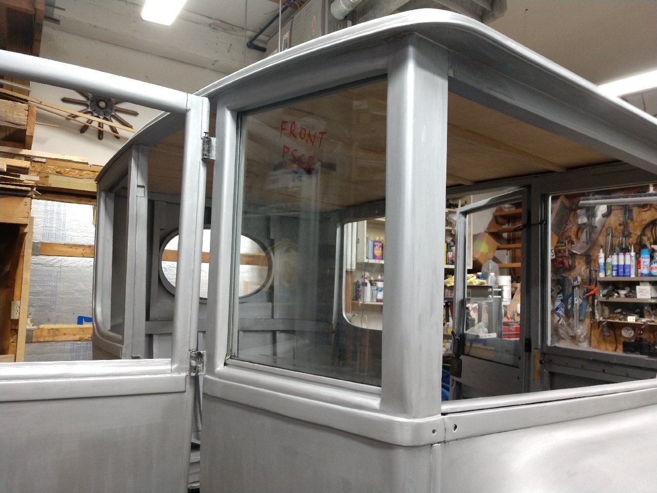

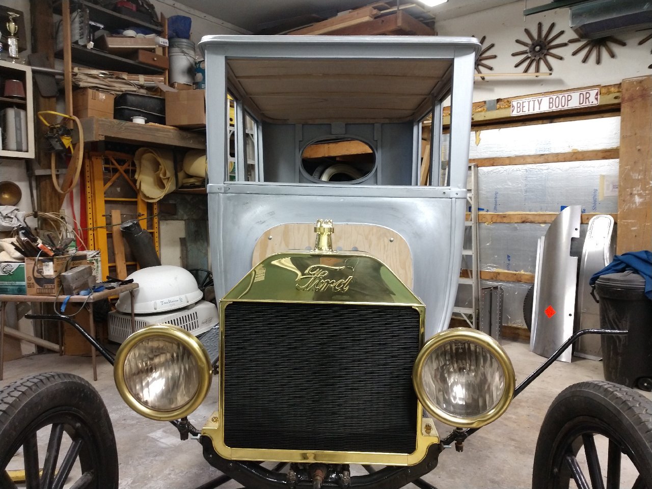

Decided its time to try her new dress. See what needs to be nipped and tucked. Honestly its sitting better than I imagined. What a relief, I tend to stare until I see double. Now I can actually know what all this work may produce.

Post by Dallas Landers » Sun Mar 01, 2020 3:49 pm
Oh Ya! You are moving fast! What a great look. The centerdoor is my favorite body.

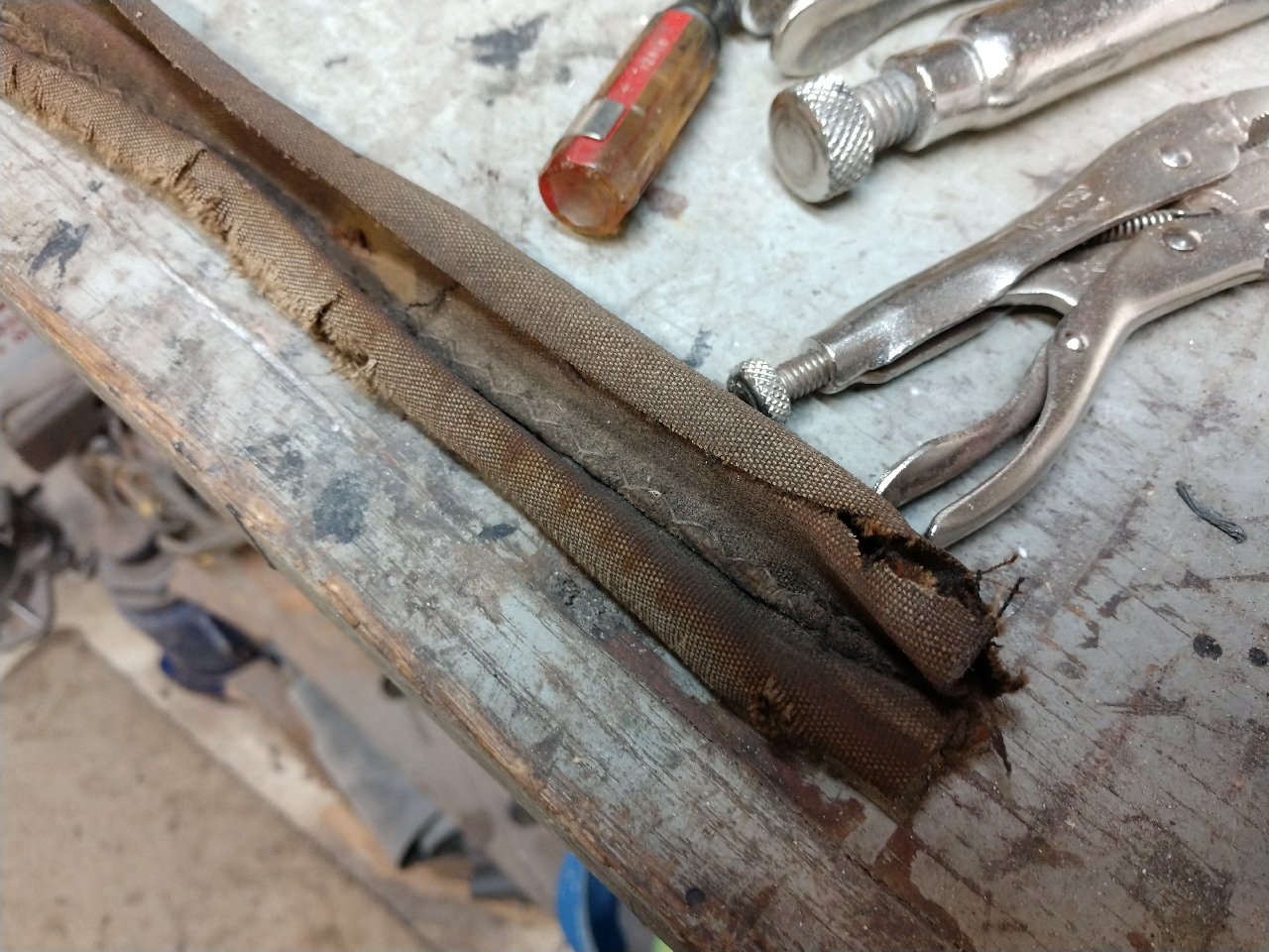

She is looking GREAT. I'll say it again: You're doing an outstanding job and we all appreciate it.

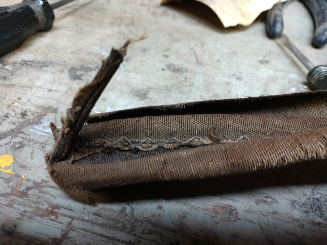

Did you have the original rain gutter or did you have to replace it? I don't have the gutter for ours and have been wondering about options.
Thanks,

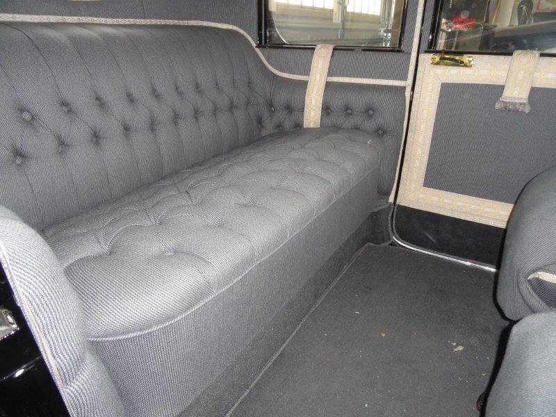

Post by FordorGalore » Mon Mar 02, 2020 6:36 am

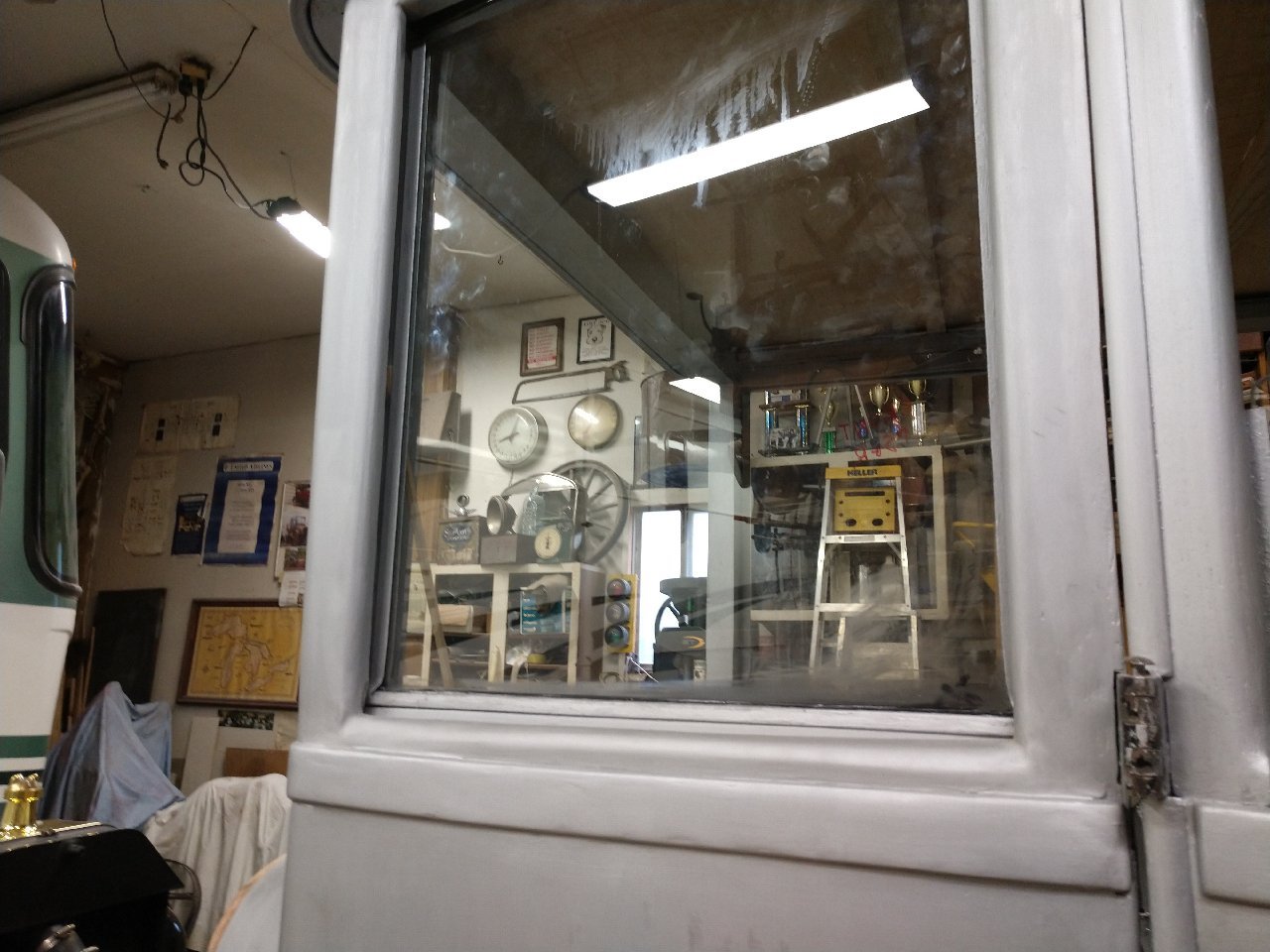

Here are some pictures that my friend sent me on FaceBook. He owns an original 1915 Centerdoor and its a beauty !! Thank you Chris !!

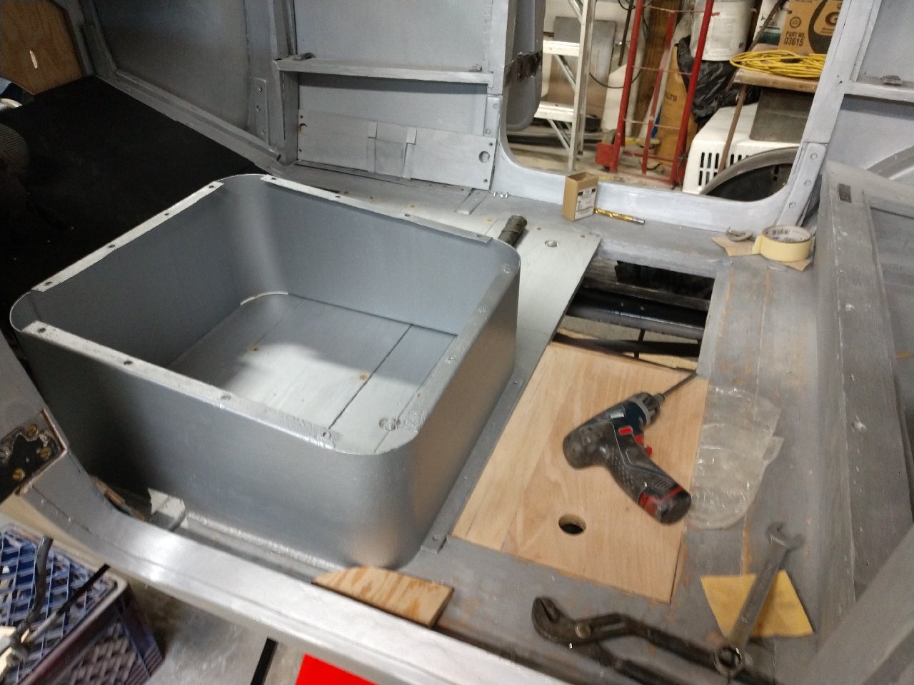

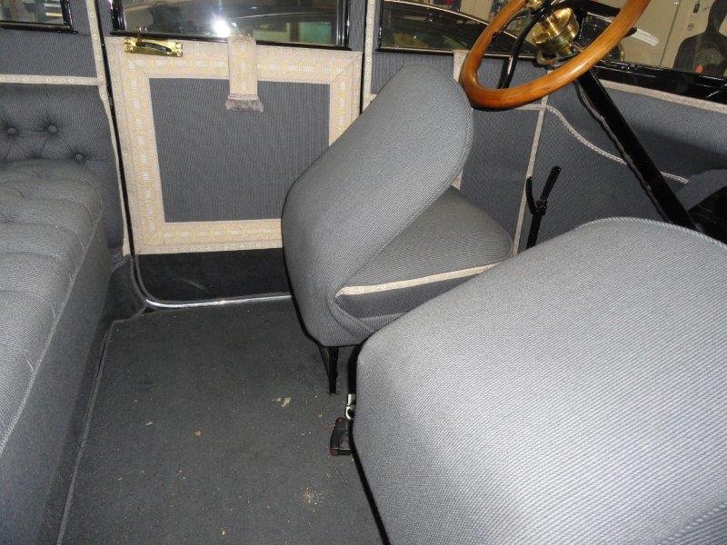

Post by FordorGalore » Mon Mar 09, 2020 2:46 pm
After many hours of grunts, groans, cuss words and moans.....the floorboards are in.

Post by FordorGalore » Fri Mar 13, 2020 11:08 am
HEY !! It's "Floorboard Friday" !! This makes TWO "Floorboard Friday's"..... errrruugg ~~

There's a side light on Ebay right now similar to the really nice ones you acquired. Advertised as "1915 centerdoor" light. It's up to a $3.25 bid! If the beveled glass is the same it might not be bad to have on hand in case of an accidental breakage.
FordorGalore
Posts: 430
First Name: fore
Last Name: door
Post by FordorGalore » Fri Mar 13, 2020 8:38 pm
Thanks Dave, I've been watching that one. It looks to be a bit different in shape. Also the mount is different. If the bids make it possible I may just pick it up and see if it works for parts. Thank you !! :)

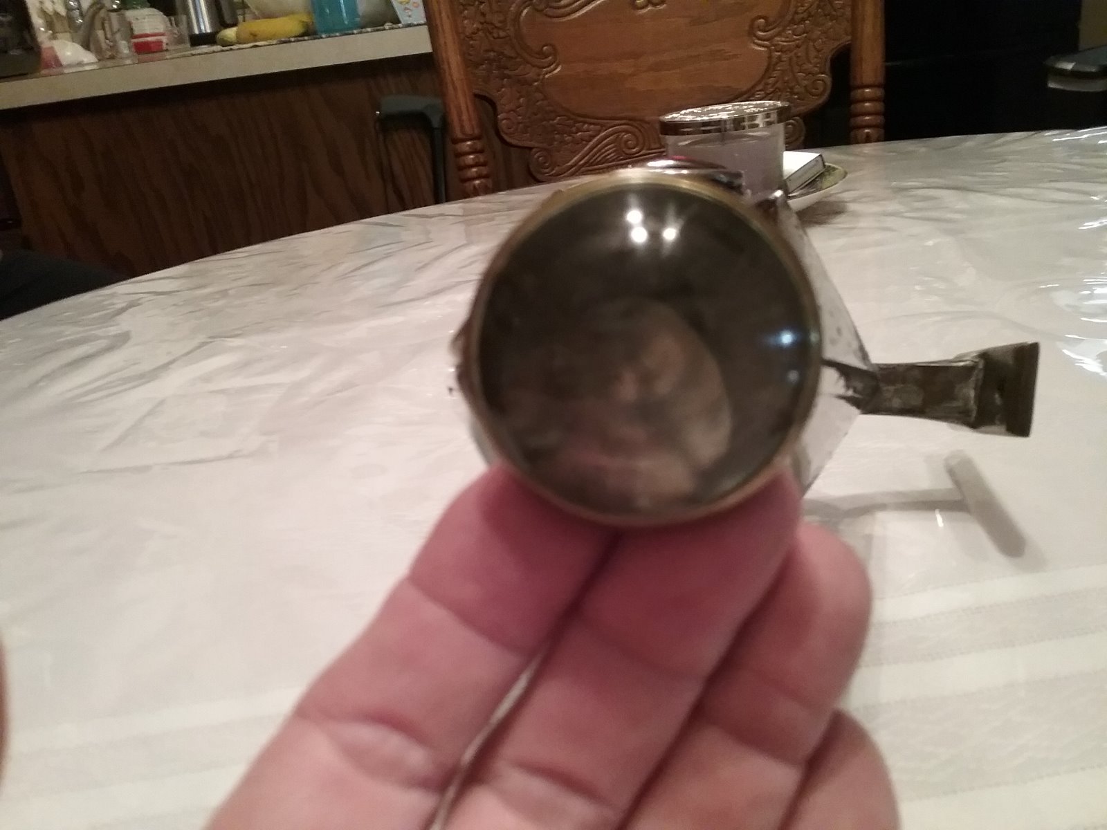

I have never seen these lamps before and have never seen a picture of a centre door with them ,are the factory or an accessory . I think bob showed one on here to, just wondering. cheers Colin

Colon, they were a dealer add-on to attract buyers.

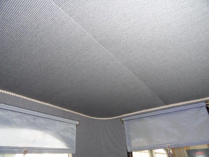

Post by Colin Mavins » Tue Mar 17, 2020 4:24 pm

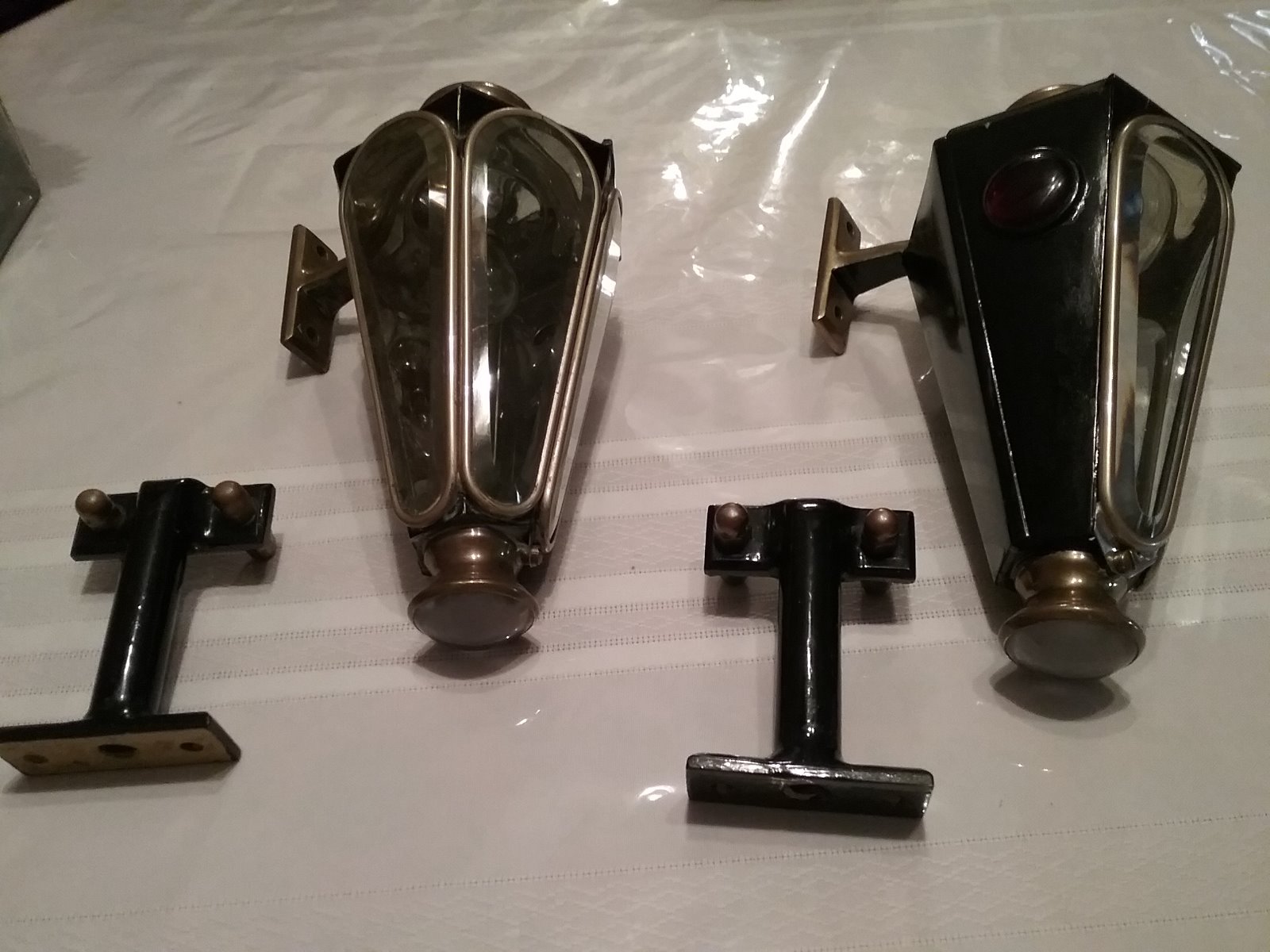

I found this little book while cleaning out more of Dads stuff and it turns out I have a pic of the centre door lights
FordorGalore
Posts: 430
First Name: fore
Last Name: door
Post by FordorGalore » Tue Mar 17, 2020 4:31 pm
Colon, that's a neat picture ! I see those lights have a different mounting bracket but it is a artist rendition of the '15. Thanks for posting ! :) :)

So, I am missing 8 window rollers. I had to come up with something the correct size and couldn't find a thing. I ended up making them out of 1/4" copper tubing and gas hose. I used a flaring tool and flattened the ends up a bit to tighten the rubber up. Seems to have worked out ok. What do you think?

Post by Lessumner » Wed Mar 18, 2020 1:02 pm
Looks fine to me. Les
Posts: 4404
Post by Wayne Sheldon » Wed Mar 18, 2020 5:34 pm
The side windows was one of the several things REALLY messed up on my car when I got it. I did say it was a bad '50s restoration. All the side windows had been replaced with clear plastic sheeting! Cut to fit-NOT. The curves on the top were off by half an inch. Edges were rough. Common '50s car window channeling with the metal edges (supposed to be hidden in a tight fitting modern door) were exposed. The channeling flopped around. Some sort of home made lift straps were screwed onto the bottom of the windows through holes drilled in the plastic. Except for the steel pieces attached to the outer-bottom of the wooden window frames, NONE of the original hardware, like the special steel channels the bottom of the glass was supposed to be set in, was there.
I think the previous restorer was so afraid of that "glass cage" that he simply eliminated it with "nice safe plastic".
But, fortunately, the pieces attached at the bottom of the wooden frames being there, helped as a guide for what I needed. I looked at a couple good c-d sedans, talked with people that had restored them. Nobody had any spare pieces, not even a loose window for me to look at. But it seemed simple enough. I could see enough of the curved lip on the outside of that lower glass channel for me to make a reasonable copy. So I made six "S" shaped channels, added an attaching piece below it, and had a glass shop make glass from cardboard patterns I had fit into the window frames. I made my own foam and Naugahyde soft channels and glued them to the sides of the windows. (Anybody not familiar with the center-door about now is going "WHaa---".) It actually took quite a bit of trial and error to get those soft channels to look, fit, and work near properly. When I did the upholstery, I made straps out of the same material, put in eyelets and screws where old holes indicated they belonged.
When I was done, the windows lifted and slid down easily, didn't rattle much when driving, hooked onto the lower window frame nicely to stay up, and hung nicely on the straps at appropriate levels. And they looked wonderful and clear, just like they were supposed to.
So I guess your rollers look great! But how would I know? My car didn't have them! (But maybe it was supposed to?)

What holds your windows up? I have a '22 Coupe and the two rear side window have rollers on them too but the rollers were mounted to a tension spring that pushed the rubber roller against the glass. The pull strap doesn't hold the window in place and I'm having a tough time keeping spring tension on the glass to hold it in place. Did your's have a spring?

Post by FordorGalore » Wed Mar 18, 2020 6:25 pm
Yes Wayne just yesterday I got all the safety glass back from the glass shop. This morning I went out to find one was cracked and ran that back to the glass cutter. But I've been racking my brain trying to figure out how the heck will I duplicate these window frames? I bought some #10 canvas and I have all but three pieces of the felt stuffing (it takes 12). When I took the old worn out weather stripping apart it didn't appear to be glued to the steel window frame. The only thing holding it in place was the canvas was packed into the top of the window frame and also at the bottom just above the bottom steel frame. So, what to do? I may have to get some good glue and try to apply the canvas to the steel frame. Any help on this would be wonderful...

Post by FordorGalore » Wed Mar 18, 2020 6:34 pm
Dennis, the windows pull up past a metal plate and then you push them slightly outward and let the window down. The bottom of the window frame has a channel that slides down over the metal plate and holds the window up. I will take some pictures of it tomorrow and post them. So to open the window you lift it up and pull it in slightly and the window slides down. These windows are either full open or full closed, no in between.

Post by Lessumner » Thu Mar 19, 2020 8:09 am
Don, On my window frames , The canvas materiel wraps around the felt pad and glues into the window frame making the seal and pad for the glass.The glass actually holds the pad and canvas in place.The ends are tucked in before the glass is slid into place. When you disassemble your window frames, you will see the process. Instead of canvas, I used convertible top canvas. It is ruberized on the inside and is very tough on the outside and so far 20 years has not faded it. I think it is called Harrtz cloth. I used glass setting tape in the metal frame at the bottom of the glass.
Your rollers look spot on. They guide the window frame up and down smooth

Post by FordorGalore » Thu Mar 19, 2020 9:10 am

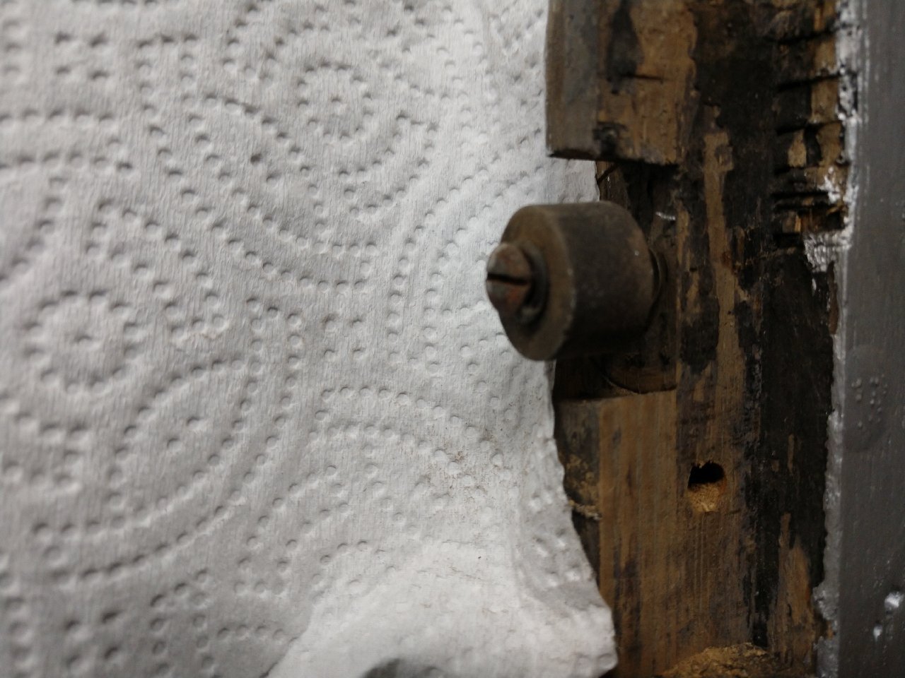

Les thanks, I think that's how I will try to do these. When I took off the weather stripping it was one piece. The underside was sewn down the middle. That's what is confusing me. If the canvas was tucked into the frame then how could it be one piece? I wish I had taken some pictures of the weather stripping after I had removed it but, I didn't and it was tossed.

Post by FordorGalore » Thu Mar 19, 2020 9:57 am
Ok, I did save a piece of the weather stripping. Note that this is cut full length so I could save the felt padding. Also note that the picture shows just how much material was stuffed into the metal frame from the top. Talk to me....

Post by FordorGalore » Fri Mar 20, 2020 4:31 pm
I'm working on the window fitment now. I had to fab the window stays but it seems to be coming along ok. Some tweaking here and there and that's expected. Keep in mind I have to build this thing before I get into the final finish work.
FordorGalore
Posts: 430
First Name: fore
Last Name: door
Post by FordorGalore » Fri Mar 20, 2020 4:32 pm
a few more pic's...

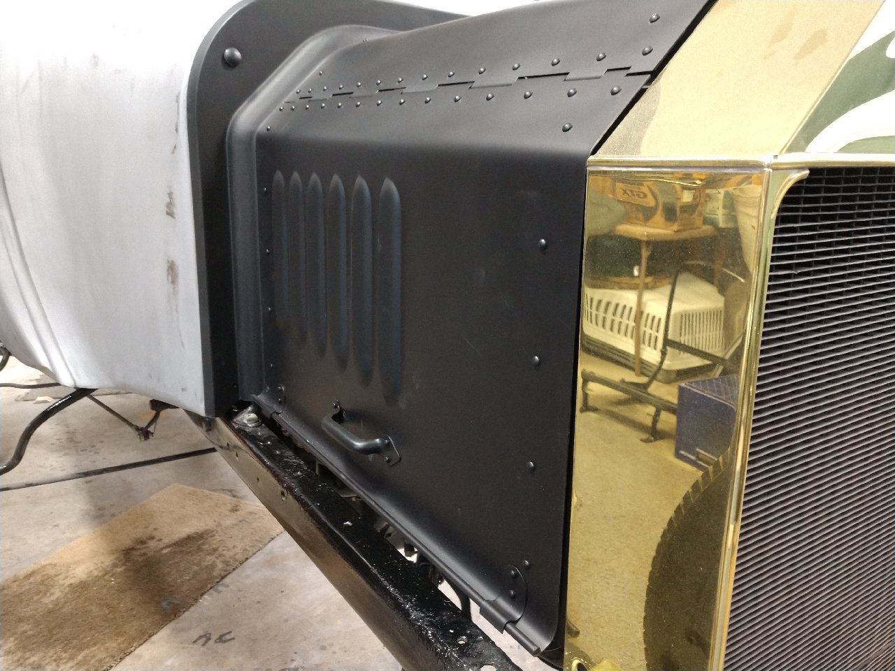

I found a picture of a 1912 Model t with a full louvered hood as in the picture of the 15 centre door
FordorGalore
Posts: 430
First Name: fore
Last Name: door
Post by FordorGalore » Sat Mar 21, 2020 3:35 pm
Interesting Colin. Well not much of a quarantine effect on this project. Got all the windows in, which is a relief considering having no patterns for the wood.
Posts: 4404
Post by Wayne Sheldon » Sat Mar 21, 2020 6:07 pm

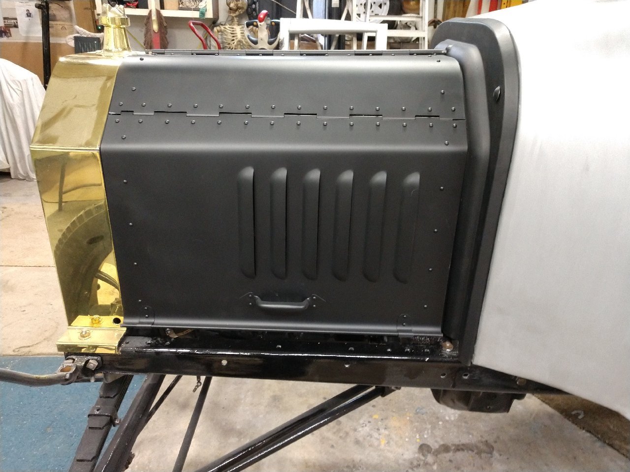

Colin M et al, Louvered hoods were sold as after-market items soon after the '09s hit the streets. In Australia, hoods were stamped with louvers when new and sold that way on new cars. Nobody I think knows for certain the reason why. However, speculation has been that with such a large portion of the country being the Outback, cooling concerns may have played a part.
A funny story. I have a hood just like that one on the pictured '12. I picked it up several years ago for my '15 project. I already had a hood for my '15, but it was in really poor shape. Edges were worn away, most of the small pieces (leather holding channels, hood clip reinforcements) were missing. It was badly deformed, but it was cheap and I figured I could fix it up. When this one came along, it looked so much better. Fairly straight, all the pieces in place. It needed some repair work, but not nearly half as much. And the price was right.
Fast forward a few years, I am finally working on the '15. It almost looks like a car. And I am to the point where it is time to begin to make the hood look nice. I actually grab both of them. Yeah, I definitely want to make nice the better one. However, for the first time, I looked a little closer. There are more louvers than normal '15 hoods have. I still want use it. I begin cleaning it and straightening the minor mis-bends. I am working it on the car with a temporary radiator, but something isn't fitting okay. The side hinges are too long. They sit up on the hood former. Comes the dawn. It is an early hood, with louvers! The early hood former has indentations for the hinge to set into!
The really bad '15 hood? Looks pretty nice now.

Recently picked up some neat Floyd Clymer publications I didn’t have for my collection. They were purchased from Ralph Fitz-Gerald on this site. This is a neat cover of Floyd’s model T #1, showing the sedan. Those side lights are just off the wall neat, and I’d say worth building a car around. They couldn’t have gone to a more worthy project or craftsman! It blows my mind Henry would offer something like that, but having seen the quality first hand of the early style coupes, they were after an upscale market, however small. Just 5 years earlier they had trouble finding buyers for those plate glass death traps. I cannot wait to see Don’s interior restoration.

Post by FordorGalore » Wed Mar 25, 2020 9:33 am
Cool pictures Tim, do you have any blue prints? LOL !! :D
Trial fitting the windshield, the glass is safety glass put in by someone else. The lines aren't straight, it will have to do for now, just adds to the bliss of hit and miss.

Post by FordorGalore » Sun Mar 29, 2020 8:37 am
Did some epoxy priming and just had to mock the beast up. It's starting to look like something....what? I dunno~

Post by Marty Bufalini » Sun Mar 29, 2020 4:51 pm
Amazing! Simply amazing! The quality and speed and craftsmanship -- amazing!!!
Don, I had better see this at OCF this year -- and I want a ride!!!

Post by FordorGalore » Sun Mar 29, 2020 5:08 pm
Marty, if I can't find a hood former.....it won't happen. :cry:
Posts: 4404
Post by Wayne Sheldon » Sun Mar 29, 2020 9:05 pm
Still no hood former? I thought you got one a few months ago?
I do have one I am not currently using, but may need later. And believe me, you don't really want to fix it up. Most of the metal is there (but not all!), and it is twisted more than a bit!
But if push comes to shove?
Posts: 7259
Post by Allan » Sun Mar 29, 2020 10:00 pm
Don, best of luck finding a good hood former. I bought the one for my 15 tourer at the Spokane swap meet in 1989. It was really nice but didn't fit well. To get the best hood fit I ended up brazing a solid steel piece behind the badly worn hole which locates the hood hinge pin. Then the hood was mounted on the radiator and manipulated to get the best compromise for an acceptable fit. The hole in the former for the centre hinge rod ended up being drilled some 5/16" to one side and 1/4" higher than central. It really wasn't that noticeble once painted and fitted in place.
Hope this helps.

Wayne I called the fella and he "thought" he had one. He was going to check and I haven't heard a word since. The only other one I know of is in Australia and shipping alone would be cost prohibitive. So the search is still on...

Don, I wish I had not missed that you need one. I saw one for sale not long ago listed under the wrong year but don't remember where it was. If I find one will let you know.

Thank you Bob, I may have something lined up. It looks promising at this point. I appreciate your kind thoughts ! Keeping my fingers crossed, my respirator on, washing my hands and staying in the barn !! :D

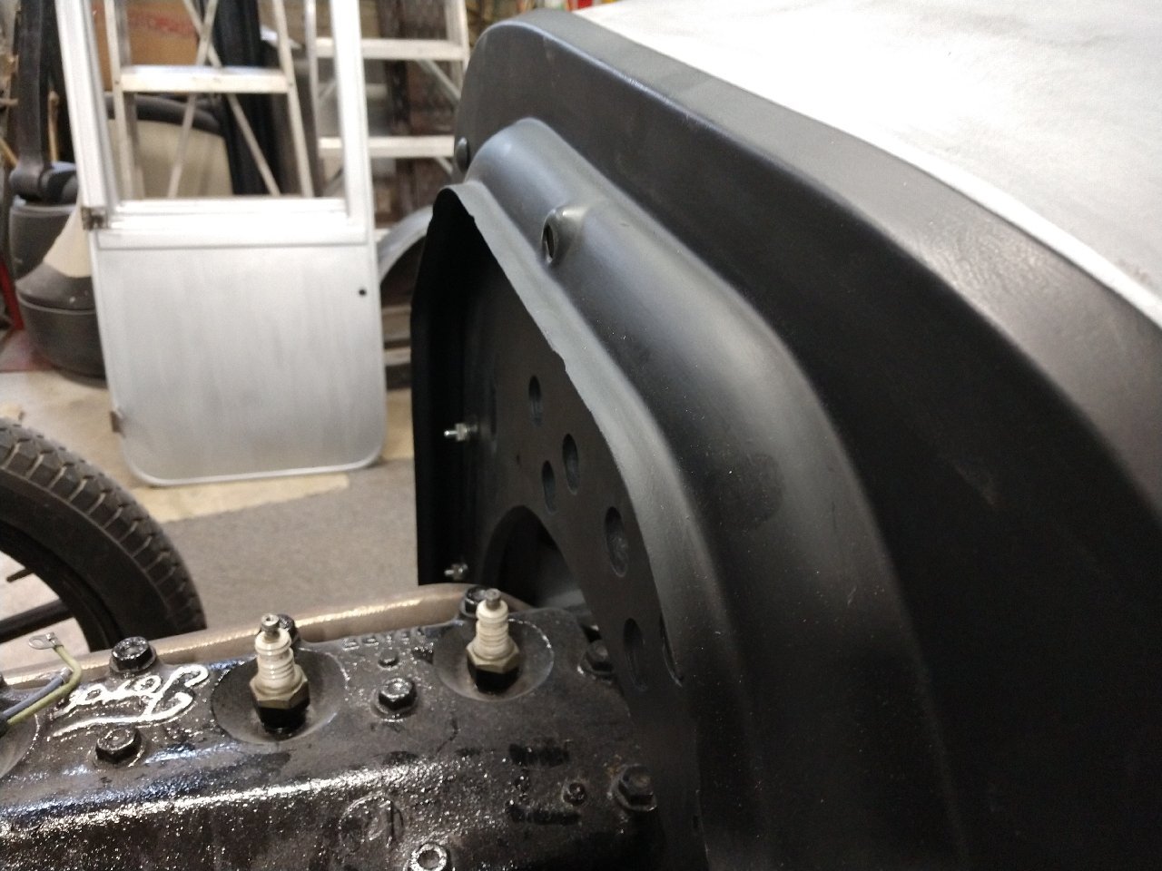

Post by FordorGalore » Sat Apr 04, 2020 3:39 pm
Work'n on its former self, the hood former that is. Special thanks to Steve Meixner for offering up 3 hood formers. Mighty fine deal !!
Bob McDaniel
Posts: 466
First Name: Bob
Last Name: McDaniel
Location: Smithville TN.
Post by Bob McDaniel » Sat Apr 04, 2020 4:16 pm
That looks amazing. Everything looks like it fits like it should.
Posts: 4404
Post by Wayne Sheldon » Sat Apr 04, 2020 4:34 pm
Now THAT is looking really good! Glad to see you finally have a hood former,and a nice one!
And thank you Steve M!
Post by FordorGalore » Sat Apr 04, 2020 5:45 pm
Thank you Bob.
Wayne see that hole in the hood former just above the hood rod hole? Would that be for another firewall bolt?

Posts: 4404
Post by Wayne Sheldon » Sat Apr 04, 2020 6:49 pm
Hey there Don B!
Neither the one on my '15 runabout nor the beat up rusty spare for a future project have that hole on them. And no sign there ever was a hole there. If memory serves, the early '16 center-door sedan I used to have didn't have a hole there either.
So I would guess it was added at some time in its past for some unknown reason. I would recommend a simple repair and nice paint over it.
I sure enjoy looking at the photos of the progress you have made with this car! Simply wonderful.

Post by FordorGalore » Sat Apr 04, 2020 7:07 pm
Thank you Wayne, I hadn't seen a center bolt on the others either. I will take your advice and plug it !! I assume also the firewall brackets have to be installed before I can make the former permanent? Hope you are stay'n home and healthy...

Post by Wayne Sheldon » Sat Apr 04, 2020 8:55 pm
When I was working on the runabout a year or so ago, I had "misplaced" the frame to firewall brackets I had for it. So I wound up putting the firewall and hood former onto the body without the brackets in place. I couldn't afford to buy new brackets at the time and was trying to fit a bunch of things together. Eventually, i found one lone extra, a broken cast brass copy. About a week later, I made both a right and a left bracket using scraps of steel, and about two whole brazing rods (they came out looking really good!). Then I fought them into place, and followed that by fighting the bolts and tightening the nuts (the worst part!).
I suspect that bolting the brackets onto the firewall before sliding the hood former into place would be much easier.
Of course, only a few days after getting all that done, I found the missing brackets while looking for something else.
Oh well. At least I have the brackets for the "future" project. If I live long enough.

Post by FordorGalore » Thu Apr 09, 2020 3:51 pm

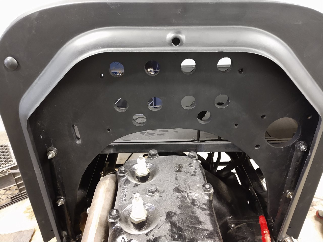

Thanks to Steve Meixner up in the snow banks of northern Minnesota, I received the firewall brackets today. Decided to get right into it. Somewhat of a forced argument that I eventually won !! Sliding the hood former down over the firewall after installing the brackets is definitely the way to go. It squared everything up rather nicely. Kind of a nice way to spend another day of being grounded.... ;)
Post by FordorGalore » Thu Apr 09, 2020 3:53 pm
A couple more pictures...

Post by Wayne Sheldon » Thu Apr 09, 2020 4:25 pm
Looking good! Sounds like it went together nicely. I had to do some tweaking to get the cowl and hood former to line up and fit together. My runabout had been "messed with" rather badly a couple decades before I got it, bad welding, and an apparent attempt to build a "bucket T" which fortunately was going badly enough that whoever quit before totally destroying the salvageable original '15 body. My runabout will never be a show car. But I don't need one of those anyway.
Glad to see yours went together so well!

Post by FordorGalore » Thu Apr 09, 2020 6:22 pm
Wayne you gave me good information !! Sliding the hood former down over the firewall made it a piece of cake. The only problem I had was the rear crossmember of the wood body base frame was exactly 1/2" too wide. I had to make cutouts for the rear spring clamps so the body would slide 1/2" forward to make contact with the firewall brackets. I suppose it could have been worse but the guy that restores with original wood for patterns should appreciate those patterns. I know I will if there is a next time.

Hey do you guys know if the nuts on those brackets should be inside or like I have them?

Post by FordorGalore » Fri Apr 10, 2020 4:51 am
So things are lining up much better than I expected. What's with that? ;) ;) ;)

I am not a hundred percent sure? But I had some rotted remains of a firewall with a bracket and what I "thought" was original bolts still in place. I can't be certain, but it appeared to have been carriage type bolt from passenger side of the firewall out through the holes in the bracket with the nuts under the flair of the hood former. The nuts that came on it were what we call "heavy" hex nuts. I think they needed a 9/16 wrench?

Wayne I stuck 1/4" dome heads in there, do you think they should be heavier? Be safe my friend...
