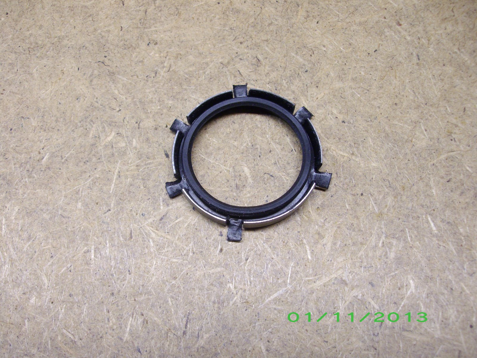

Bill , I use the rope style from Lang's # 3012 R
and I glue a seal on the outside like in the picture
Toon

Use a 30 X 50 X 05 AO - VBR modern seal on the outside glued on with Ultra Black for a leakfree crankshaft. If your engine is in the car you can not replace the stock seal. this seal is very thin and will fit between most crank pulleys and the block with no interference!
You may also install it like the pictures Toon posted. I like to cut all the web and flatten it like a daisy flower to allow a fit between the alum pulley.
This is a must do anytime you have the radiator off or the pulley off if you have any evidence of an oil leak.
