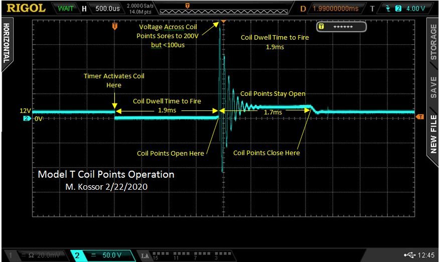

An alternate method of coil adjustment monitors the average primary coil current while it is firing a periodic series of sparks; like it does in normal operation. In this scenario, the average coil current is an indirect approximation of coil firing time. Adjusting the vibrator spring tension of each coil for equal average coil current reading indicates each coil is firing spark in approximately the same time. You could rig an Ammeter to monitor average coil current in the car but it is not as simple as installing it in series with the coil box power lead since you would not be able to associate average coil current to a particular coil. You could alternately install an Ammeter in series with each timer wire to alternately monitor individual coil average current but there is another caveat; each coil must fire a single spark as it is operating otherwise, the average coil current does not accurately represent coil firing time. Therefore, you need a way to see the time behavior of the sparks as they fire (not sure how listening to the engine idle would be effective in detecting double sparking coil operation) if the coil is double sparking; it can be remedied by adjusting the cushion spring tension. This was solved by sending the coil spark to a rotary spark gap with equal spacing to the ground electrode as was done on the Hand Cranked Coil Tester. So even if you were monitoring individual coil average current while adjusting the coil points in an operating car, not sure that would be a viable method to achieve good results.
Regarding the question: Can You Get Shocked Touching Operating Model T Coil Points?
The answer is YES. Here is the measured voltage that develops across a Model T coil operating on 12V battery during operation, note that the peak voltage reaches 200V but only for a very short duration:
Will you get shocked? The answer is; It depends. The variables include:
1. The voltage develops across the coil point contacts so touching both point elements present a shock hazard.
2. The voltage also develops between one point element and Engine/body ground so touching that point element and Engine/body ground presents a shock hazard, which could be even more dangerous if electrical current passes from one hand to the other as it travels across the chest.
3. How moist your skin is a factor in making good electrical contact with the coil point elements and/or Engine/body ground.
4. How tightly you touch/squeeze the coil points and/or Engine/body ground is a factor in making good electrical contact with the coil point elements and Engine/body ground.
This may explain why you received varied input others based on their experience.
