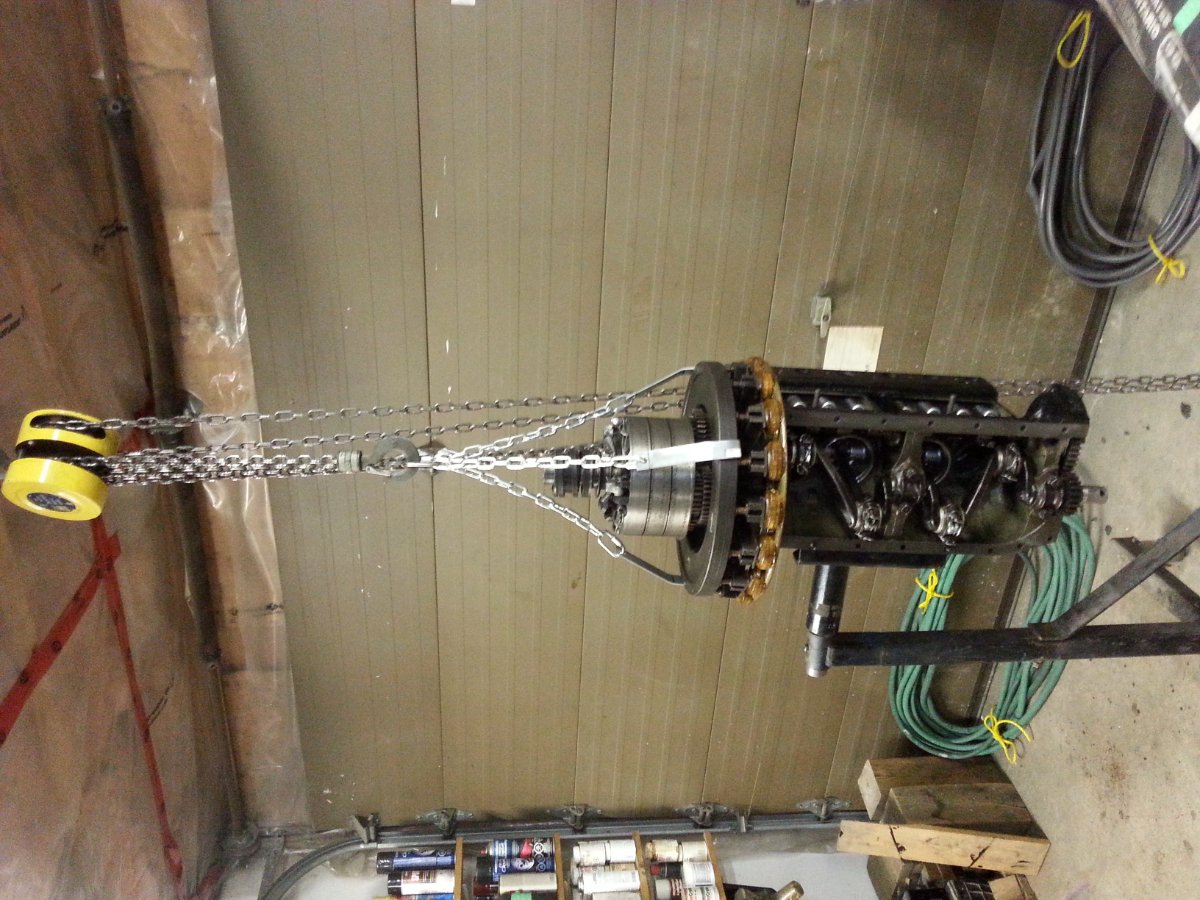

Hi All
Alternate method of transmitting fitting. From the MTFCA engine rebuild manual.
Way easier when it has to come on/off a few times when checking coil ring shims.
Drive Safe
Jeff
Nova Scotia

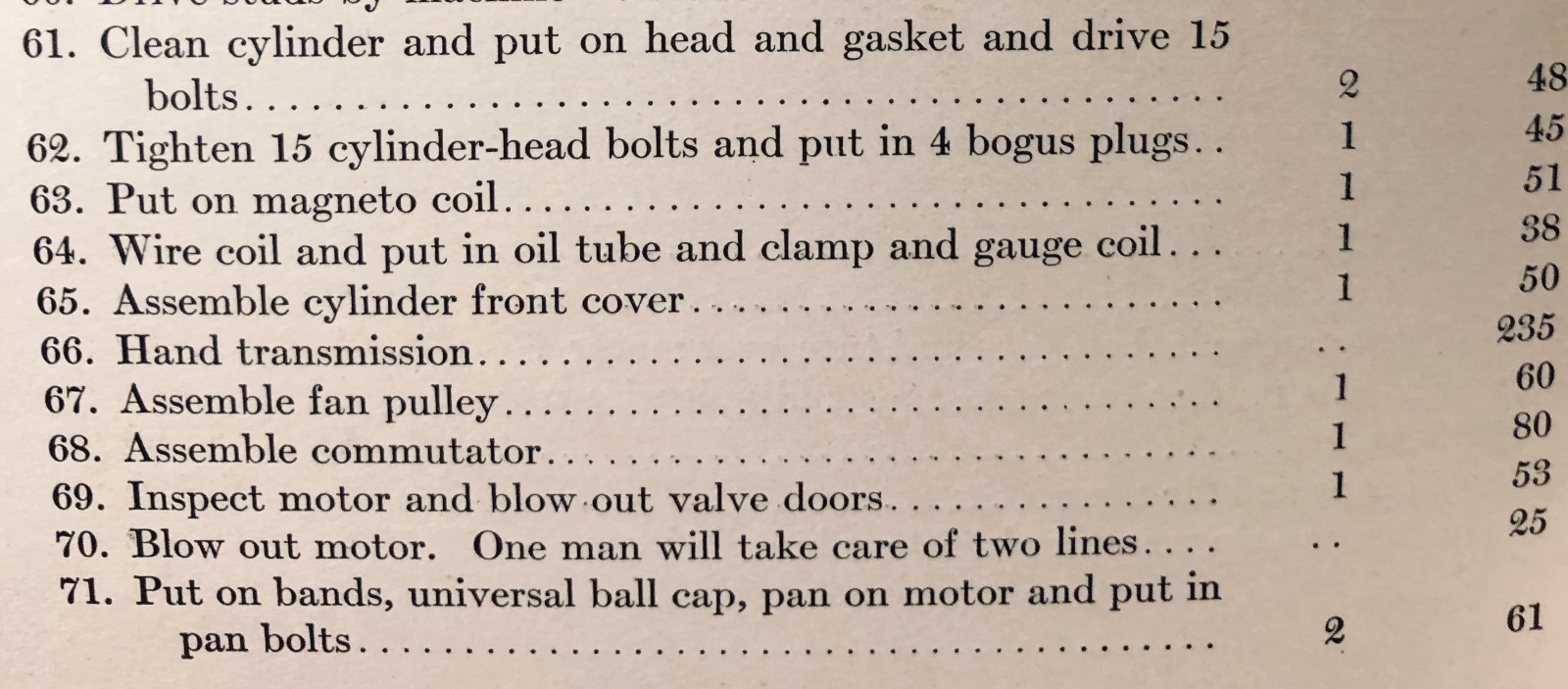

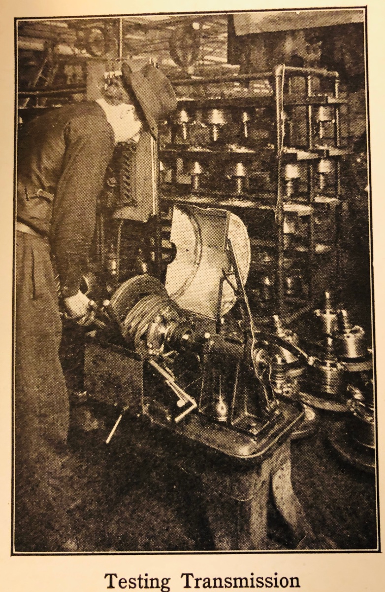

Couldn’t find yet any factory photos of trans mounting but Ford had so many special fixtures on the engine assembly line. Service Bulletin pictured one man holding trans and flywheel on one knee and mounting it that way, but would be for service away from factory.
The schedule of steps in engine assembly in Ford Methods and the Ford Shops lists #64 , one man and time of 38 seconds in which using gauge to mount coil ring on the block, so tolerances were checked for gap. Step #66 is trans added , says ‘hand’ but no # of workmen listed, but time of over 4 minutes, so could be fixture to lower the trans with motor vertical or maybe horizontal.

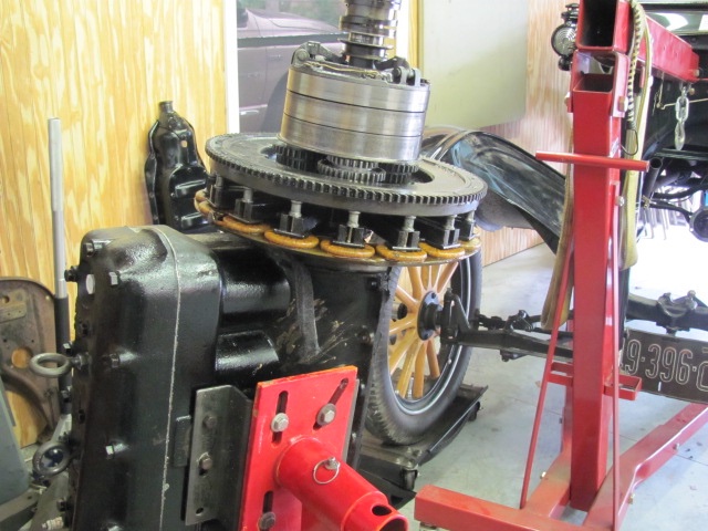

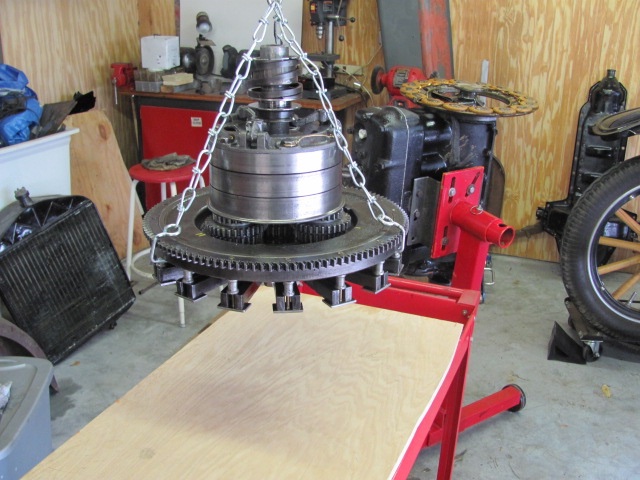

You need the set of four shims, they go under the 4 bolts that hold the magneto coil ring to the back of the block.
Lots of trial and error, even if you have done a few. Just take your time for a satisfactory alignment to get the gaps at the top and bottom of the flywheel magnets. Use of the gap gauge tool really is helpful. And have a nice mag ring restored, some are surface ground by the restorers so the mag ring iron casting is truly flat, that helps a bunch.
On final positioning, put the little ears outboard, they will snug against the felt seal around the block.
A lifting ring of chain suspended from the cherry picker helps the constant on and off it will take to measure the gaps. Get a set of brass feeler gauges too, as regular steel feeler will stick to the magnets. Be sure to index the location where you place the flywheel, it always goes back at that same spot each time you remove to add or subtract shims. With vertical mount, you will have the two pins in the flywheel in the same holes, and you will also tighten down the 4 mag ring bolts each time, and you will place at least 2 of the flywheel large bolts for being sure the interface of the crank and flywheel remains flat, as you turn the flywheel checking each magnet and coil face for gaps.
Stay determined, and in a few hours you'll have a happy gap for a strong magneto, takes time to do it right ;)
