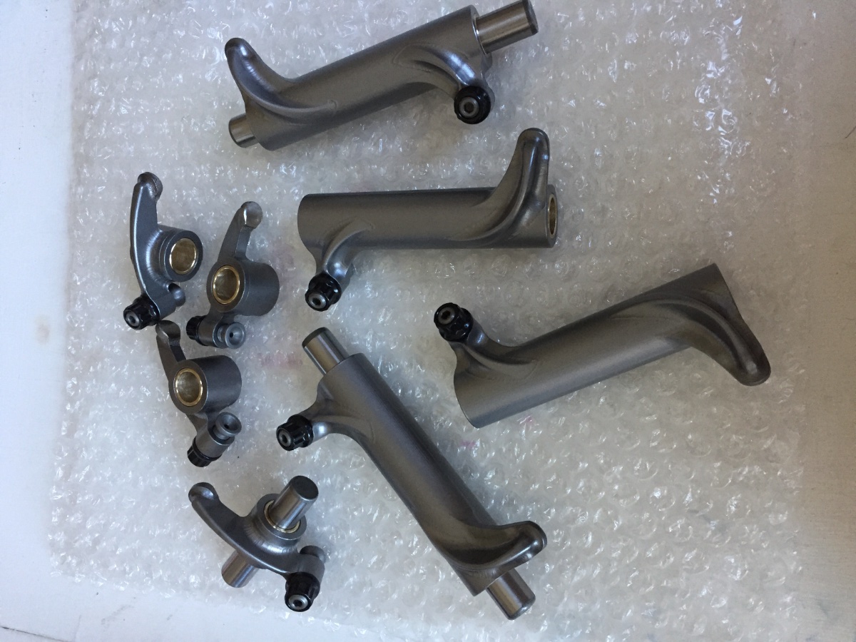

Rocker Arms Unlimited (formerly known as “Specialties”) has had some mixed reviews over the last several years, due to a change of ownership. And so I wanted to give em a public kudos as a result of my recent experience.

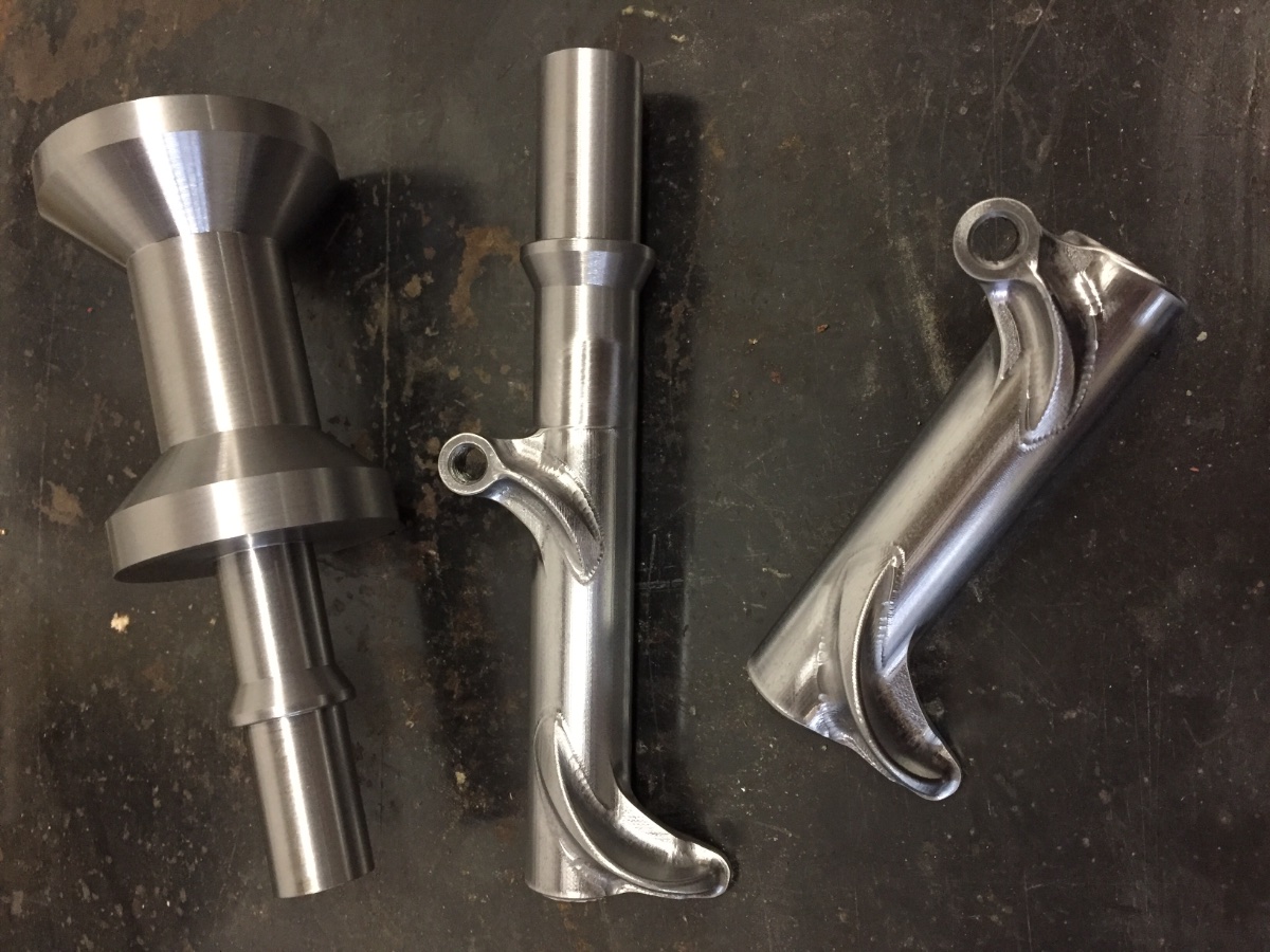

I custom designed and manufactured these rocker arms to retrofit my Akron-Hed from the original ball bearing push rod tubes, over to a (hopefully) more reliable conventional rocker arm design. RAU was able to take on the project with confidence, and performed the task without fault or complications.
The rockers were machined from normalized chromoly steel and I had a concern about material hardness at the valve stem friction surface. RAU flame hardened the tips of the rockers, bead blasted, bushed, honed, and ground the tips, all with beautiful results. They also set me up with the new adjuster screws, and all for a quite reasonable price.
The project took about 4 weeks to turn around, and I am grateful for their help
