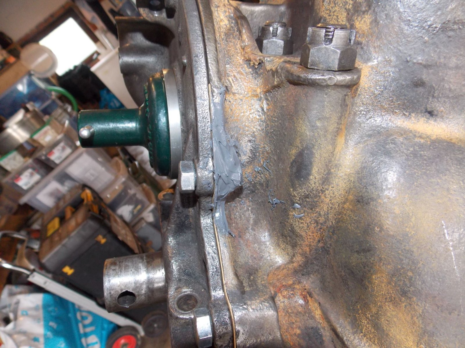

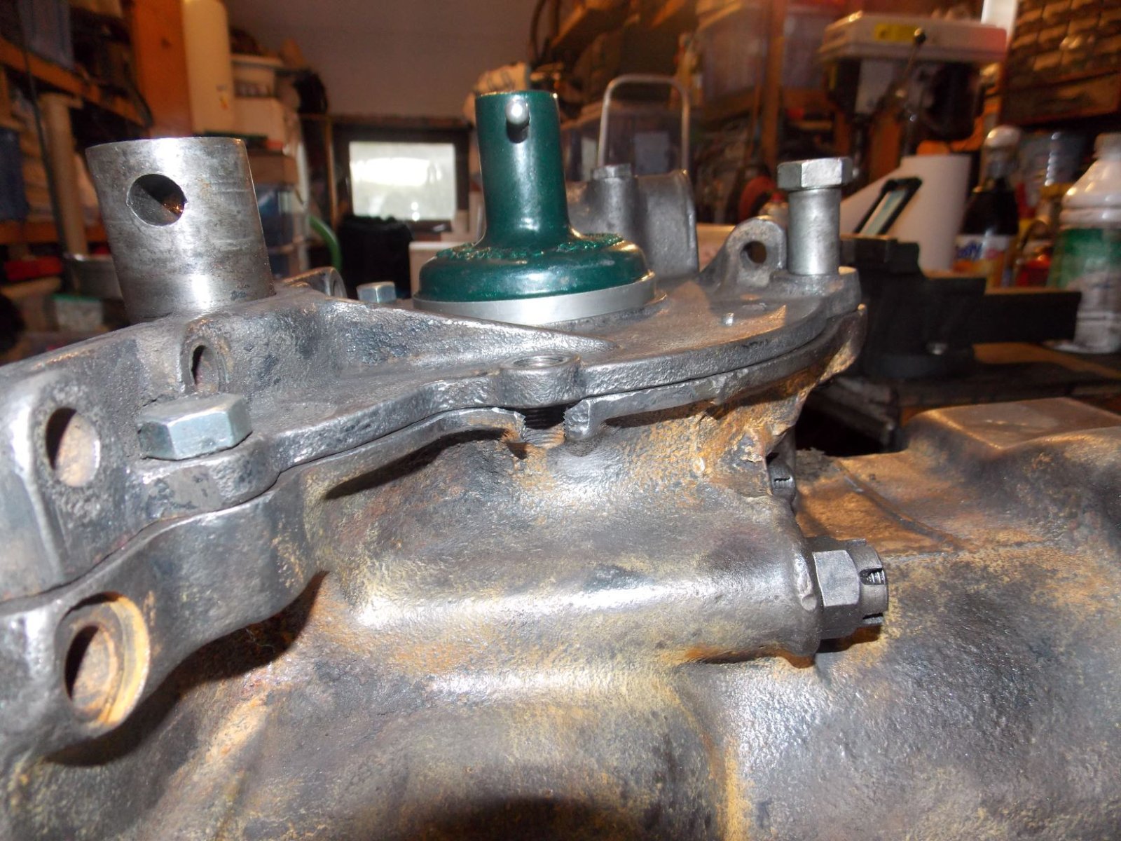

On the second day of the Death Valley tour the overflow tube solder failed in the header tank after driving along a disused rail bed. We found a garage to do a quick Solder repair but I thought it needed a little more support. So yesterday I pulled the radiator and soldered the tube and the support in five places. That should hold.
While under the car I checked the oil dip stick compared to the petcock. There was about half an inch difference. The dip stick indicates empty and the oil flows freely from the hole. So I shortened the outer tube by 3/8”. Now they almost correspond, the dip stick indicates empty when the oil is just about the top of the petcock threaded hole.

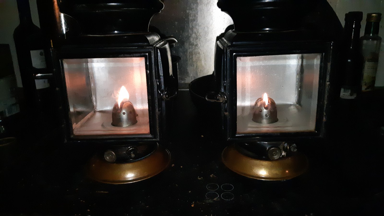

Have ordered diverse items for my newly acquired 1914 touring in order to pass inspection. In Denmark we must have flashers and stoplight, so I am preparing to extend the wiring for that.
In the meantime, I managed to get the sidelamps fixed with new wigs and fresh kerosene and here is the test:
Then i switched of the ligths in the room:
The requirement is that they can be seen from 300 meters distance. I think they fulfils that :-)

After the magneto loop I tried to repair the missing thread on the distribution cover.
Hope this is going well.
Will see in a few days when I start the reassembly of the engine and J&B weld will be hard out.

Next photos of the repair.
