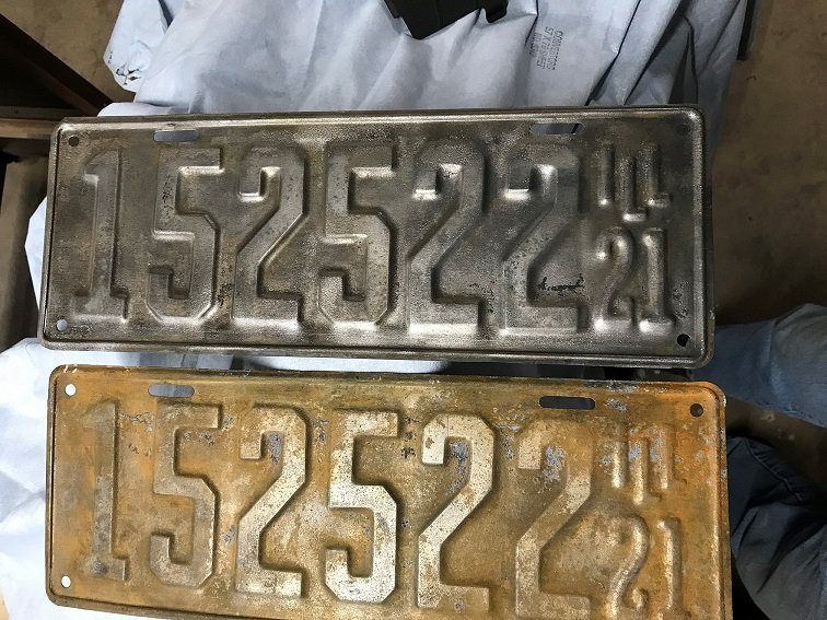

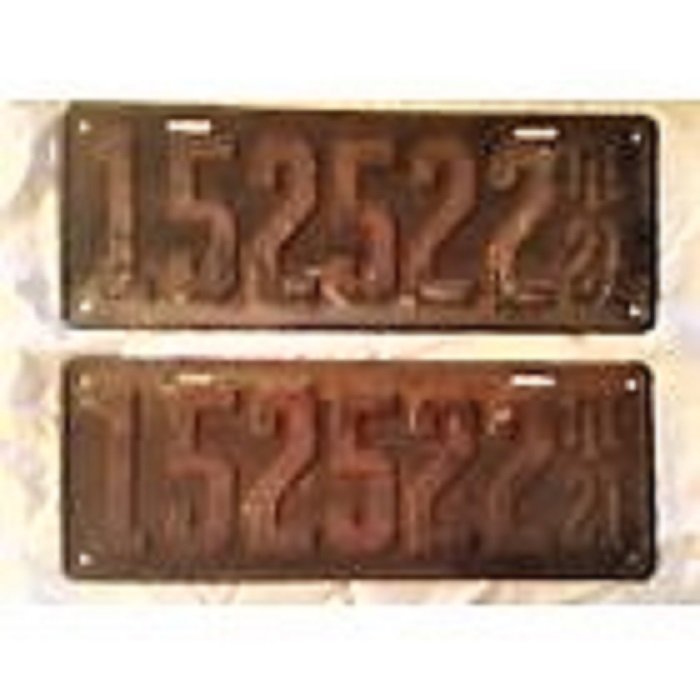

I have had luck de-rusting parts using a phosphate product - Krud Kutter Rustex-Rust Converter. There are many similar products, this one is biodegradable. Small stuff I drop in a bucket, straight stuff in a PVC Tube, odd shapes I wrap in some paper shop towels lay in they down in an old heavy shower curtain and keep the towels wet and wrapped in the plastic to prevent evaporation. Only takes few hours and the wash/wire brush residue off. When done the items have a bluish tinge. The solution is reusable many times over - $25 a gallon.

I posted these before. Started out with the rust photo, the second photo: brown plate is after the residue was washed off, the silver plate is after wire brushing.
