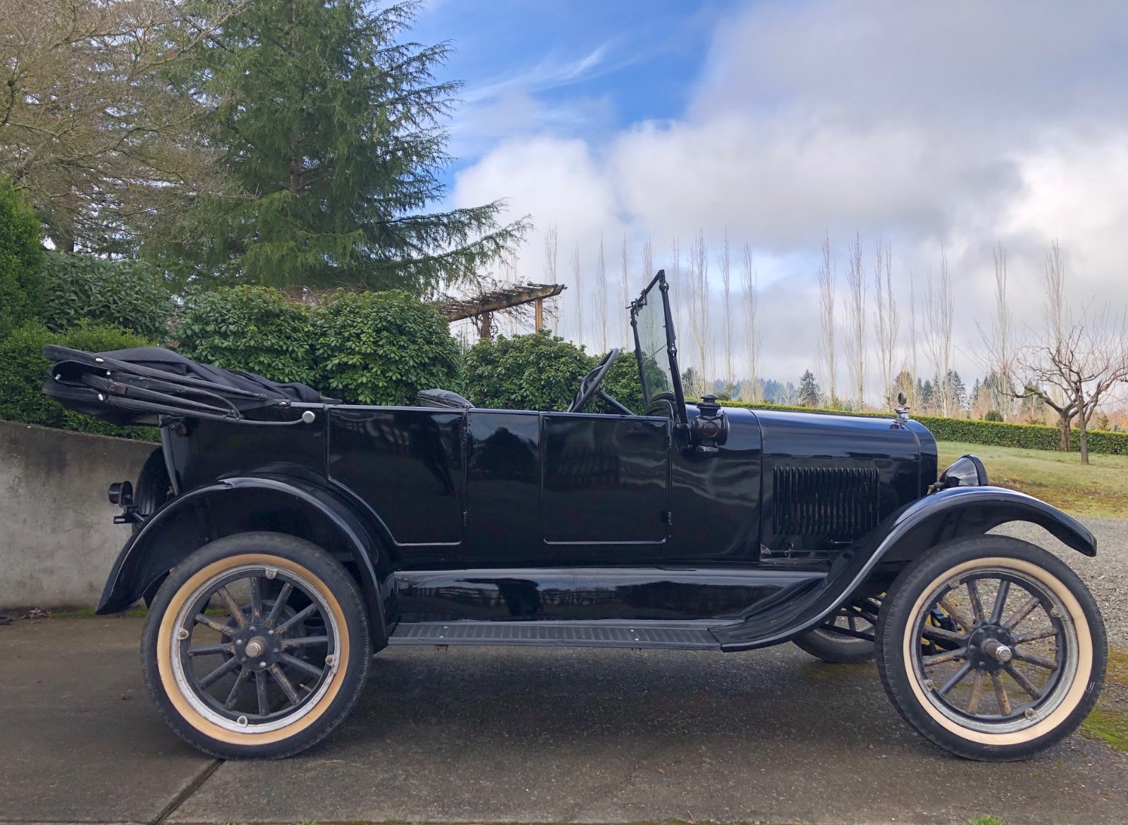

For reference, here is the car I purchased, hope you like it:

That is a very nice looking car. Welcome to the hobby.
