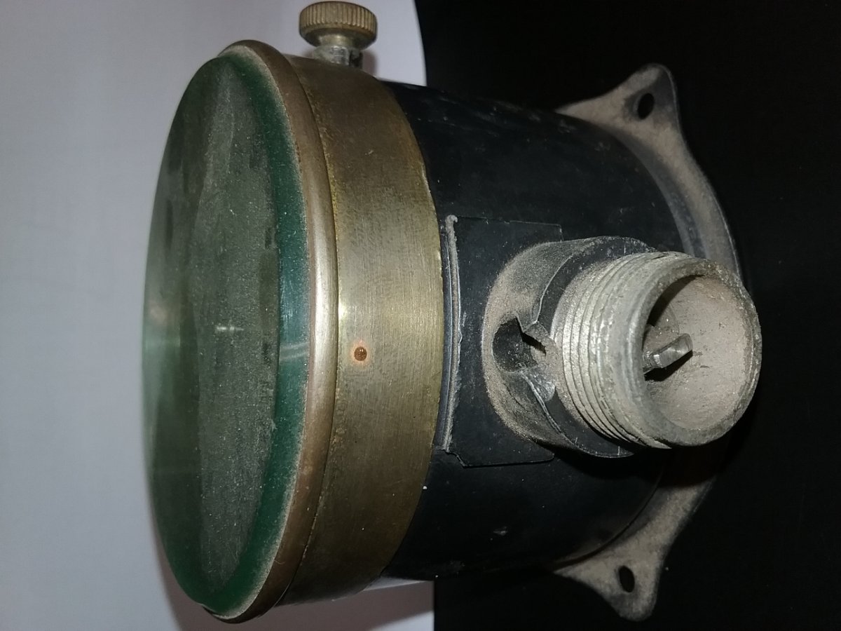

This is my John Mansville speedometer head that I plan to put on my 1915. Is there something missing here or has someone modified something? Other images I have seen on the interweb show a protrusion coming down from the bottom.

While we are waiting for the right answer let me share this photo. I think the middle one in this photo is the same as yours. It has no hole as yours does. Neither does the one at left. Also a JM. The "StanDard" at right has a spring loaded ball oil port. Could JM have made some with that?
Hope you find better answers.

Are you sure you want to use that one? It only goes to 60. LOL See ya at the next meeting, Don.

Keith: As you can see from your own pictures, your speedometer is missing the shaft. I would take the two best examples you have and ship them to Russ for repair. If you need to see a nice looking example, there is one on ebay for $400 that has been on it for weeks.
