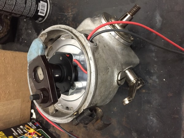

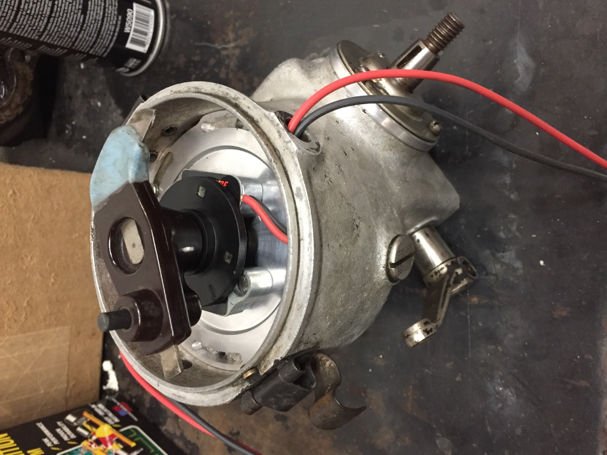

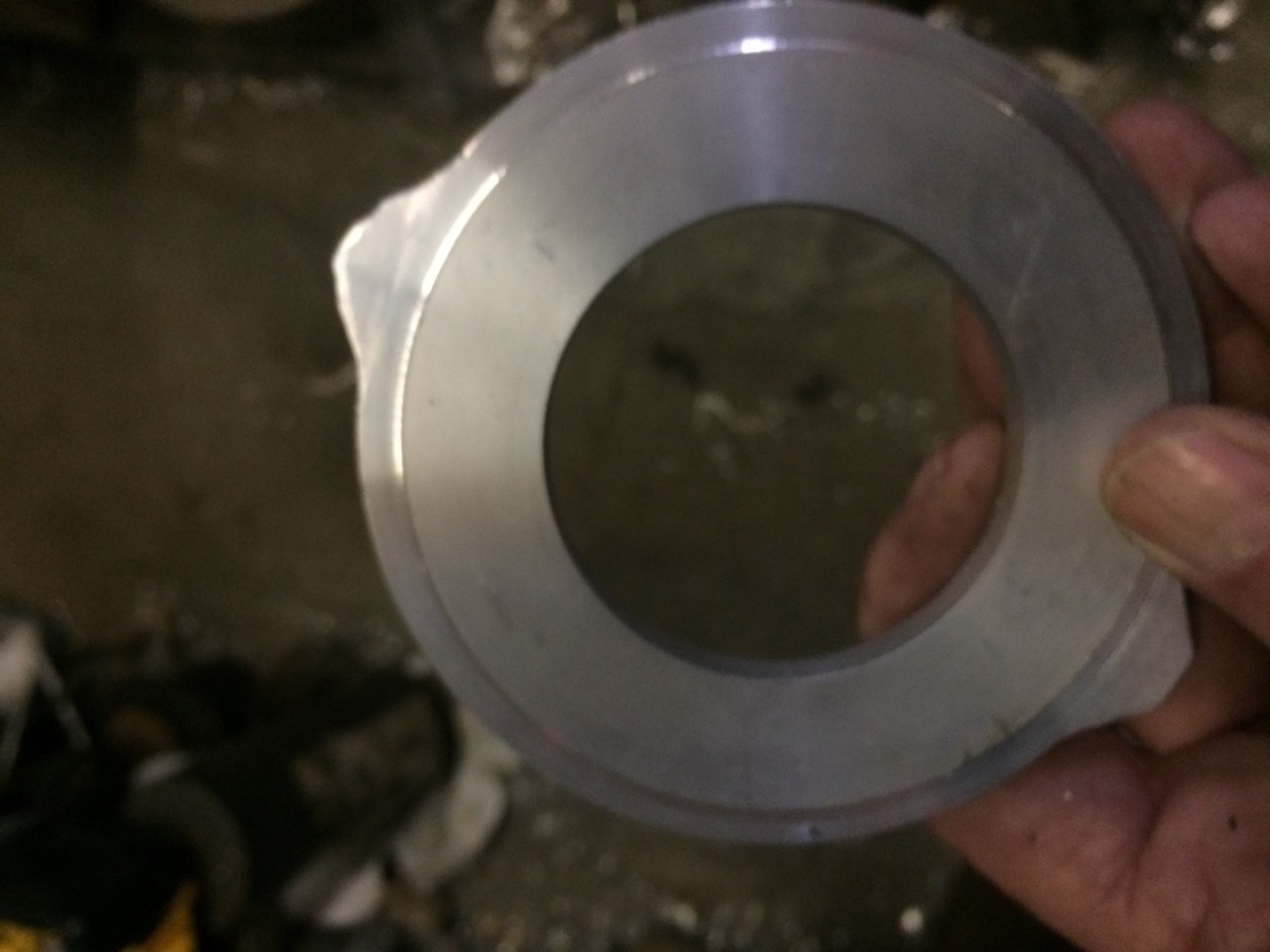

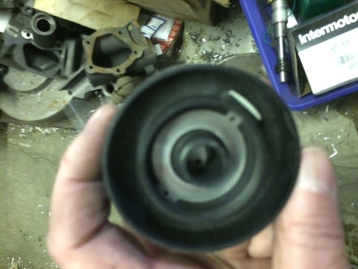

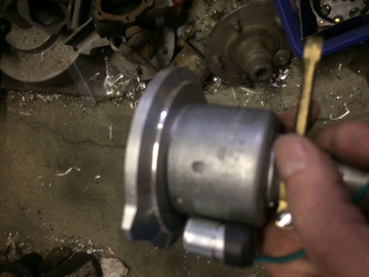

First picture is cap to Bosch distributor adapter

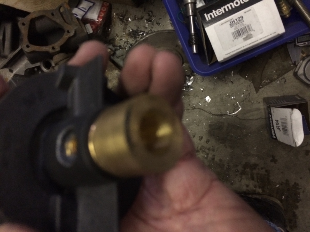

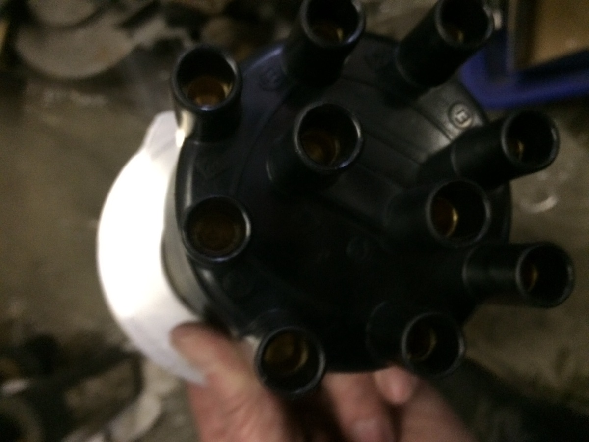

Next Nissan dual plug distributor cap

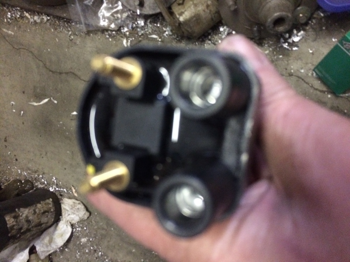

Finally Onan dual plug coil

In my case I used a distributor that bolts onto the T. Made two simple adapters and bought a available coil that is designed to fire two plugs at the same time. Simple basic ignition system!

All I will say is I spent at most 2 hours making the two parts to convert the Bosch front plate distributor. I consider that pretty “easy peasy”.
