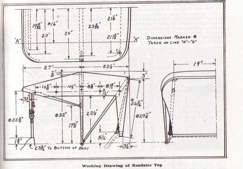

Is this the proper set of top bows for my 1915 Runabout?
There doesn't seem to be a way to attach the wood bows to the metal bows.
The wood bow slides into the metal bow and I would think that there would be a screw holding them together?

John, they are indeed meant to be inserted into the irons. A critical measure is the depth . You need to have them set so that they stack neatly, while sitting at the correct height. I can't help with the height, but if they are not set correctly, the top material will not fit well. Once you have the height set, urethane adhesive will fill any voids between timber and iron, ans should also exclude water from the assembly.

Re: 1915 Top
Maybe this will be of help.

Thank You all that's just what I needed

Don't count on each socket being the same depth!
You need to use that drawing and set up your bows so they're correct, but measure on both sides of the car!! You want the car to be on a nice level surface when you do it.
I used a small upholstery tack, though a very small hole drilled in each bow, to hold them in place. It's very important they are held tight so they don't move at all when you're fitting your top.... it's an easy way to come out with a poor looking top, or to waste a large part of the kit.

The ends of the bows should be shaped to the same taper as the insides of the sockets. The resulting tapered fit is intended to do all the holding, like a glass stopper in a bottle. The single heavy tack that is used is supposed to only supply a measure of safety. The 'drive,' as Ford called it, is the distance that each bow end should be driven into the socket. On the '14 touring the drive is 5, 7, 7, and 5 inches, counting front to back. I seem to sort of recall that the roadster is 5" on all bows but I could well be wrong on that.
Originally the sockets had a piece of wood driven all the way down to the end castings; this was done for reinforcing strength, and probably to help hold the screw for the key strap, but the trouble with the wood is that in most cases it has now either rotted or held moisture and caused the sockets to rust out or split, or both. So today most guys remove the wood or its remains, and after cleaning and drying the socket really well, fill it with a pourable epoxy; then, after it has well cured, drive in the bow ends.
