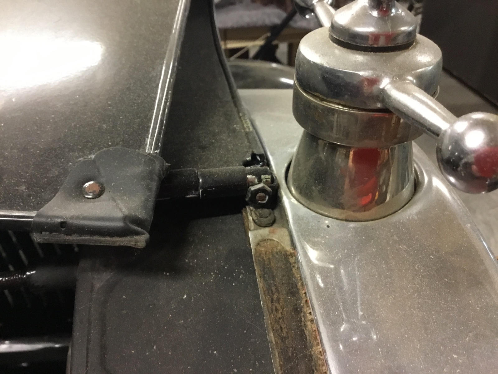

Mine did the same thing until I drilled a hole through the side if the retainer, through the rod and out the other side of the retainer. I then took a small slotted machine screw and, using it as a pin, pushed it through the hole and secured it with a nut. Not original to the T, but effective. Jim Patrick
The screw head and nut need to have small enough profile so as not to make contact with the hood hinge when the hood is closed.

Thank you, Jeff. You are correct. My hood is a reproduction I bought in 1972 during the first restoration to replace the original hood that was rusted through in places and the rod was frozen in place which cracked the hinges on both halves. My new hood did not quite conform to the curvature of my radiator, which caused the front of hinge rod to not seat all the way into the front retainer even when secured with the hood retainer clips. Instead of trying to bent the hood to conform to the radiator and possibly cause damage, I decided to secure it with a machine screw as I described. When held shut with the hood clips the hood holds tightly against the radiator shell. Whenever I need to remove the hood, which is very seldom, it is a very simple matter of unscrewing and removing the screw. Works for me. Jim Patrick
