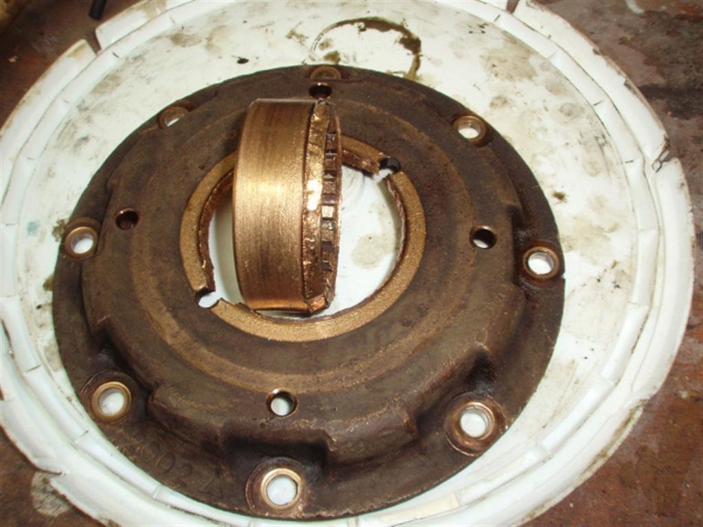

Ruckstells usually can't get 'stuck' in neutral. If they do it could be the thrust plate breaking (as happened to me...)
If that is the case you may find another by asking around. A replacement may take a bit of machining, but it is a 'doable' repair without spending too much.
Even with the plate broken I still had drive in 'low' speed. So try changing the lever to engage each speed to see if that is the case.
The mechanism is probably well and truly gummed up with the old thick oil setting like treacle, and that may also be holding the change lever from working the gears.

A Whiteman... I have tried moving the shifter, it moves into both positions with a sharp "snap" but still the wheels do not move.
