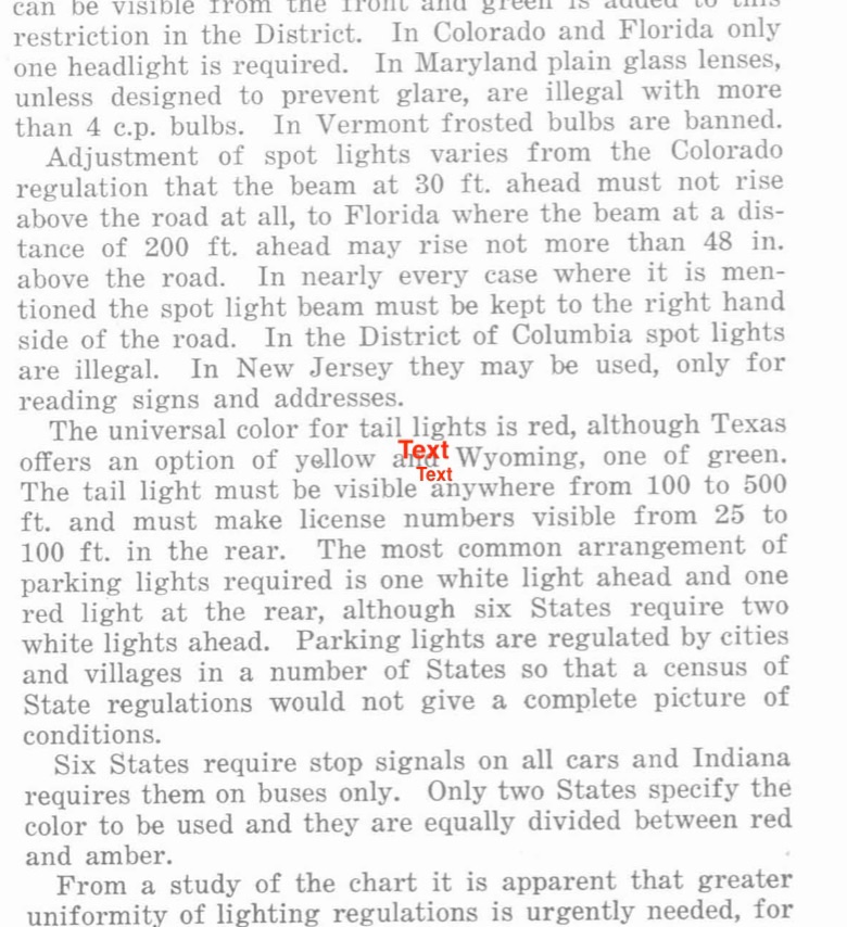

Even in 1925 some USA states allowed green tail light.
