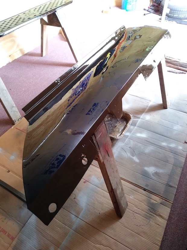

Post by jiminbartow » Fri Mar 27, 2020 1:46 pm
I have had great result using Rustoleum gloss black appliance epoxy. The fender shown was painted by me in 2010 and still looks great. Jim Patrick.
www.mtfca.com/discus/messages/118802/169877.html

Post by TWrenn » Fri Mar 27, 2020 2:52 pm
Jim, that is a fantastic job. That post was two years before I got into the hobby. Had I seen it, I might very well have tried it.
I know I would! Next time, I definitely will! I'm relatively lazy at my young 65, and would just as soon do it from a single can!

Post by Moxie26 » Mon Mar 30, 2020 10:15 am
Thank you "jiminbartow" ..... It was your post that I was referring thanks for reposting the pictures
