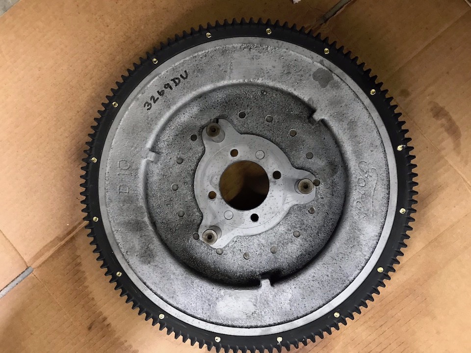

J&M Machine just sent some more pictures of the gears getting done.

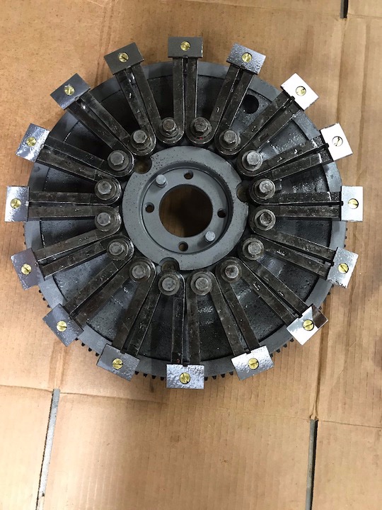

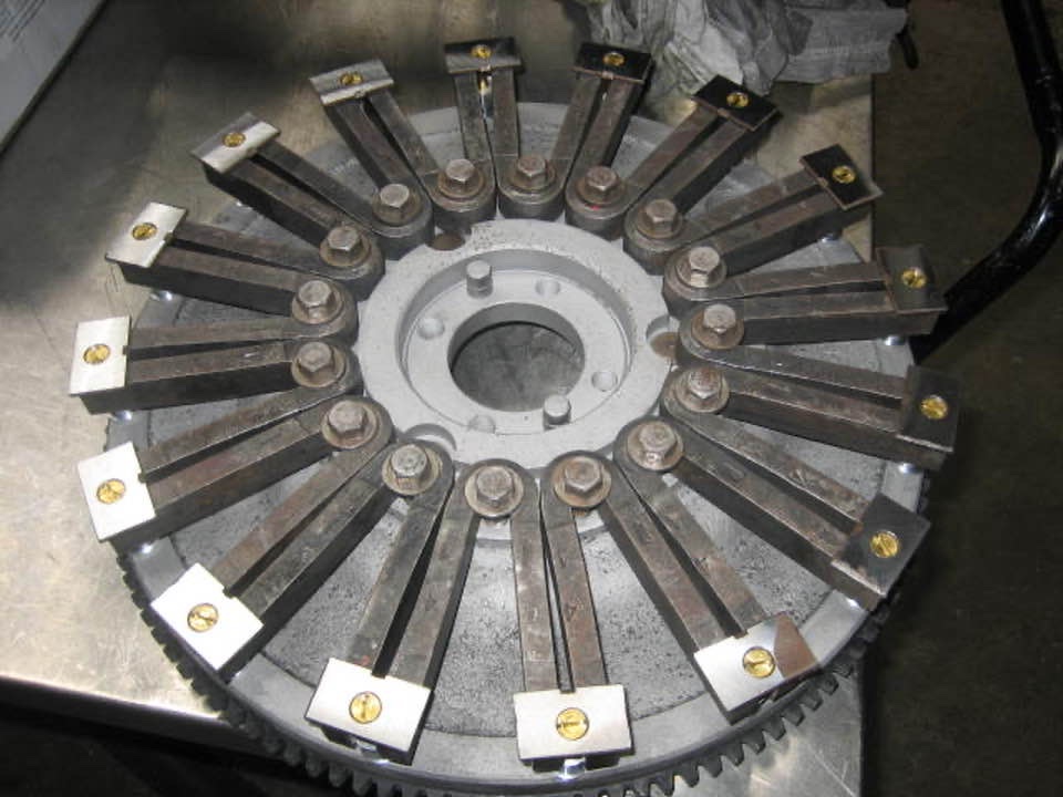

Well today J&M Machine sent me some pictures of the balancing process. John told me that this was not done by the factory but will sure make a big difference in keeping the "Rattles" out of it. Ha!! What a neat process and John and Michael are great to deal with. Unfortunately for me Most everything In my transmission was cracked or broken. I have seen first hand how the cost of doing it right can add up. I'm ok with that. This car is defiantly not an investment it's for the family to have fun and I plan on keeping it for a long time. If I learned anything it's that the Model T has to have everything working together. If not you run the risk of things "coming from together".
So let's get to the eye candy.
The pins pressed into the flywheel. Magnets going on. on the balance machine. I couldn't get the stats to post but the flywheel was off. John said that's why it's so important to balance it. After you take all the magnets off and on and get it all together it's off. Removing some material.

After it was done the whole thing was surfaced so when I set the gap it will easer.

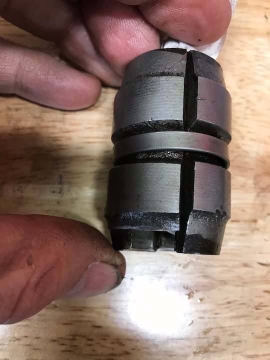

Well today I took out the valves I was able to use a Brigs and Stratton valve spring compressor. Most came right out but some had some sticky oil. I was able to pull them out with my hands. I numbered them 1-8 and then put each in a plastic bag that was numbered. I'm going to clean them up and then lap them in.
https://www.youtube.com/watch?v=De-e_6LKYBw
Then I found my first repair.
Also looks like the cover was not centered on the CAM shaft.

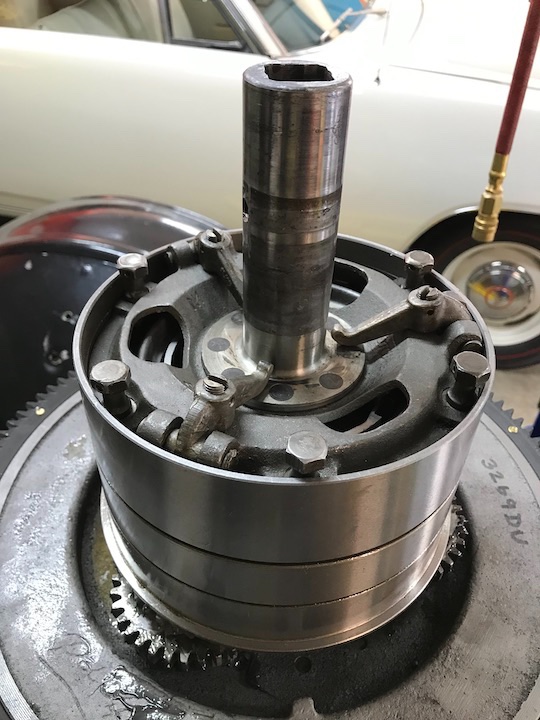

Then I moved to fiting the shaft to the flywheel. Michael from J&M said that the new shaft may not fit into the flywheel hole. It seemed to go right in with no issue.

Well I finally got around to working on the GAP for the Mag Ring. Most of the day Saturday was spent on getting two of our other cars back on the road. Some Fuel filters got them right and I was able to work on the T. I read the article in the MTFCA Magazine and thought I'd give it a try. This is a video of the first part. I had to use a rubber mallet to get the shaft on the two small pins of the flywheel.
First you have to put the Mag ring on with the bolts real loose. Then install the flywheel and tighten the blots all the way. At this point the Mag Ring will stick to the magnets creating a big gap under it. Take a measurement there and subtract the GAP you want .025 and then shim the rest of the GAP.
We will see how many times I have to do this to get it right. Ha!!!
https://www.youtube.com/watch?v=KZFzOts ... e=youtu.be

So after work tonight I took some measurements from behind the MAG Ring. I made sure I had the 4 blots tight from the crank to the flywheel. I made a drawing of the measurements then I subtracted the Gap I wanted. I went with .025. I am open to discussion as to how big it should be. I figure .025 would allow the trans to sag a bit and make the Gap on the top a bit bigger. The book says .025 to .040.
Here is what I got with my measurements. Remember The flywheel magnets have been surfaced so my initial Gap was a bit big.
So you can see the size of my shims I need to add. #1= .045, #2= .053, #3= .055, and #4= .055. As John from J&M Machine said "That's a good start." Ha!! I think I'll be taking this off and on a few more times.
Also I hope I didn't make a mistake by installing the valves and head. I've been careful turning the engine over by grabbing the flywheel. I haven't had to force anything so I'm hoping I didn't ruin the valves after all I went through to get them right.

OK. So tonight I shimmed the Mag ring in accordance with my measurements from yesterday. I was able to cut the shims by heating them up and then splitting them with a razor blade. Yes just like buttered bread when you drop one they land sticky side down.
After I attached the flywheel I took my first measurements with the engine on it's nose. Here is what I got.
I think I'll take away some shims and increase the gap at the top of the mag ring.
- Posts: 6524
Re: Getting Rattles Back On The Road
for itteration #2, that's looking darn good...myself, I will never install another mag ring that wasn't surface ground...what a difference in the consistency of your numbers...sweet.
Topic author - Posts: 1152
- First Name: Robert
- Last Name: Govoni
Thanks Scott. I was wondering if the measurements of .042 would be too much. I'm thinking that when the engine is in in the correct way it will sag a bit and close up the gap a bit.
- Posts: 6524
don't misunderstand...I mean for 2nd shot at it...I'm not saying you're done...you have the book and the numbers...it's up to you to decide when you're done
- Last Name: Govoni
Oh I know. I'm going to try to shave a bit more off the shims under the #1 and #2 area and see if I can increase the gap at the top and close it up at the #9 to #13. Sorry had to rethink this and fix my numbers. Ha!!

Well I had a small victory tonight. I was able to put the clutch cup on and have the correct distance. I used two .042 and one .025 washers and was able to get a .016/7 gap. The book say it should be .015 to .022. This was with me just pulling up on it. If I got a small pry-bar in there I bet it would be a bit more. I put the dial indicator on a lug on the brake drum. Here is a video of the measurement.
https://www.youtube.com/watch?v=J4LYDdIR4sI
Here is the setup. Then I put the key in and made sure it was flat agent the cup. I also painted the oil pan blots. I forgot to do that the last time.
- Last Name: Govoni
Well i got the clutches in. I'm using a Jack Rabbit Clutch set. So The first thing I did was soak the clutches in oil for two days then I scuffed up the new large disks. I stacked them as the directions said.
Now I just have to compress the spring and then bolt on the Clutch plate. The directions said that you may have to use another large disk if you have some wear. I'm hoping since everything is new it should be ok.
