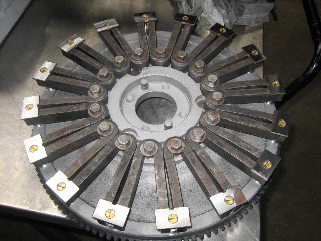

I determined that my original cast aluminum magnet spools were damaged by my last effort at leveling (that means I was over zealous with my hammer after the last engine rebuild). I am now setting up my magnets on my flywheel and am trying an alternate method.
I do not have a KW magnet setting tool. Erik kindly offered the loan of his tool. That would require about a 60 mile round trip and a second trip to return it. I am going to revert to my original method with a new twist.
I installed all new spools and screws. Next I measure the height of the keepers and enter them on a state of the art spread sheet.

What I do after listing the magnet heights is to determine the limits of variance in height I find acceptable. Having polled a few knowledgeable T mechanics I chose 0.010”. That translates to +/-.005”.
So after checking the spread sheet I identified the target height at .005” below the tallest magnet. The first step is to add shims to all magnets which fall more than .010” less than the highest one.
I obtained some fine imported Bavarian shim stock measuring .004”-.005”. Using a notebook hole punch and a larger gasket punch shims were produced.
I had planned on sanding down some of the higher magnet’s spools but that might leave the ends out of parallel. It soon became apparent that the required precision could be obtained with one to two shims.
Fine Bavarian shim stock and shims
Shim being inserted
Shim being inserted
The result was arrived at by repeating this process adding and removing shims and re-measuring about three times before planned accuracy was obtained.
Spool with shim in place
The next step will be to verify the job by putting the flywheel back onto the crankshaft and turning it to measure each magnet against the same field coil pad using brass feeler gauges.
This method is easy and non-invasive, no magnets or spools were harmed in the performance of this task!

The first time I read or heard of lowering the high magnets by whacking them down with a hammer I hated the idea. I still do. I make my shims out of brass stock I picked up at some auction. I get all the keepers within two or three thou. Within the prescribed range of .025" to .040" I figure .002" or .003" is no big deal.
