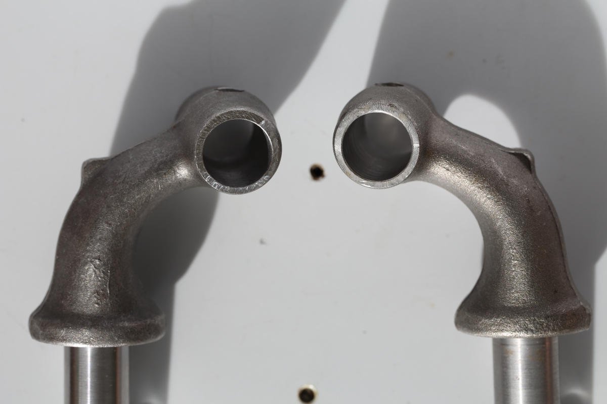

I think that they are both for the left side because the boss is on the back side of the perch on the left side of the car and the boss is on the front side of the perch on the right side.

Re: Front spring perches
Well, I have seen an axle or two, in other people's cars, with both perches being for one side. So I know it can be done. The spring is the weakest flex point in the assembly so would be twisted to accommodate the perch which would be held crooked (being angled wrong) by the axle and aided by the wishbone that is supposed to help set and hold the caster angle.
And that is what it looks like you have in the photo.
Yes, you should get that perch replaced if you can. Hopefully, if he put the perch in himself, it may be loose enough to come out easily. If the perch was a tight fit, and been in there long enough, they can be so stuck that it takes a good press and a big torch to get them out. If that is the case? You would be better off to get another good axle with two proper perches in it. They still aren't too difficult to find. You maybe should also replace at least the main leaf in the spring.
Even though it may drive and handle okay that way? It is putting a lot of pressure twisting the spring that way. It could cause the spring 's main leaf to crack and/or break without much warning. That could result in a sudden loss of control that if it happened at the wrong time could have very bad results.

The perches have part numbers on them. The odd numbered perch is left. 3818 right and 3819 is left.

My 24 Tudor had two left perches on it when I got it. I drove it for a year or two before someone noticed the problem and pointed it out to me.
With the two left perches it had a noticable shimmy after going over speed humps.
If you get a new perch it is a good idea to check it as some of the new ones are not machined very well.

I finally got the new correct front spring perch installed along with new shackles and bushings in the spring and perches. I also replaced the king pins and bushings, spindle arm bushings and bolts, and the ball for the tie rod yoke. I took it out for the first drive yesterday. It drives nice with less slop in the steering wheel, and feels much more solid. Thanks for the advice.
