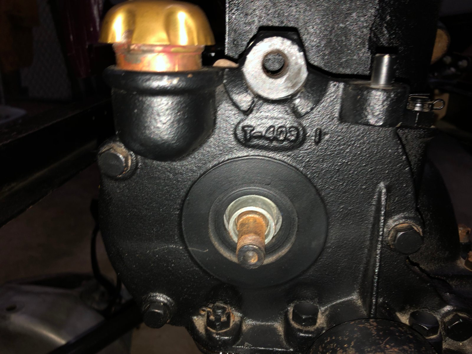

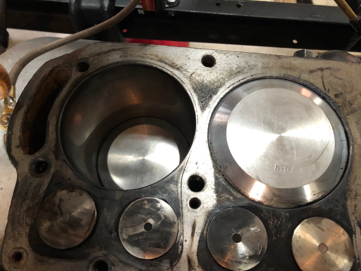

I have had my 11 engine started but it misses on numbers three and four. It came to me newly rebuilt. I had the coils rebuilt and the carb rebuilt. Shorting those cylinders out makes no noticeable in the rpm’s. I have switched coils around no difference. I thought it was an intake leak because spraying brake clean at the intake port slowed or stalled the engine. I have replaced the intake glands and copper rings twice. The glands are not too wide, the manifold is not being held out by the glands,and the manifolds are straight. After replacing the manifold gaskets the last time, same problem I now think I was getting a false reading by spraying thru the plastic nozzle, as it took a steady spray to affect the rpms. Today I took the head off and the numbers one and two pistons are black the problem numbers three and four are shiny and clean. At a loss here, Art

I had suggested a different intake manifold in lieu of the original aluminum dog-leg intake manifold? Did you try that?
And, what were the compression readings prior to taking off the head?
A pair of cylinders side by side, that clean, leads me to a hellacious vacuum leak or a manifold obstructed by a rag.

art, please make certain the head bolts holes are clear, the one i can see in the middle of the block near the manifold has water in it, [cant compress water] it can crack the block. its going to be hard to find the problem with it apart, when engine was trying to start did it sound like all cylinders had good compression ?not limping by ,each rotation needs to sound the same,a good test for manifold leak, when engine is running ,spray carb cleaner where te manifold mates to the block,in your case the rear,cant do this with head off, while head is off could the intake valves in those two cyliners be slightly stuck? are they closing tight,you mention its been setting a while, by the looks of where the head gasket was ,it was making a good seal, you might have to put it back together to find the problem, it don't look as its the ign system,the best way to test that is lay a plug with wire hooked to it on the block turn engin over with ign on, you should get a spark. this some time will make you scratch your head, but its going to be simple when you do find the problem .good luck

Two thoughts by looking at top photo. Spark plug wires appear to be very close to throttle linkage control rod. Perhaps shorting out? Also, might wait 'till dark and from what you say, engine does run on two cylinders. With engine running in pitch dark tonight, look for errant sparks.

Timer wires running to/from the coil box look close to number one spark. But it may be the picture. I have clips keeping mine well away from except where they need to go.

John, I have been told you can't use a different timer on the 1911 unless you change the timing gear cover. Otherwise I would try a new day timer. Art

Are your valves set, in the picture they all look closed. Maybe 3 and 4 weren’t done??

Art, after years of struggling with a two piece timer I gave up, changed the timing cover and switched to a brush style timer. No more problems. Unfortunately, the early timing cover for the two piece timer can't be used and if you want to keep the spring loaded fan set up you will need very early timing cover.

Russ, I am not using the spring loaded fan set up. I believe that was a little earlier than my car. Mine has an adjusting bolt and nut. What timing gear cover should I use to go with a brush style timer? Art

While the head is still off, have a look at the valve seats in #3 & #4 and see if you can determine whether or not the valves are contacting the seats for the full 360 degrees. Though the engine has not run for long, you should still see indications of contact on the seats and on the valves. Also, check the valve lash to be certain you have clearance in the intake & exhaust valves when the valves are down/closed.
All of these potential problems will ultimately be revealed during a compression test, but if you find them now, you'll have saved a new head gasket from being used up needlessly.

And the winner is! RV, I think you got it! I can not get my pinky down the rear leg of the manifold. Here is a picture of a solid restriction. Next is to break it out to determine what it is.R.V.Anderson wrote: ↑Sun Apr 12, 2020 2:59 pmThis sounds ridiculous, but if the engine's been sitting awhile you may have a mouse nest in the rear side of the intake manifold. You wouldn't be the first that that's happened to.
I have no experience with the original two piece timer, but I have heard of problems with them. I have also heard that the problems are easily fixed. Someone with experience will have to kick in his two cents.
