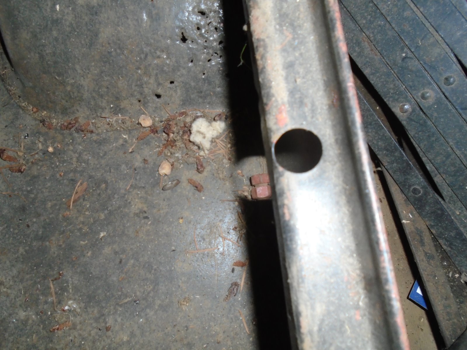

I think you have your answer but here is what my 26 looks like. In my earlier post I mentioned two additional boards but I had fabricated a temporary seat for a wedding. I don't know what the large hole is for in the seat frame?
- Posts: 4046
Re: Board under Rear Seat.
David
Believe those pair of holes on the front edge of the seat rest frame are retention holes.
The open cars, at least from '23 have those pair of holes in the front and rear seat risers, the original seat springs have two prongs that wedge into those large holes, keeps the seat in place.
Reproduction seat spring bases for these later T's don't have that feature, so you have to rely on butts to hold them down
, or remove those seat spring cushions when open trailering to keep from loosing them
Note the spring steel prong on underside front edge of original seat cushion.
Those 2 holes on front riser of a '23 touring.
