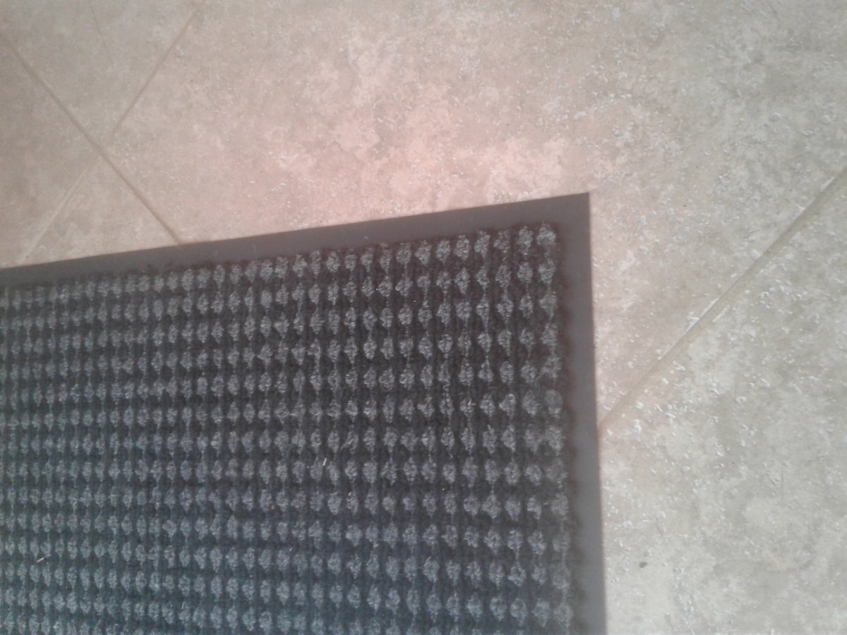

Home Depot type stores have "walk off" mats, the type you would put inside your back door, so your wet shoes don't track up your house. This one is a low nap carpet on a thick rubber backing:
They are cheap, can be cut to fit front or back, and can be removed and hosed off to clean. Your store may have something similar in solid rubber or vinyl.

George thank you for your information i planned to make a template first before hacking anything up. Wayne i have also thought about looking into exacly what you are talking about. Now here is a difference the two door has more room up front and less in the rear the fordor has less room up front and is very spacious in the rear.
