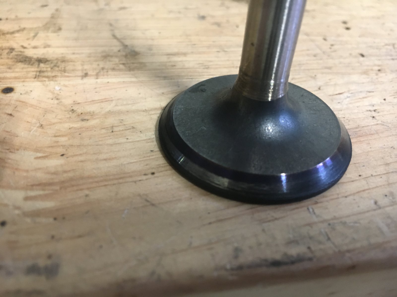

Here’s a picture of the suspect at the moment
You can see how much stuff that filter has collected, that dark stripe in the bottom is all sediment.
I’ll patch in a hose to try it first, and then today is probably going to be the day to replace the copper line with steel

bringing this one back to the top again
finally tore into the engine today, after the Seafoam treatments made no difference.
#3 exhaust valve stem shows evidence of "chatter" indicative of a sticky valve (could also be that the guide has been knurled, and the valve was stuck in place, leaving behind "witness marks"), and the face shows uneven discoloration - evidence of an eccentric valve or seat, and eventually a burned valve
EDIT 05/30 : cleaned up the valves. several show uneven wear indicating guide issues, and 3 valves have evidence of corrosion. the one pictured is by far the worst. Also - the guides aren't knurled
misfire case closed
on to a "valve job" thread
