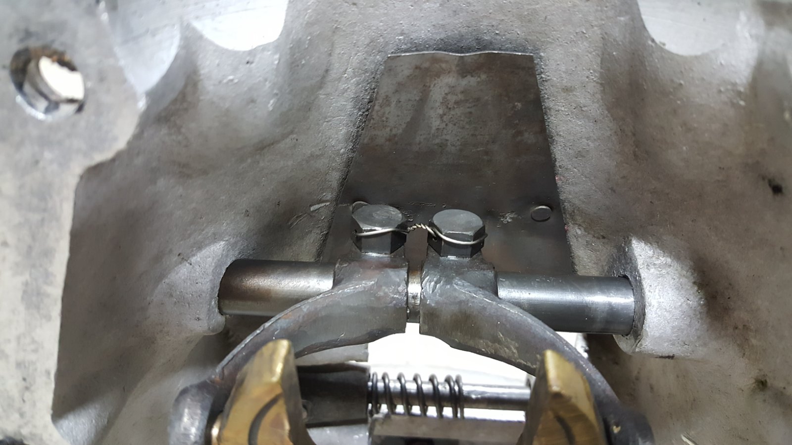

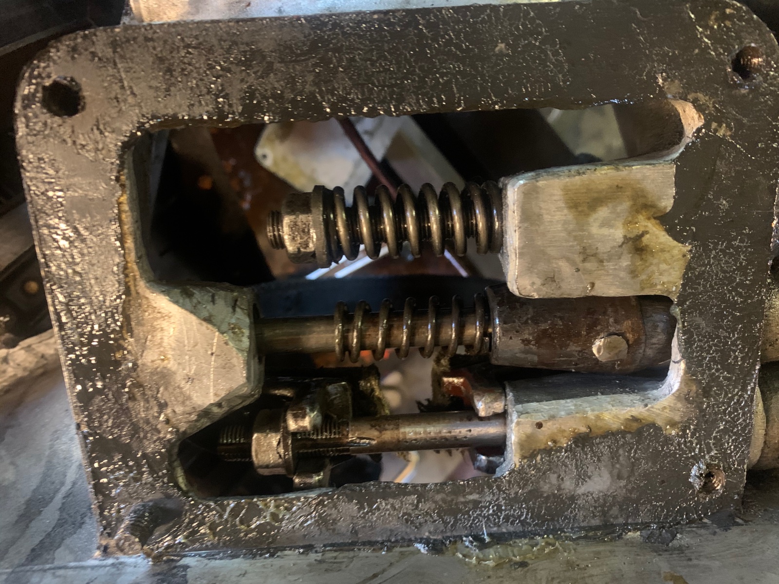

I took a couple of pictures of the opening in the 09 hogshead and one of the adjusting nuts.
09 hogshead inspection hole
09 adjustment nuts
09 adjustment nuts
I don’t need to say more......

Posts: 6804
Re: More hard cranking problems on the 1909
Post by Scott_Conger » Tue Apr 28, 2020 10:35 pm
I'd give serious thought to putting in a matched set of correct rate springs for the bands. Your brake spring has the appearance of potentially coil binding long before the brake band begins to wear or settle in

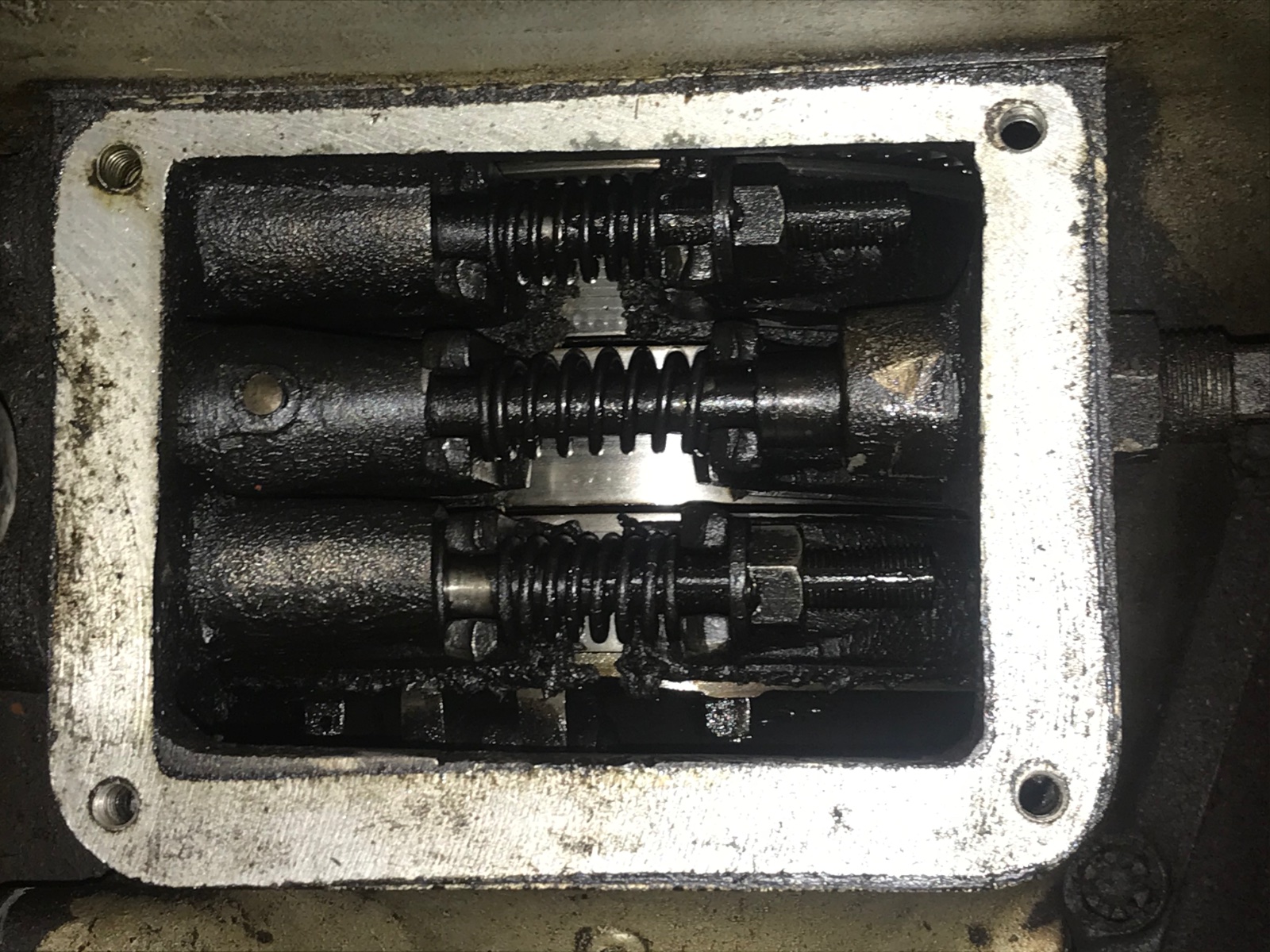

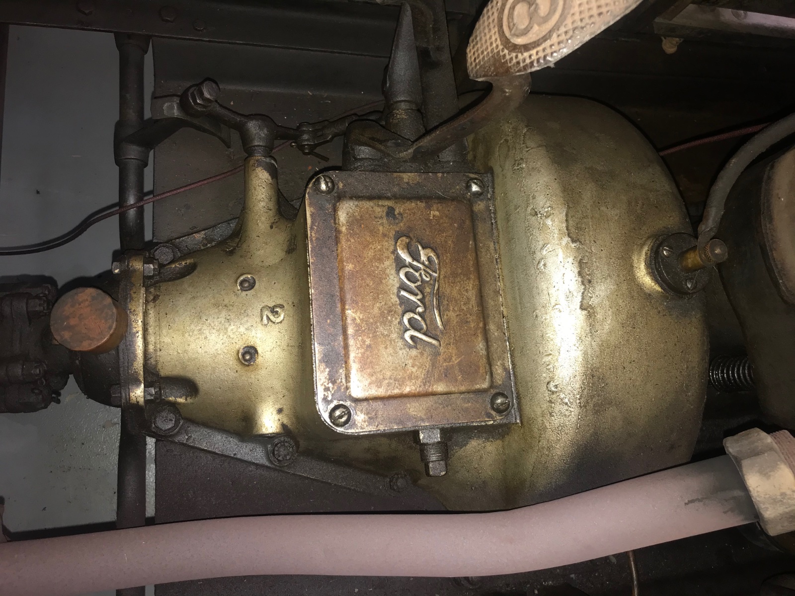

Tony, here a couple of pictures of my 1910 transmission cover. There appear to be some differences in the inside of your cover when compared to mine. This might translate into dimensional differences inside your cover which may put pressure on your bands. Best of luck !!
Posts: 5598
Post by RajoRacer » Wed Apr 29, 2020 1:41 pm
Tony - could it be possible your cover is a reproduction ? Sure doesn't look anywhere's near the same as Kim's.

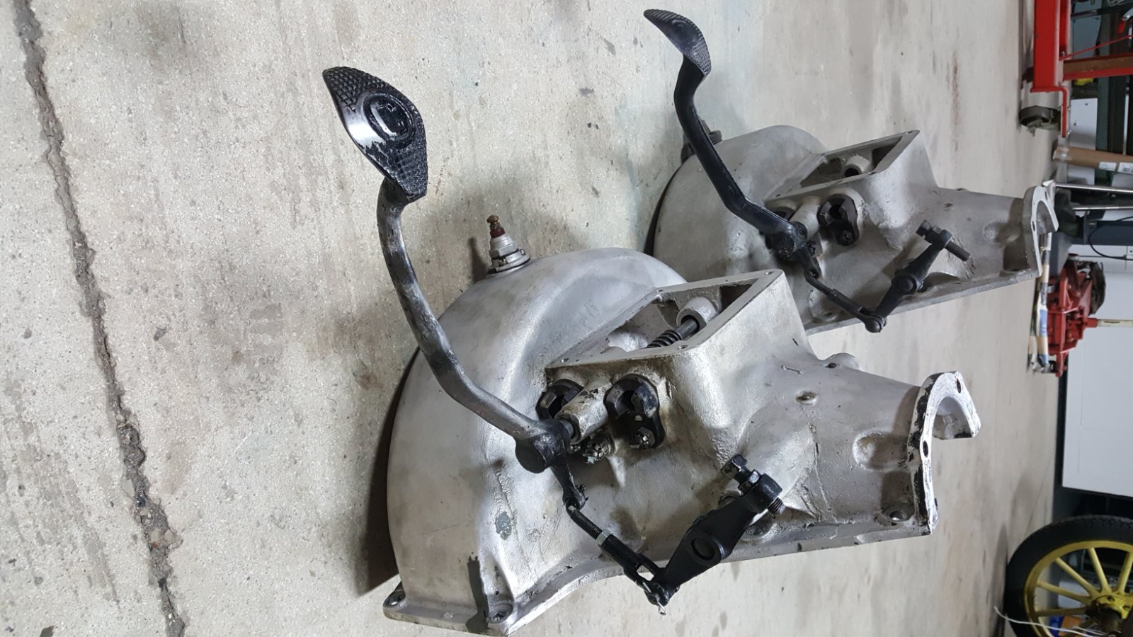

Yes, I agree. Attached are photos of two square door's side-by-side, both originals. The one marked "2" (like Kim's) came off a 3,000-numbered car and is likely original to it. The one marked "1" was bought as a loose part and its serial number is not known. I had looked over both very carefully and they appeared identical to each other. I think what everybody is seeing is these have round pedal bosses inside the square door opening whereas yours are cast all the way to the top and milled flat, so there is something different going on there.
