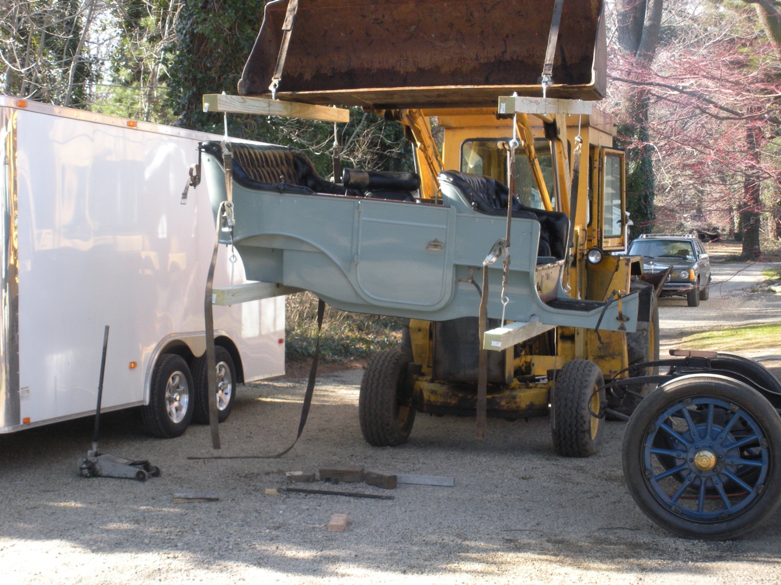

Russ T Fender
Posts: 467
First Name: Val
Last Name: Soupios
Location: Jupiter Florida
Re: Good Idea's Needed!
Post by Russ T Fender » Mon May 04, 2020 10:58 pm
Here's one way

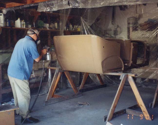

Posts: 4684
Post by Norman Kling » Tue May 05, 2020 10:49 am
This is what I did with a 26 touring. I think it would also work with your earlier body. I made two horses out of 2x4's just high enough to be able to roll the chassis underneath without hitting the horses. The only picture I have is shown of me painting the body but to put the body on the chassis, I would turn it 180 degrees from that picture and roll the chassis under, rear axle first. Two men can lift the body up and set it on the horses.
Posts: 4684
Post by Norman Kling » Tue May 05, 2020 10:54 am
Another thing I should explain. The top horizontal 2x4 is set into a notch but not nailed down, so after the body is above the chassis, that end of the body is lifted up by 2 men and the 2x4 removed and the body set back down on the chassis. It only has to be lifted a few inches and lowered an inch or two to accomplish. This setup also allowed me to get under the body to paint the underside as well.
