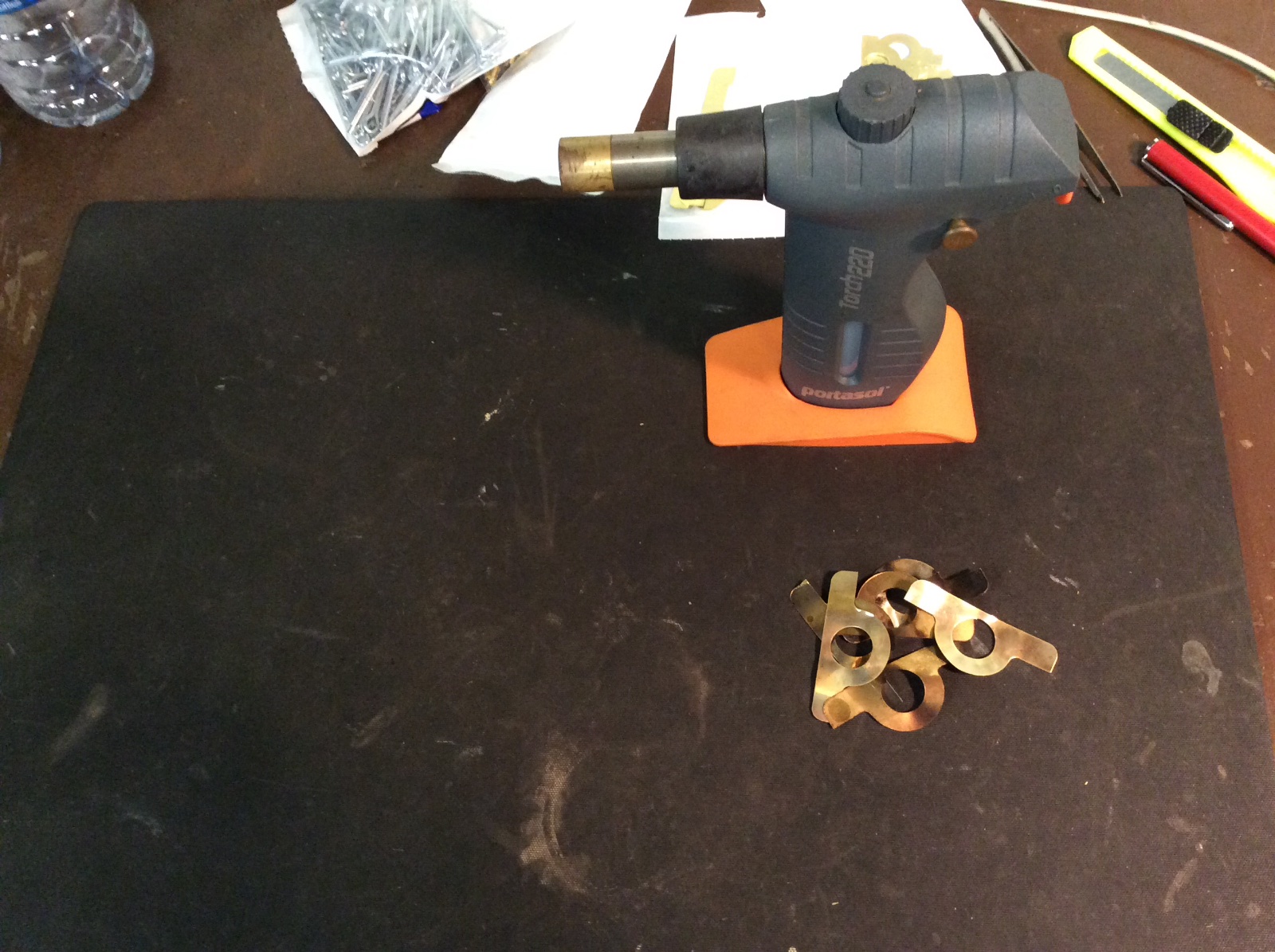

Re: Pealing off laminated shims.
I had good luck heating the shims with a micro torch. I held one end and heated just the outer layer all over. The outside layer would curl and loosen. They came off one at a time. The forum helps me once again.
