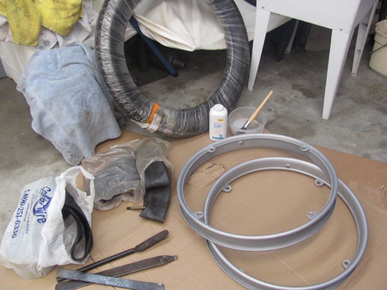

Another choice would be to go original and galvanize them. When I had mine done about seven years ago the minimum charge was about $235, so my seven rims came to about $33 each. Recently a bunch of T guys went together on galvanizing a batch of rims because the more you do the lower the cost per rim. I haven't heard how many they did and how the cost worked out. Maybe Ignacio or one of the other guys will see this and comment.
