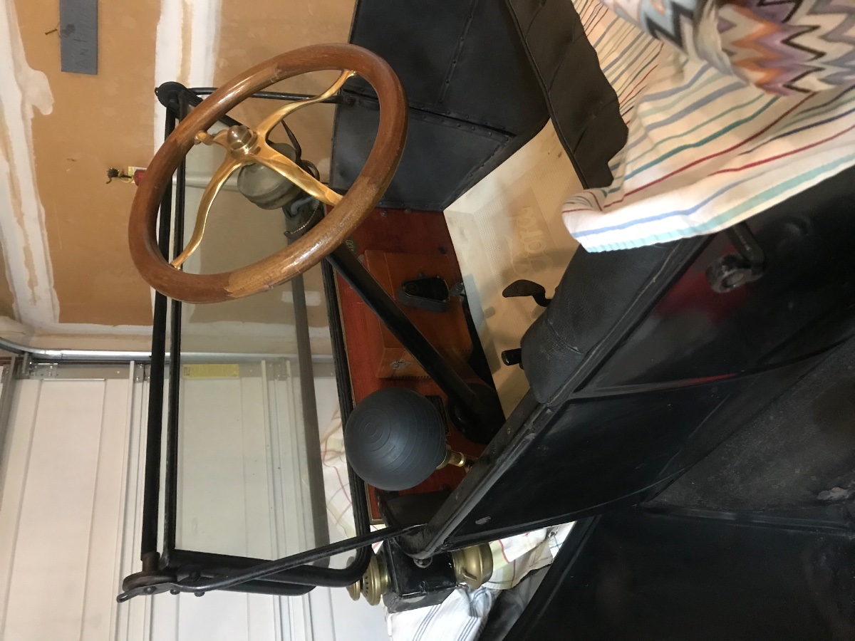

Post by GEmering » Fri May 15, 2020 2:01 pm
She has risen!
Alleluia, Alleluia
Thank you to everyone who helped with great suggestions.
Gene

Good deal! Looks like things did move after all. Did you have to loosen anything or just give it a little more ‘umphh’ to get it to move. Whatever you did it worked!

Post by GEmering » Fri May 15, 2020 2:35 pm
John,
Ed Fuller's post (above) enlightened me as to why the brass covers on the interior side of the hinge would not screw or turn off.
Answer - They're covers that just pull off revealing a nut that can be loosened.
A couple turns of the nut with a 19/32 wrench and we're now in business!
Thanks again MTFCA and everyone who posted.
