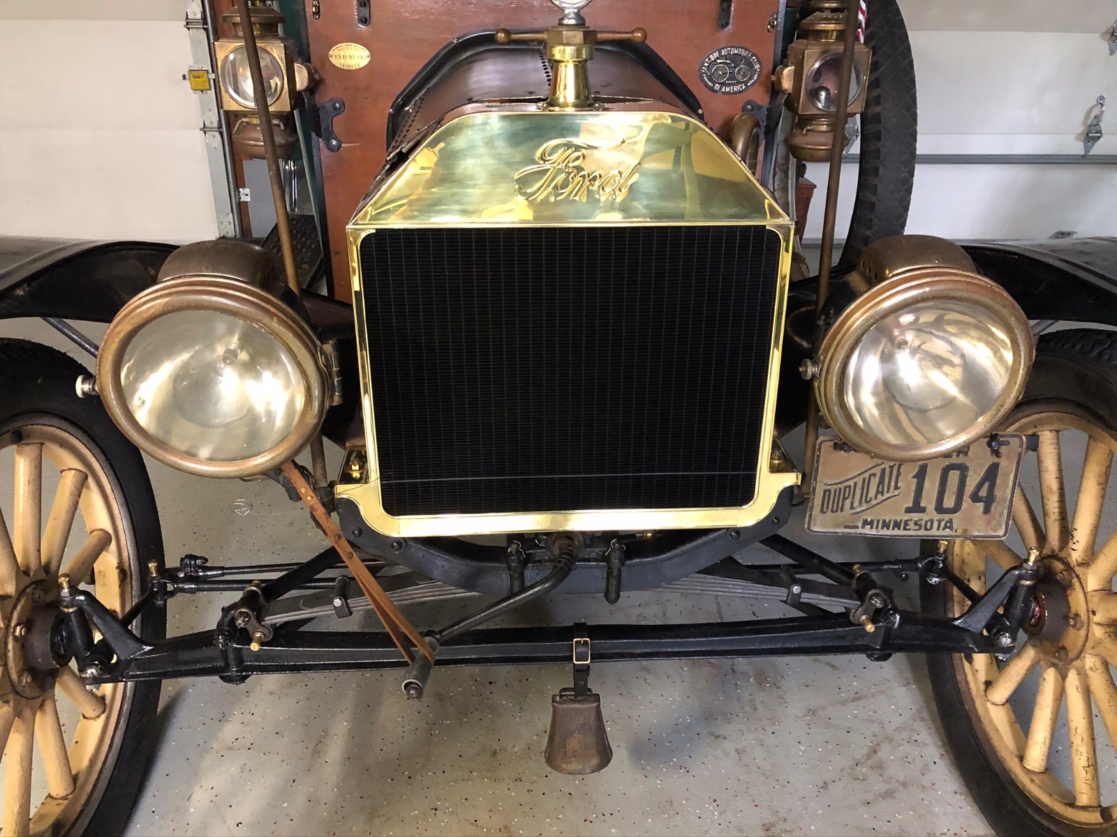

I’m with Steve J on this.....Rustoleum satin black with a brush is easy to use, durable and touch up blends in nicely.
