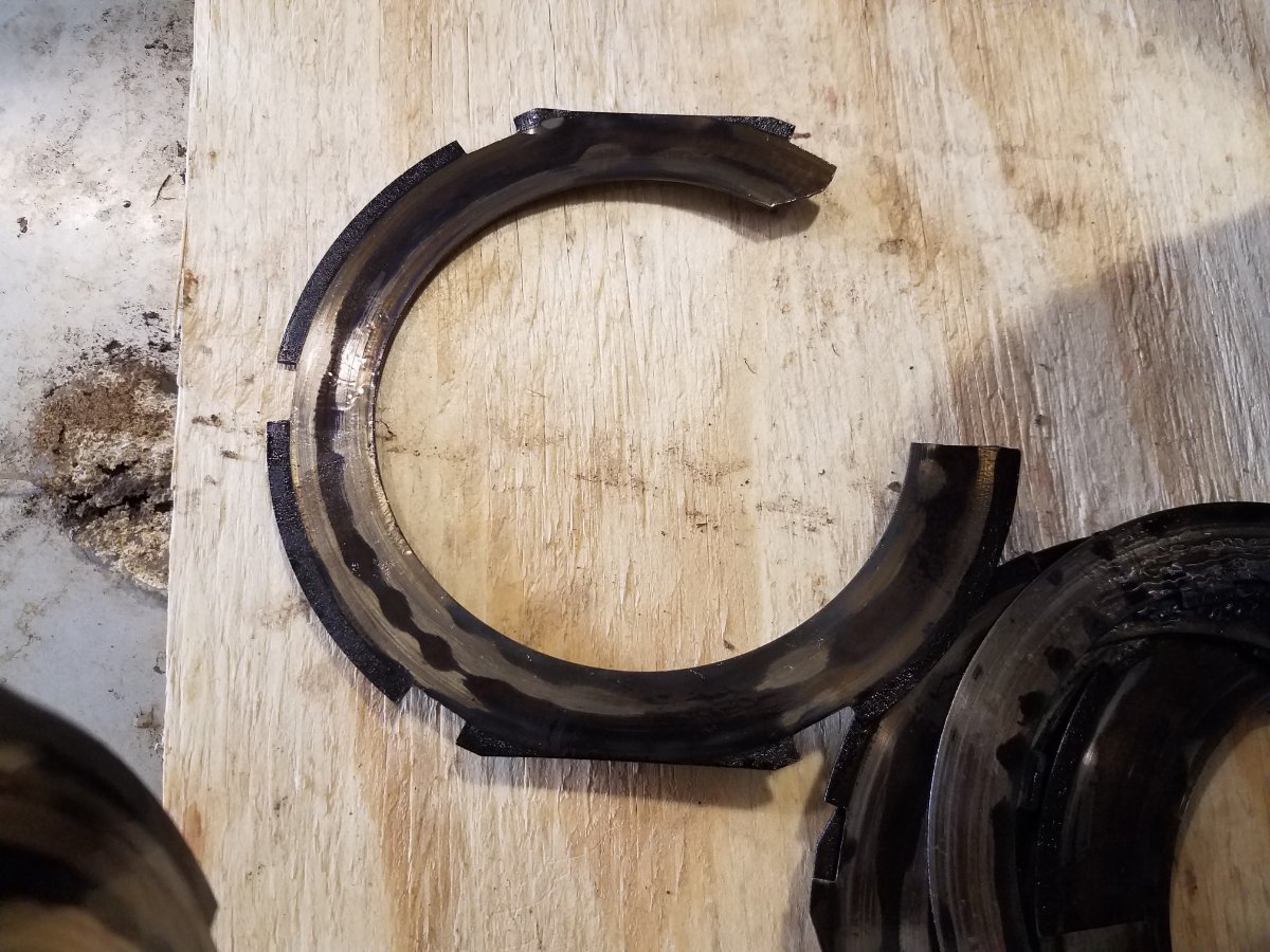

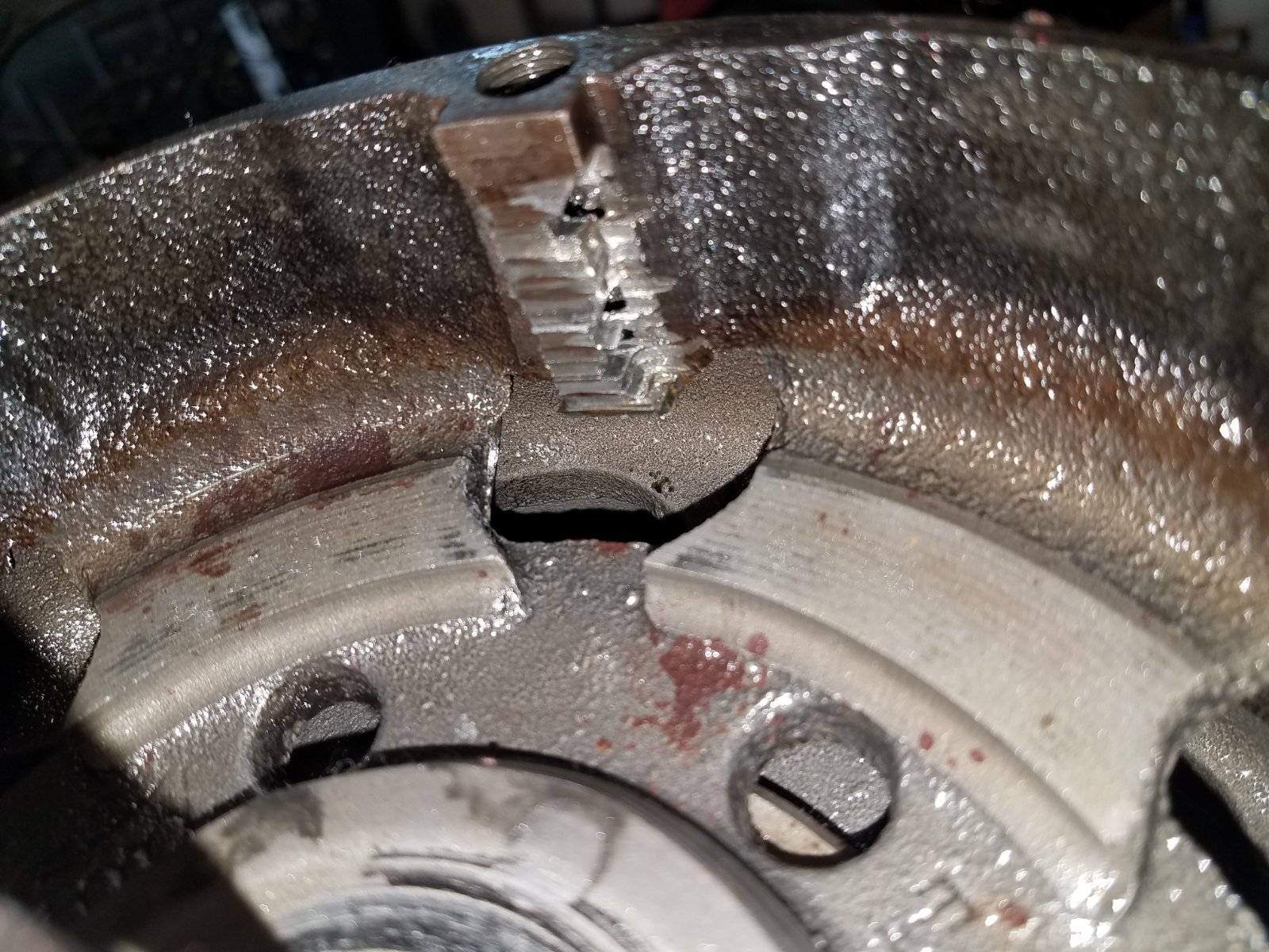

Pulled apart my transmission today... Had a cracked brake drum in two places. Ordering a new one.
Showing pics of old brake drum:
Outside of clutch basket:
Inside of clutch basket:
Over half the clutch disks were either cracked or broken. Ordering Watts disks from R.V. Anderson.

Clutch disks examples:

The clutch discs were cracked because the brake drum lugs are all chewed up. About half of the large plates in the transmission in my 23 runabout were broken too. The watts clutch works well, but with your new brake drum and some replacement original steel plates the stock clutch will work just as well. Save you a little money. :D

The stock clutch, properly adjusted, with a good used spring (95 to 110#’s at 2”compression) will not slip and is nice and smooth. It also protects the engine and drive-train from unnecessary shock loads...

The spiral mark on your clutch basket is most likely a manufacturing mark and harmless. BUT, given the nature of all the other damage you've got, check it out to be sure. Clean it up and see if the spiral continues down in and through the slot, as a crack would do. I think you'll find that it won't, but again, check it out.
And yes, this would explain the rocking back & forth when you stop.
