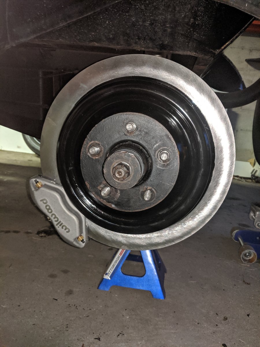

It takes awhile to get past looking at the big discs inside the rear wheels. After that, it’s comforting to push the pedal and lock up the rear wheels with little or no effort. I went with Birdhaven, but the brakes sold by Kevin Nuebert (sp) look pretty good.

I installed the Sure-Stop hydraulic disc brakes from Texas T Parts (other distributors sell them as well) last summer and I couldn't be happier.
My 23ish Touring has a Ruckstell but only had the transmission brake so I had to do something. The price for the Rocky Mtn Brakes and the hydraulic brakes were comparable.
I live in Joliet, Illinois which has a number of drawbridges and associated hills, and often a LOT of traffic. Those things made me choose the hydraulic brakes; I sometimes have to stop on a pretty steep incline and I didn't want the worry of not being able to stop on a back roll
I have wire wheels so the discs are slightly less noticeable than with wood wheels. In fact have to point out the disc brakes every time a non-T person has admired the car. They just don't seem to notice.

I'm putting pennies in a jar for a set of Sure Stop disks. Anybody doesn't like how they look on my coupe with its original paint and "Patina."
Not my problem.

I have the earlier style Rocky's with cast iron drums on my 13 touring for over 20 yrs. and like them.....except when they get wet. When wet , I ride the brakes early to help dry them out when going down hill or approaching a stop sign. I have the internal brake band adjusted loose but can lock up the wheels by "stomping" on the peddle. I do not like driving in the rain. The earlier style Rocky's stop better in reverse than the later style. I can lock up the rear wheels when dry but must push very hard on the brake peddle. Just don't like the looks of disk Hydraulic brake's on Model T's.
Having only the two rear wheels to stop you.....a Boat Anchor may be a better investment. Smile!
