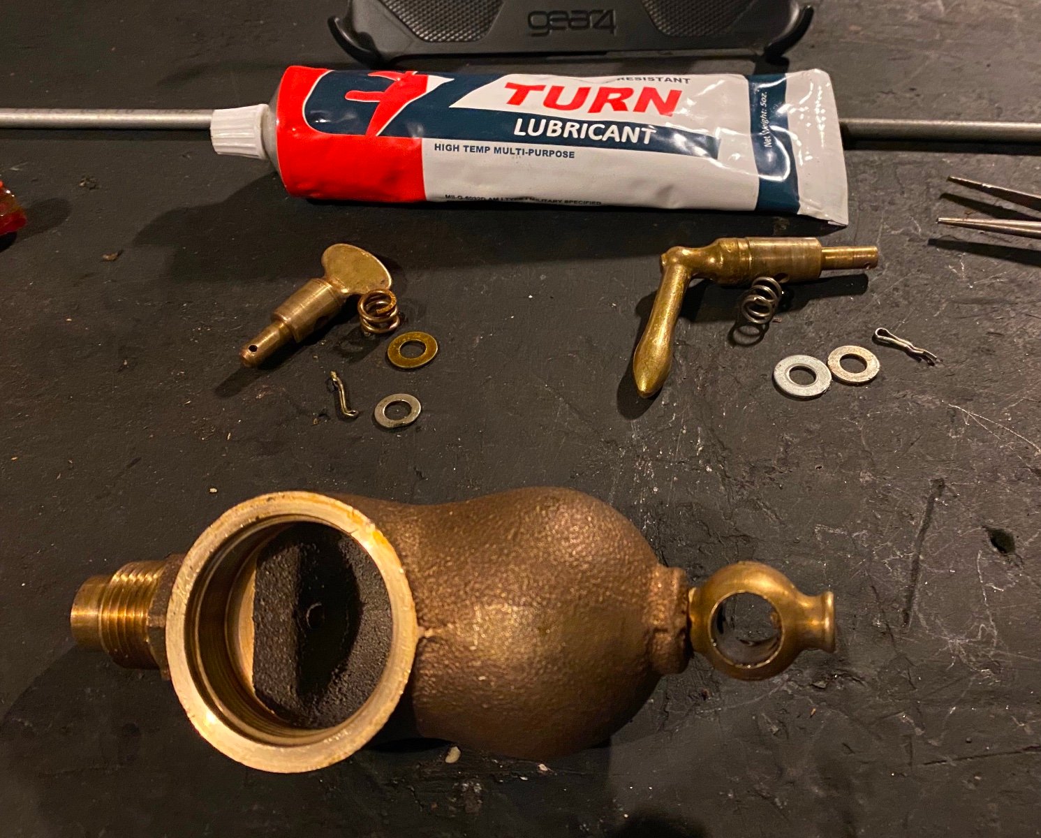

I recently started using EZ Turn instead of teflon tape. It's great stuff...aviation quality...specifically designed for fuel-related fittings. It's not cheap, and the smallest tube is gigantic, but well worth it if you work on a lot of old cars like I do.

Use the EZLube sparingly on the tapers as it can & will block the orifice to prevent full flow.

I didn't know that EZ Turn acts as a thread sealant too. I have a new sediment bulb for my Runabout and I need to find a sealant. I don't have EZ Turn on hand.

I agree. I used just the very thinnest amount on the tapers. I tested the fuel flow and it's great.

It sealed the threads perfectly.
As mentioned above though...it's important not to overuse it to the extent that it goops up because it's not fuel soluable and could possibly clog up a fuel line.
1924 Touring

I'm a big fan of Permatex #2 on NTP (pipe) threads, and EZ Turn on tapered petcock style valves (which is what it's designed for). I have no doubt it would work on threads, but chose not to use it in that fashion.

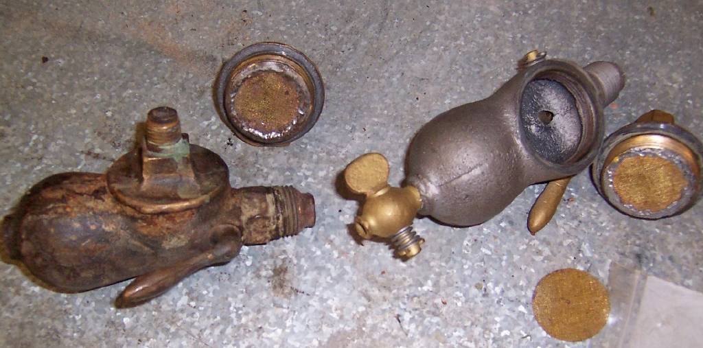

Believe Milford posted about the lever tool, (tubular sleeve with shoulder to prevent upsetting the end where the spring and cotter pin go, helps to remove the brass lever without much damage. If you try to twist the lever, rusted up, it will break!
Homemade version here, used like a punch. But before use, fully heat the cast iron bulb around the big center nut and around the brass lever, get the iron sediment bulb red-ish hot, then put the assembly into the freezer. When cooled down, the dissimilar metals will have expanded and contracted and the nut and lever can be easily removed. Then clean, repair the filter screen and add new lead washer and rebuild.

Really a good article - Note the large nut that holds the brass screen has/had a lead gasket. The heat you applied may have soldered the nut to the bulb. The freezer trick worked like a charm in removing the nut
