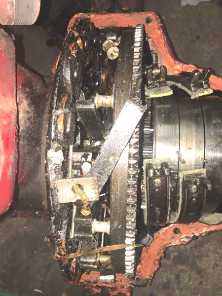

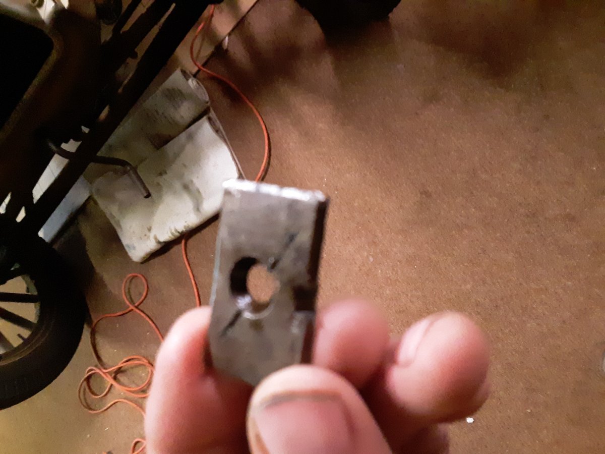

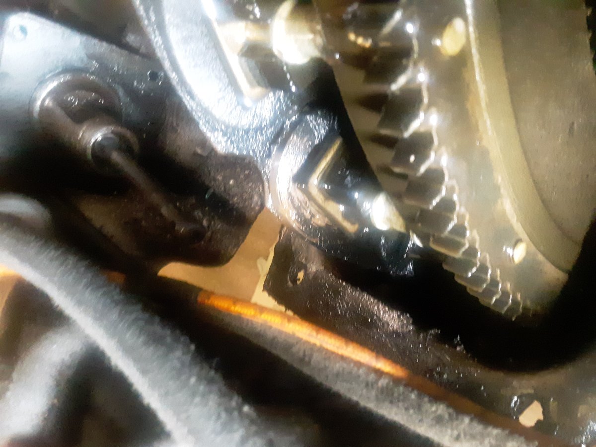

What is this ??

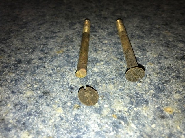

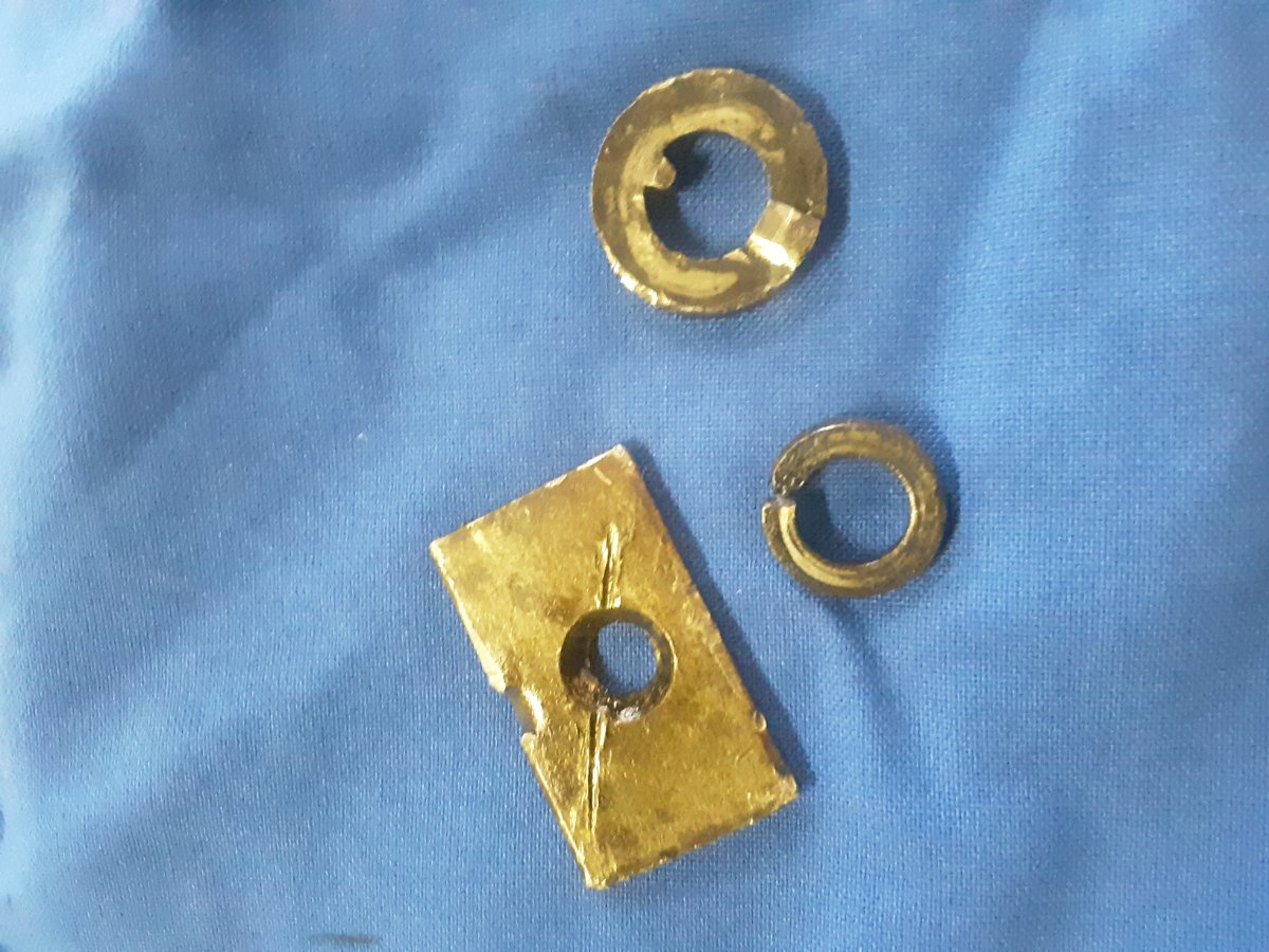

It’s a magnet clamp plate that fell off the flywheel. It would be unusual if it didn’t do any damage. There would be the head of a brass screw inside your engine too. Unfortunately, it is now time to pull the engine, remove the hogshead, pan, and transmission. Replace the broken part and look for additional damage.
Just leaving it the way it is and continuing to drive it is risking Thousands of dollars in damage...

Time to pull your motor. That is a magnet clamp the brass screw lost its head.

Take this seriously, a magnet coming apart will do a LOT of damage.

Take this very seriously. You are very lucky to have discovered this when you did. Under load, a magnet coming loose inside the transmission could shatter the hogshead like a bomb and not only destroy your engine but the resulting shrapnel could possibly pose a danger to the cab interior and those occupying it. Jim Patrick
- Posts: 4107
Re: What is this ??
Photo posted on forum earlier. A magnet loose at running speed will make big trouble inside

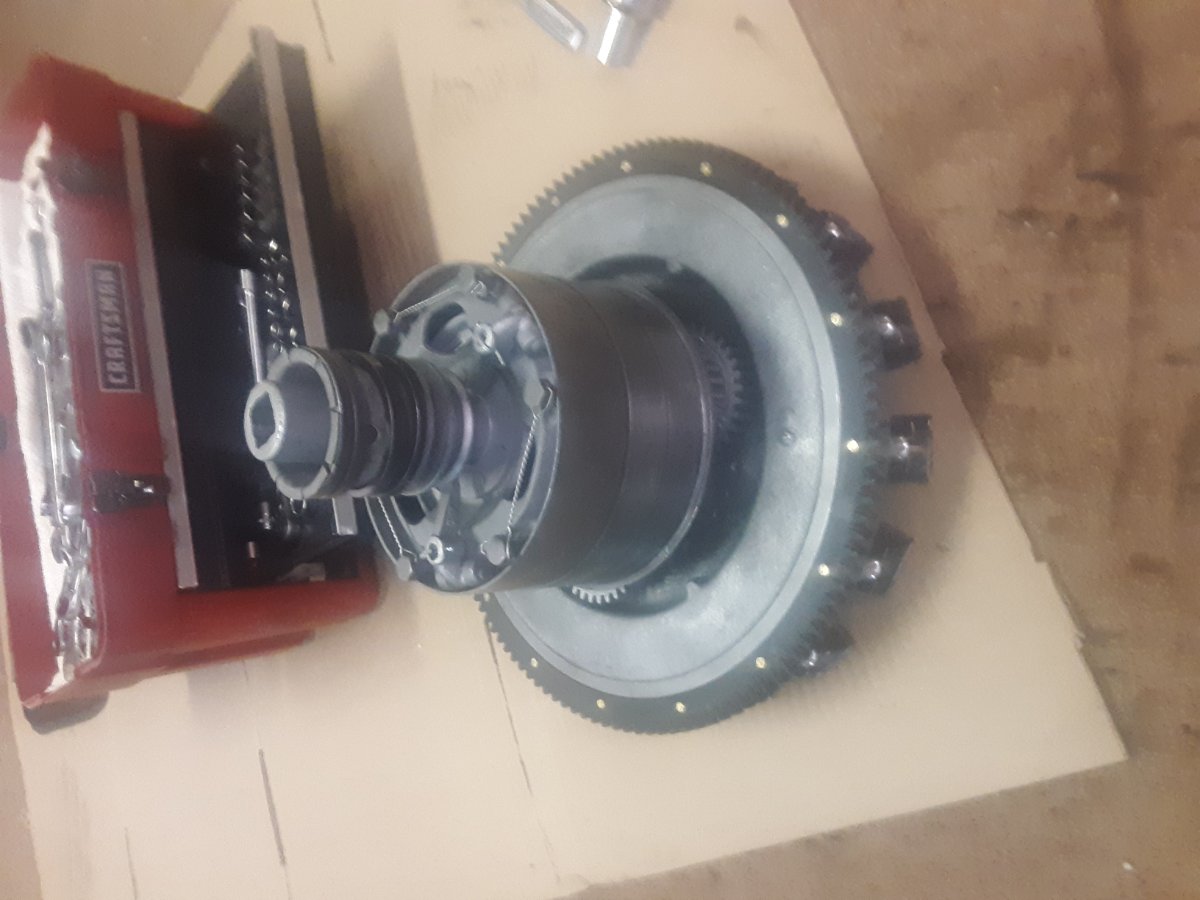

Ok. I got to figure out how to get the flywheel notch at the correct spot to take the starter off. Take the hogs head off and check out the repairs needed.
Ruxstel24
- Posts: 2425
- Last Name: Hanlon
- Location: NE Ohio
Re: What is this ??
Did you take the drive/bendix off ??Larry e rutt wrote: ↑Thu Feb 13, 2020 6:48 pmOk. I got to figure out how to get the flywheel notch at the correct spot to take the starter off. Take the hogs head off and check out the repairs needed.
It’s a lot easier to disassemble with the engine out...and it HAS to come out.

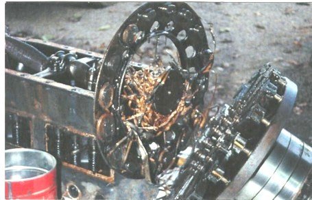

Re: What is this ??
Larry
Follow Adams advice or you will facing this.

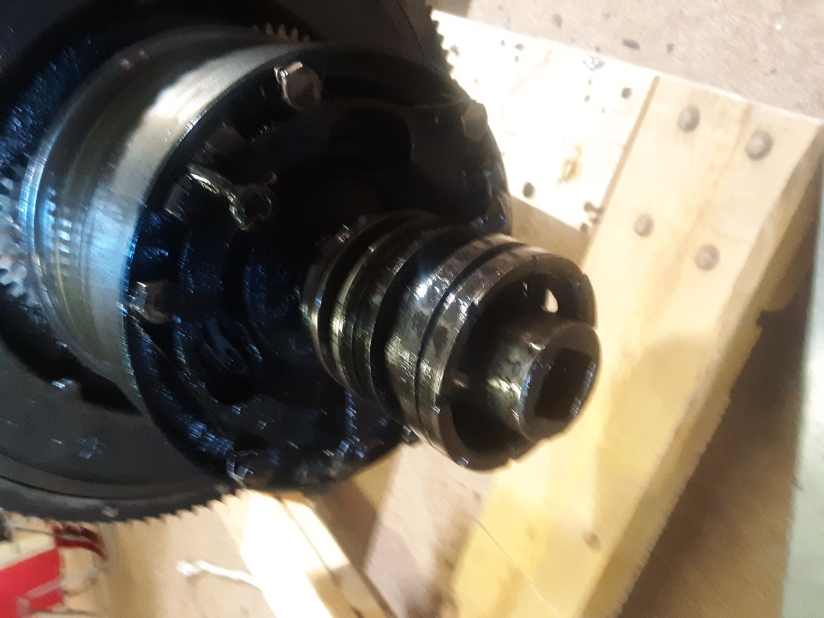

Re "the flywheel notch at the correct spot to take the starter off." The notch is in a fixed location on the coil ring, see note above about taking off bendix first.
Larry e rutt
Topic author - Posts: 154
- Joined: Wed Jan 09, 2019 4:52 pm
- First Name: Larry
- Last Name: Rutt
- * REQUIRED* Type and Year of Model Ts owned: 1926 fordor
- Location: Ephrata pa
Re: What is this ??

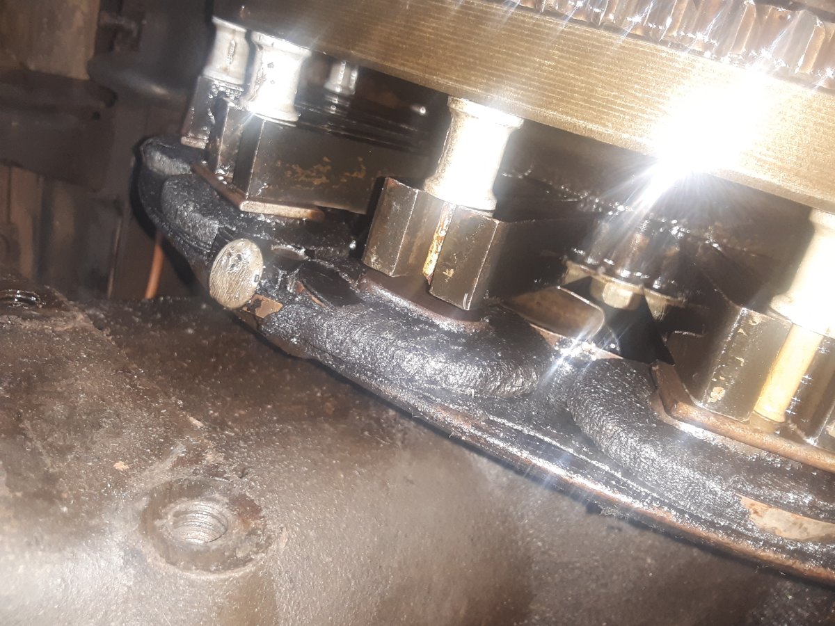

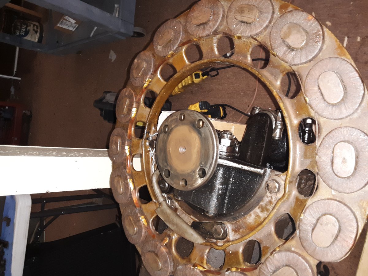

Ok it didn't take me long to figure out the starter notch.. I got it apart, when I think back the first oil change I did when I bought the car was a year and a half ago and the brass head was in the oil drain plug.. That means it been hanging together at least that long..what I was going after is the low pedal notch. Got that all apart went pretty well, about 3 hours..Now this mag thing popped up.. What are the odds I put it back together and it runs another 20 years ??? I dont disagree it should be rebuilt but next thing you know I won't have my T for the summer... decisions, decisions decisions

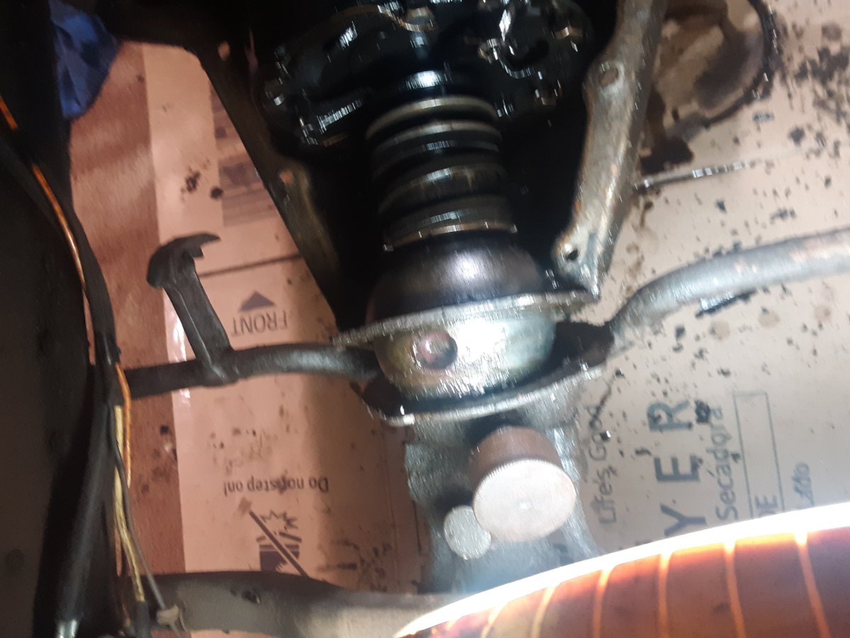

Re: What is this ??

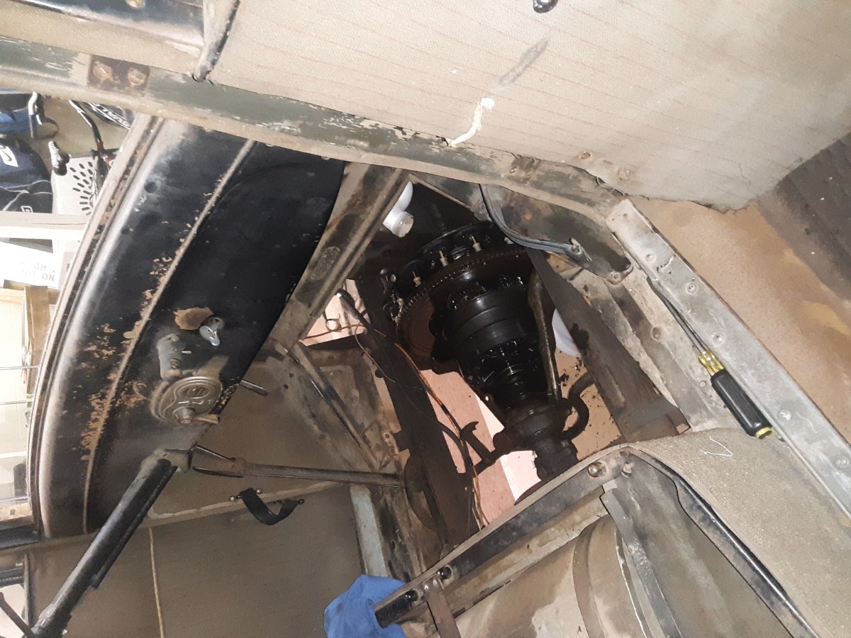

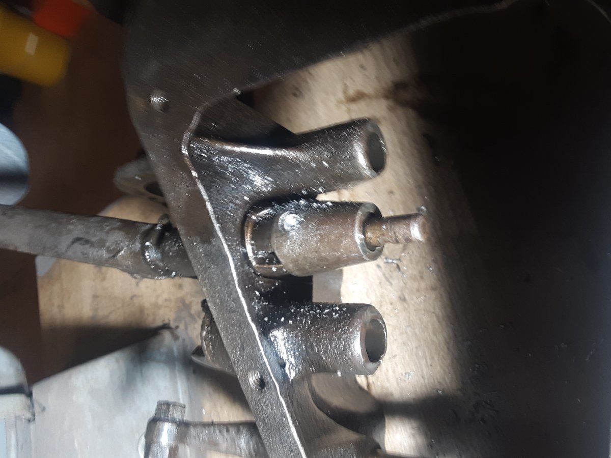

My low speed pedal I could move 2.5 inches before it engaged , the pedal hit the metal floor ( with out the floor boards in ) .. can't imagine how they wear like that being in oil ?
- Posts: 5605
Re: What is this ??
Are you attempting to drill out the pin holding the low pedal notch ?
You might strongly consider the consequences of what IS going to happen if'n you don't repair the problem as most folks here are offering sound advice !!!

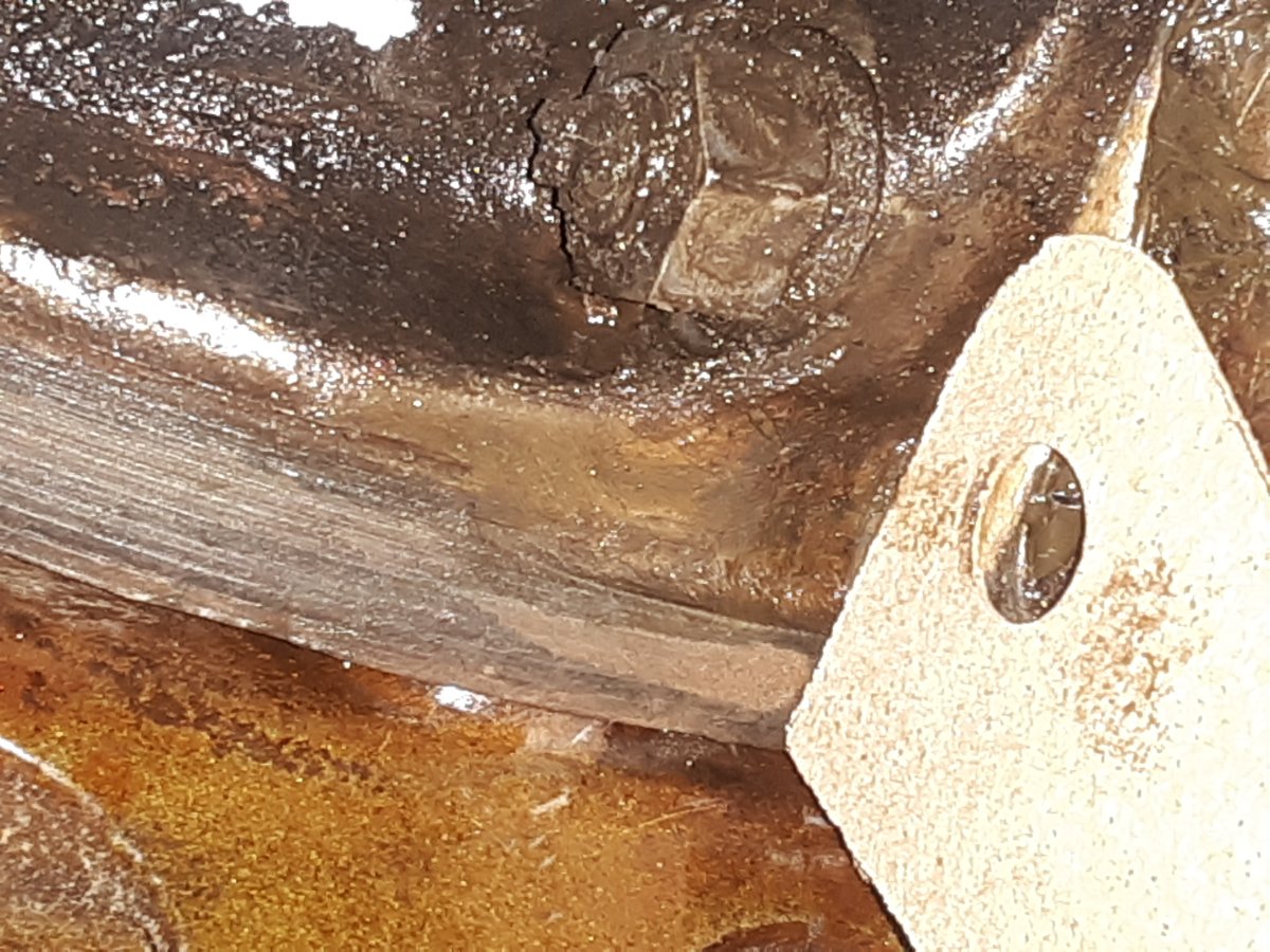

Also... In the picture of your low speed notch, you had questioned how it could have worn that much on the inside with plenty of oil? The answer is that it probably hasn’t... The low pedal needs to travel maybe 2”-3” forward BEFORE it hits the ramp and begins to engage the low band. That first 2”-3” engages neutral. If you “repair” the cam and notch to have zero play, you will not have neutral at the pedal, only at the hand brake lever. Also, most of the repro low speed cams and notches have zero to very little pedal travel for neutral and require very careful repeated grinding & fitting to producers the proper amount of pedal travel before engaging low band.
Larry e rutt
- First Name: Larry
- Last Name: Rutt
Re: What is this ??
Ahha... your right
- Posts: 7309
Re: What is this ??
Adam, you are absolutely correct in that there needs to be some play between the ramps on first gear. In my first attempt to rebuild the ramps on a RHD pedal, I eliminated that play, and had to re-introduce it! 2-3" seems a little excessive though. I would have thought 1.5" would be sufficient, bearing in mind that as things wear, the gap/pedal travel increases anyway.
I was not aware that new first gear ramps and notches did not give the required free play. On our RHD cars these are used on reverse and the brake pedals, where you don't want play anyway.

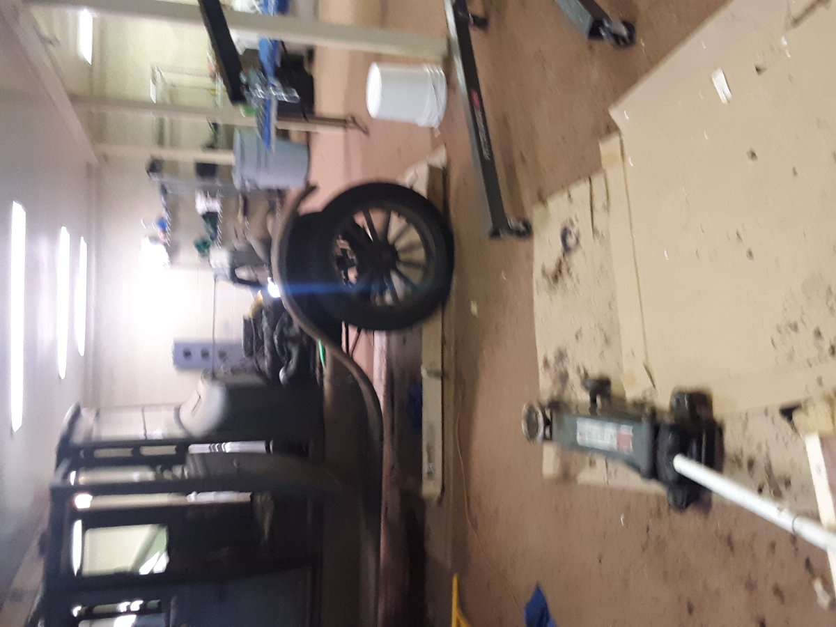

Re: What is this ??

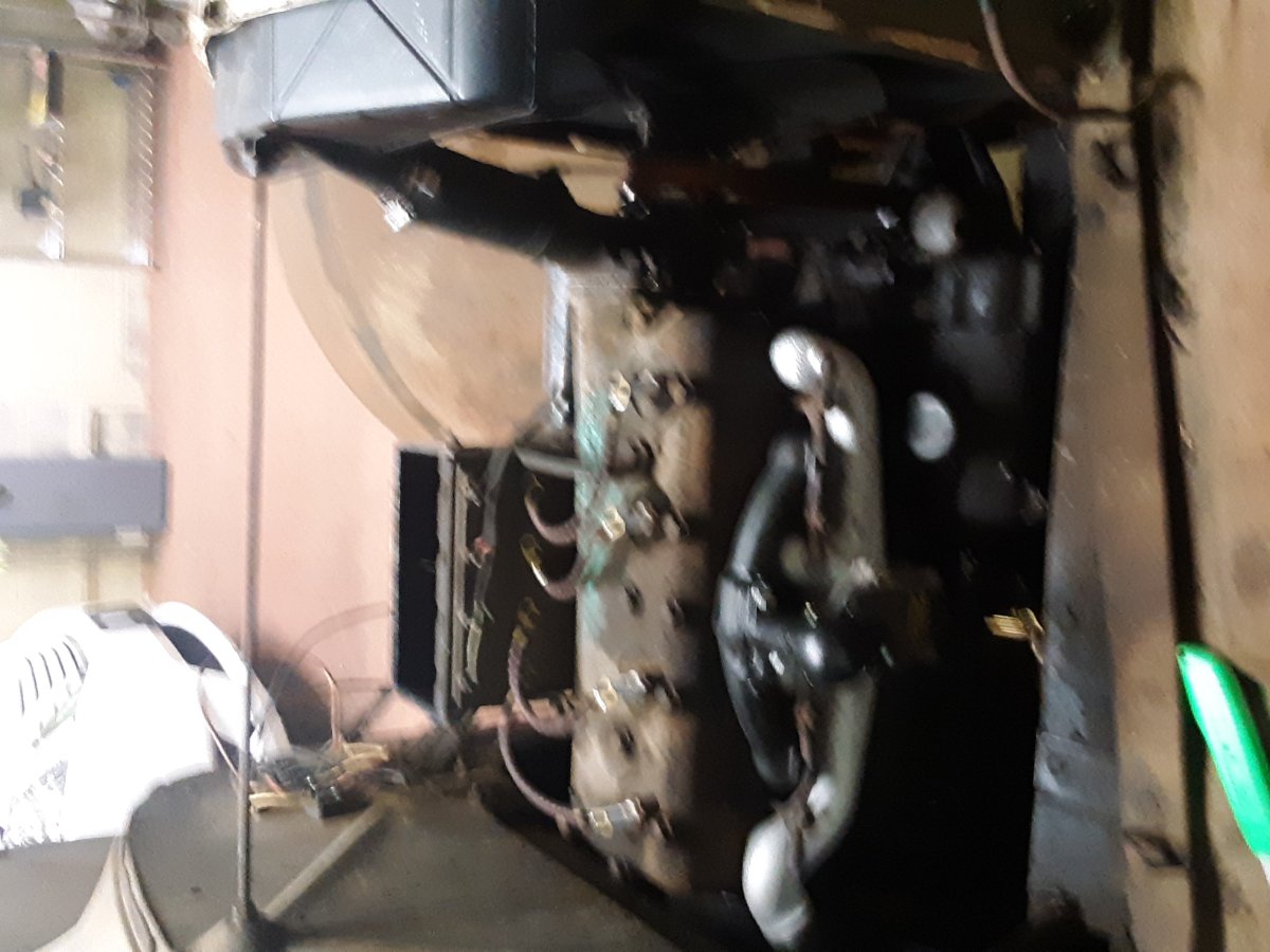

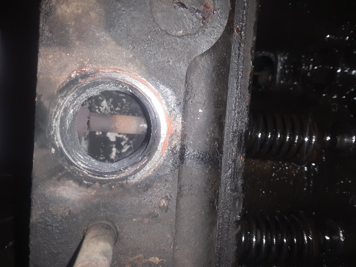

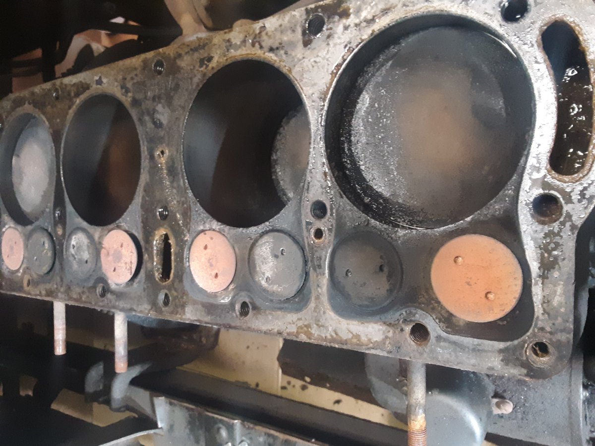

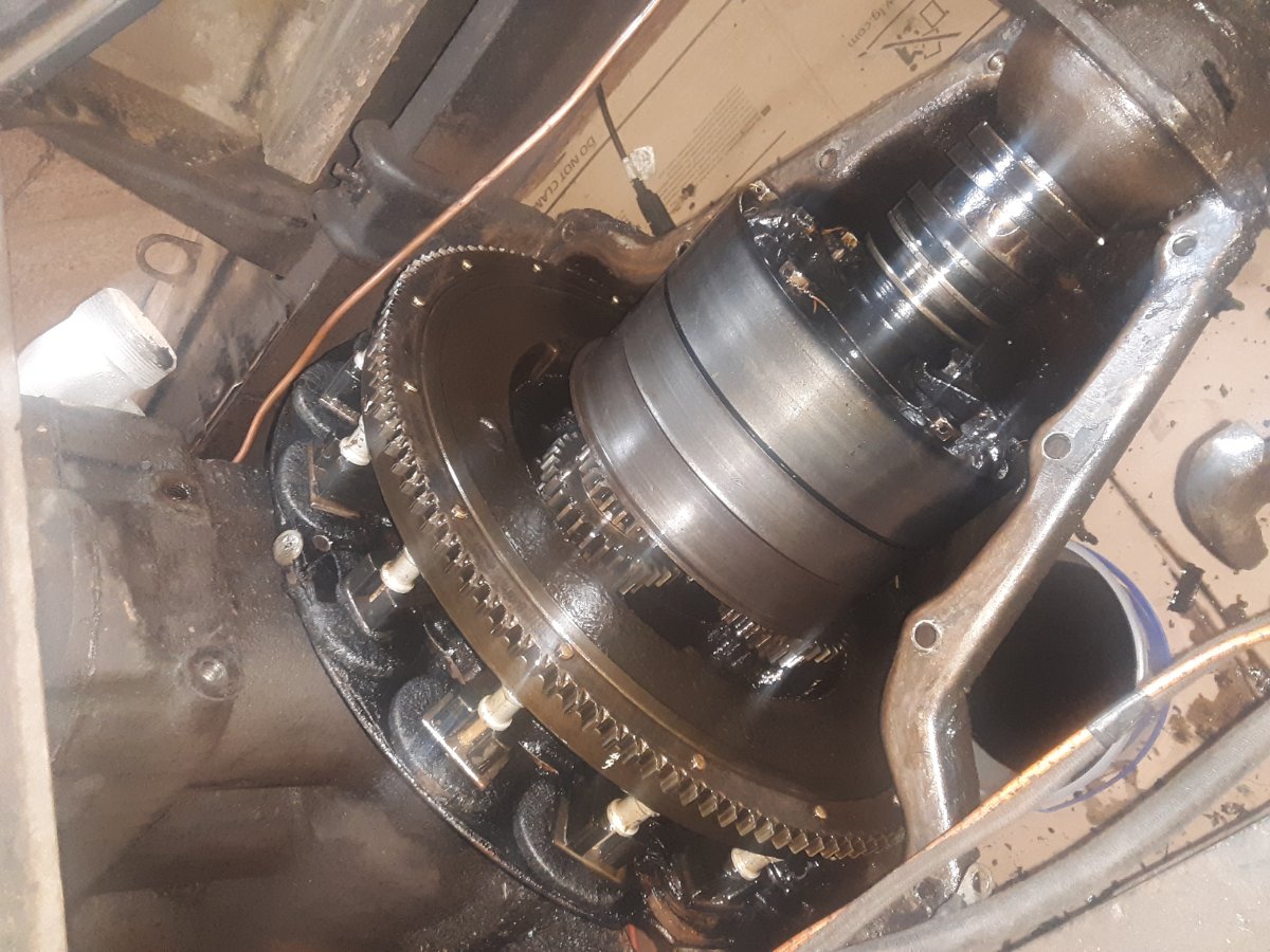

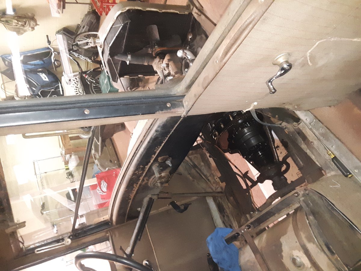

Alright, the tear down is underway...will this ujoint pull apart ? What do you think of these valves ?? ( new or old )
- Posts: 5568
Re: What is this ??
Valves old 2 piece need to be replaced.
https://www.google.com/search?client=fi ... ece+valves
Ruxstel24
- Posts: 2425
- Last Name: Hanlon
- Location: NE Ohio
Re: What is this ??
U-joint: yes, should slip out.
Valves: appear to be 2 piece, recommended changing.
Good news is it looks like all the cylinders were firing good.
I think if I was this far into it, I would at least look at the crankshaft bearings, but a minor refresh may be all that’s necessary, along with the flywheel of course.
You’re doing good so far !

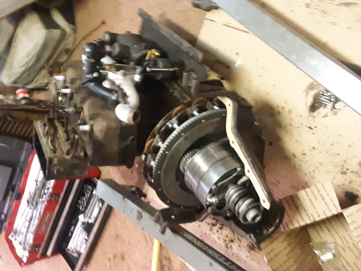

- Posts: 7309
Re: What is this ??
Old two piece valves have those two holes in the head to accommodate a tool used in lapping them in. However, many replacement one piece valves also had the two holes, and can be re-used if good. Look in the ports to see if the head is a separate piece to the stem.

Looks like time for some nickels too! ( soft plugs )

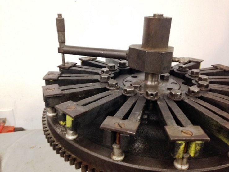

I know you’ve already made the decision to tear it down, but just to bolster what Scott said above about the brass screws becoming unstable....
I elected to replace all the brass magnet screws on the engine I’m running in my T now even though none of them had lost a head. On a few of them, just the slightest amount of pressure caused the screw head to pop off. In other words, they were very weak and the likelihood that they would’ve come apart was not small. I use my mag every time I drive my car and do it with a higher degree of confidence than if I’d hadn’t.

Re: What is this ??
Here is what happens when r going down the road and you get a piece of dirt at the mag post and switch it back to battery on the fly... isn't this awesome..

Here is what happens when r going down the road...
I had fun with the '54 Plymouth, shutting off the ignition and turning it back on. BANG! Luckily I was smart enough to figure out the folks would find out if I destroyed the muffler, so I quit that game before it went that far.

Re: What is this ??

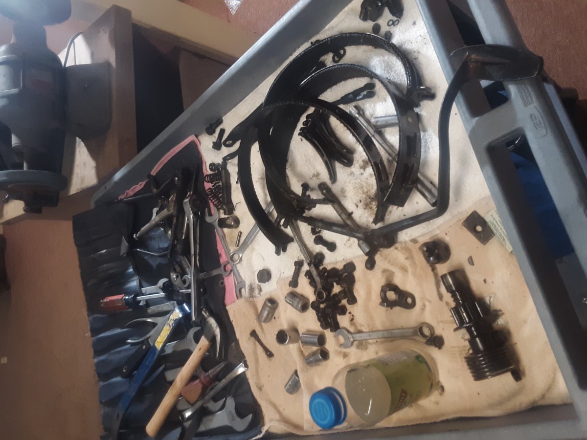

So these washers were in my pan.. and the and the mag spacer in my bendex somehow...but now I have no idea how this animal comes apart..

That's too bad. Someone left you a "gift" with the band washer and who knows, but it may have taken one or more of the magnet keepers off for you.
Buy the manual and MTFCA booklet on the transmission or better yet, send it to someone with experience and a history of transmissions that have completed a number of tours faultlessly. There is a good deal of inspection and likely machine work ahead, not to mention one-off specialty tools and fixtures needed. For a single transmission job, you'll be far ahead of the game doing that rather than purchase everything you need and trying to farm out individual aspects of the job.

Why would the transmission and engine need to be completely overhauled just because of the brass screws? Take the 4 bolts loose holding the transmission,determine which brass screws as far as size were used,and put them back in all the way around and replace the transmission on the shaft and check clearance and when finished reassemble?

Re: What is this ??
Larry
Here is a photo of the first thing that failed. The rest is consequential.
But, I cannot figure how the band adjusting flat washer and lockwasher got loose inside the engine.
Ron
Ron

Mack
That would be one way to do it, if you didn't inspect for cracked magnets or replace 100 year old aluminum spools AND were young enough to lift the entire transmission/flywheel off of the crank a bunch of times while setting the mag ring/keeper gap AND the triple gear pins and bushings were in perfect shape.
Myself, I'd pull the drums for that work.
Pulling the drums, and setting mag ring and magnet height typically require specialized tools.
But you're right, replacing one keeper (or all keepers) doesn't require a total transmission or engine rebuild. Only inspection will reveal the extent of repairs that would be prudent. What is prudent to one person is rediculous overkill to another, and I understand that.
The only thing I know about this car is that it might have 2 piece valves, and it ran for a good while with several pieces of loose metal in the bottom of the transmission and that in itself requires careful investigation. But that's just me.

My guess is a previous owner dropped them in at some point and chose to just replace them and hope for the best.Ron Patterson wrote: ↑Mon Feb 17, 2020 6:04 pm...I cannot figure how the band adjusting flat washer and lockwasher got loose inside the engine...

Thanks a ton guys...the triple gears wiggle, the drums slide back and forth about 3.16th of an inch, the gears can actually hit the drum..I think I'll have someone take a look at it... the wealth of knowledge on this forum is amazing...thanks again.

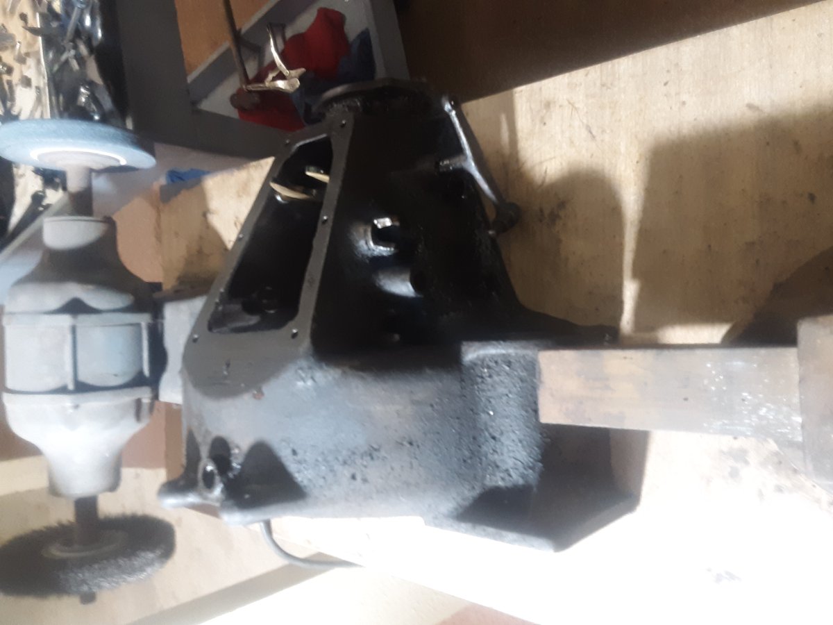

Yeppy... got my trans back and I'm ready to start going back together...

Okay. It's a rainy day here in PA. It's time to bolt the transmission to the crankshaft. There is nothing unsafe about using lock washers there correct?
Tim Rogers
- Posts: 387
- Last Name: Rogers
- Board Member Since: 2013
Re: What is this ??
I recommend using the correct bolts (no washers) and wire tie them.
Are you able and prepared to set the clearance between the magnet clamps and coil ring? This is very important. Did you check crankshaft end play? Too much travel and you'll have problems.

I did set the clearance..as mentioned on another thread, i checked between the mag ring and the block with the bolts loose....035 the whole way around..worked like a charm....035 between mags and mag ring...I need to work on my wiring.... it looks like I did that one in my sleep..I'll try thinner wire.

So when putting this thing together. I saw this we're at the very corner of the hogshead. Is that supposed to be like that?
