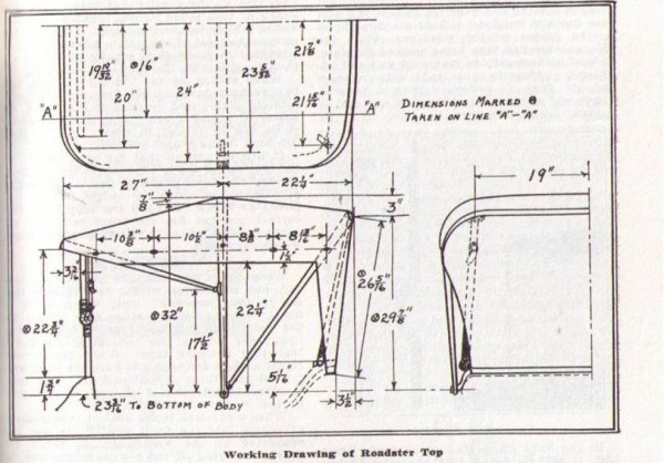

Maybe this will be of help.

Thank You all that's just what I needed

You need to use that drawing and set up your bows so they're correct, but measure on both sides of the car!! You want the car to be on a nice level surface when you do it.

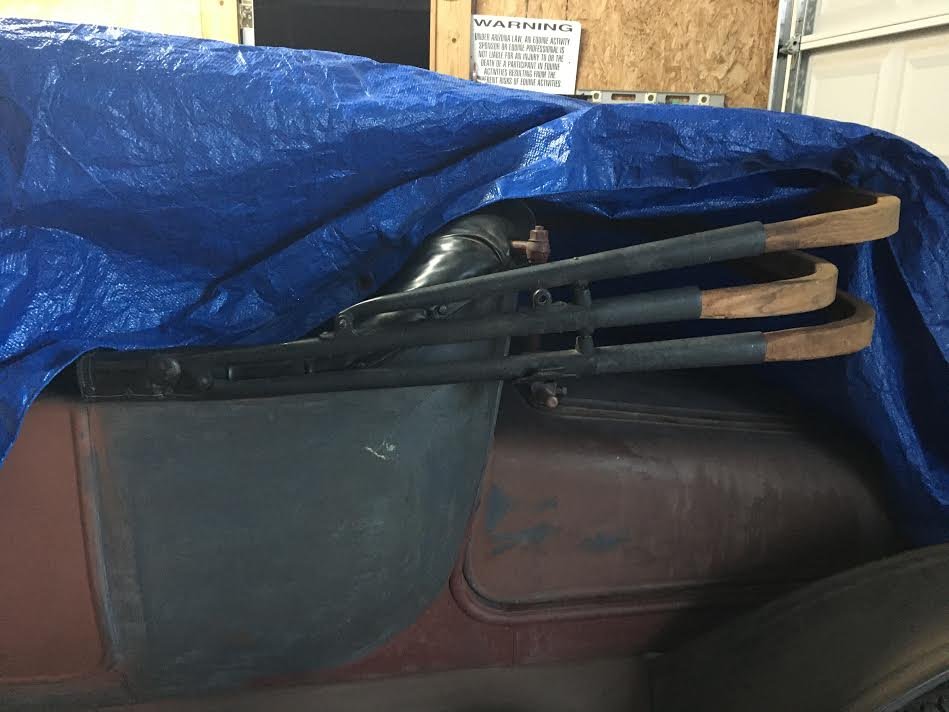

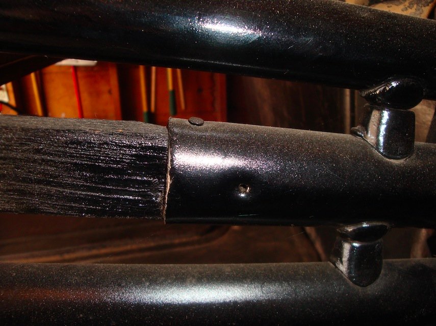

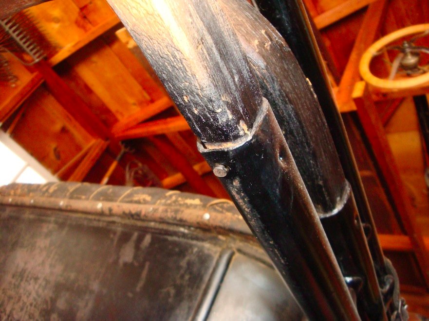

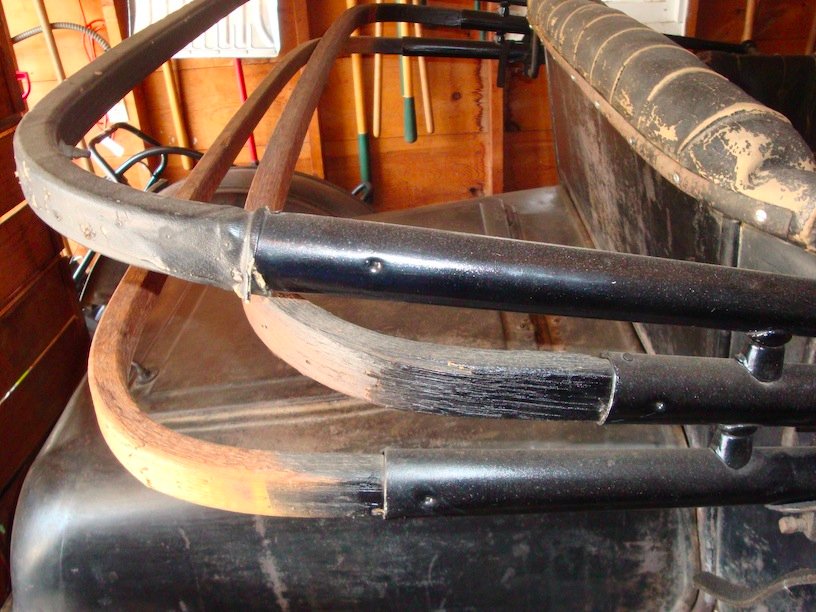

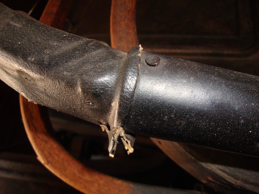

Here are some photos of 1915-17 roadster top sockets and bows for you.
This is one of two sets that I have and the construction of both sets is the same. One set is the original from my unrestored 1917 roadster but they are in rough shape so the set shown is what I currently have on my car.
Each bow is initially held in place in its respective socket by a single nail.
When the top material is installed, there is also a husky, large head upholstery nail through the side of the top and into the side of the socket.
First photo: front bow in the down position
Second photo: middle bow in the down position
Third photo: back bow in the down position
Fourth photo: notice the holes on the side of each socket. These are for the upholstery nails that are used to fasten the sides of the top to the socket.

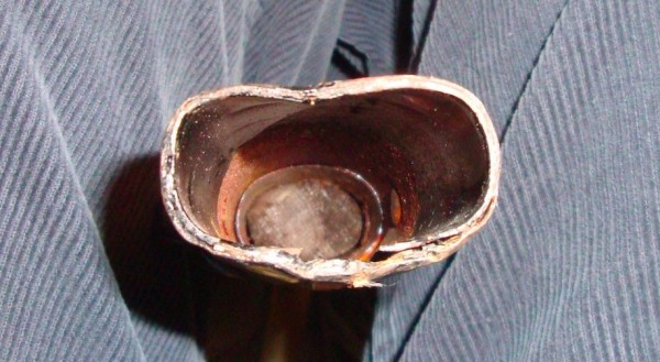

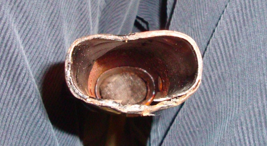

Fifth photo: this is an NOS middle roadster socket with original factory paint that I have in my possession. It has neither nail hole mentioned above because it has never been used. As R.V. Anderson described above, there is wood inside the bow, it starts about 5 3/16" from the top of the socket. There is also a sheet metal shim around the wood that can be seen in the photo.
There should be no reason to seal any gaps between the socket and the wood bow. First of all, there already should be a snug fit. Second, the bow drill covers the top of the socket. Third, the sides of the top extend beyond the top of the socket. All three of these should prevent water from entering the socket.
