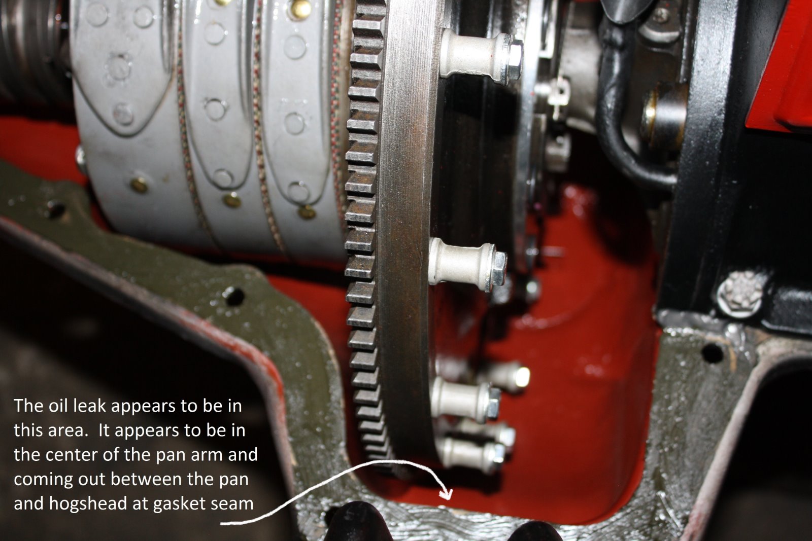

Dan ,There is no mag ring, but the oil leak is on the side of the hogs head. Its leaking between the hogs head and crankcase directly below the bolt that goes thru the frame, crankcase arm, and wooden block. I think it is the paper gasket and not a cracked hogs head. Everything was cleaned and inspected very well. The crankcase was straightened on my KR WIlson pan jig and then tested on 2 more KR WIlson pan jigs to test the accuracy of my pan jig, since this was the first pan straightened on my pan jig. It tested good on all 3 pan jigs. It may be the paper gasket just split or blew out.

Donnie like Dan said if you did not put the lower mag ring bolts back in after removing mag ring it will leak like a oil well,I have ran into this two different times ,I cleaned the holes with brake clean and put ultra black silicon and it stopped leak

Donnie, I just went through this problem on my 14 touring after an engine rebuild! Couldn't stop the leak any way I tried. Finally, pulled the engine back out and found the top of the pan in the area behind the arm had a lengthwise dent about 2 inches long. There was not enough area on the edge of the pan to seal allowing oil to seep past (the edges of the pan were straight, just the center was dented). I first though the problem was the rivets attaching the arm to the pan were leaking but close inspection showed the oil was seeping over the edge of the pan. Mike Bender and I decided there was not a quick fix so Mike dug out a good pan for me. We didn't throw the pan away (a four dipper) because thought we may come up with a fix in order to save the pan. Installed the replacement pan, no leaks (THANKS MIKE!!!). Mike said this was only the second pan he had seen with this problem, maybe you have the third one!

Post by dobro1956 » Tue Apr 21, 2020 1:34 am
Here is a picture of the area of the leak. It was taken just before I put the felt seal on and set the hogs head in place.

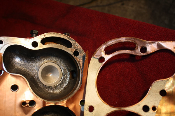

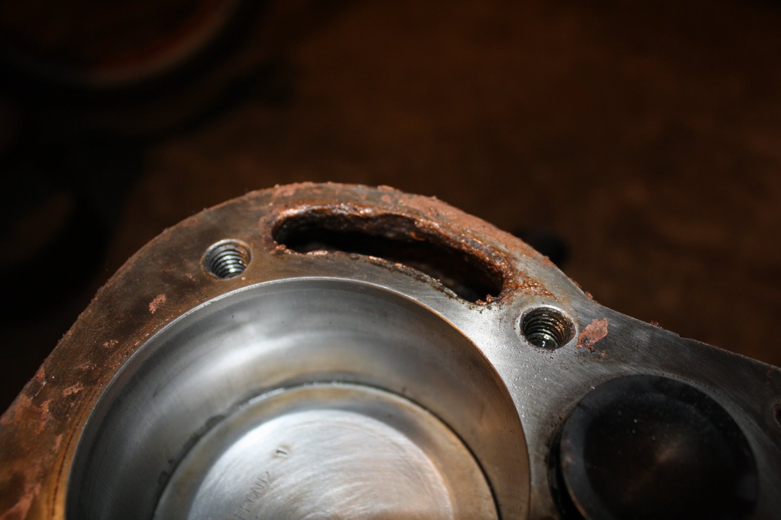

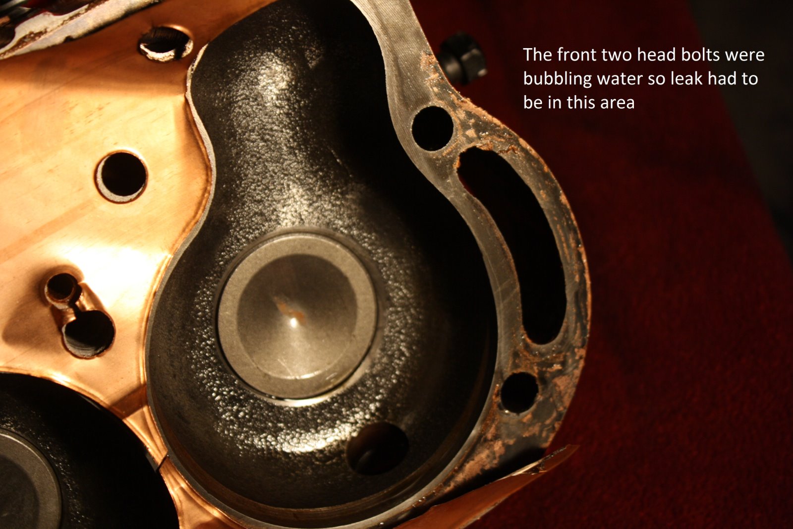

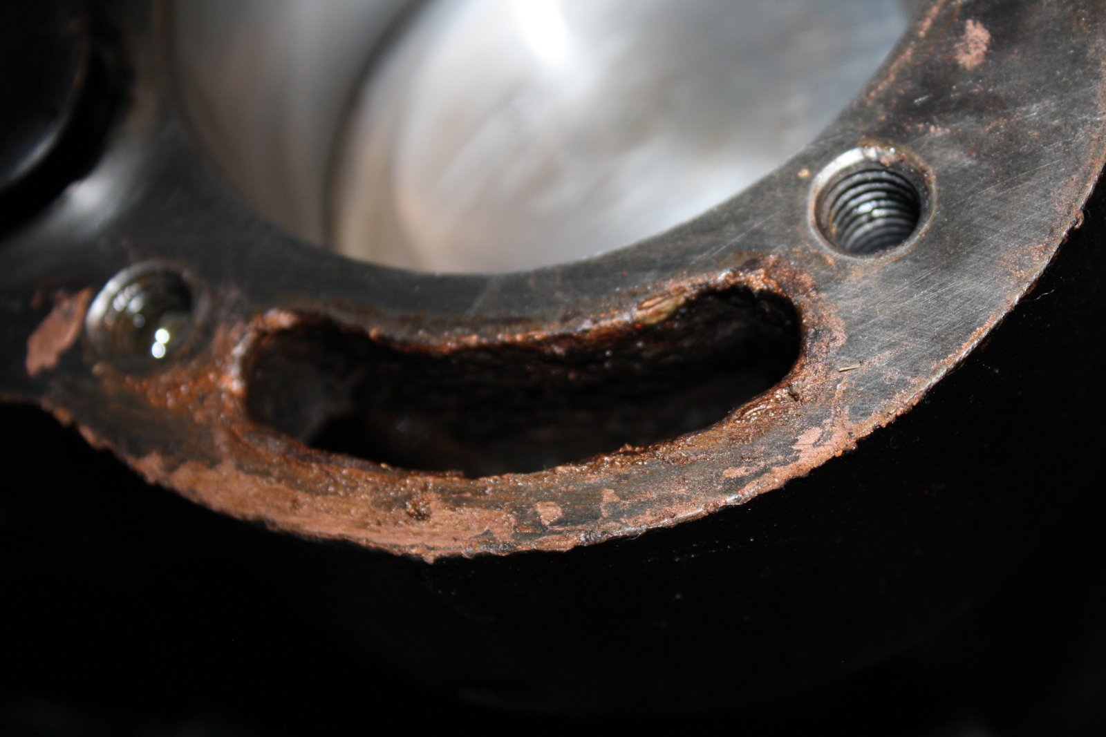

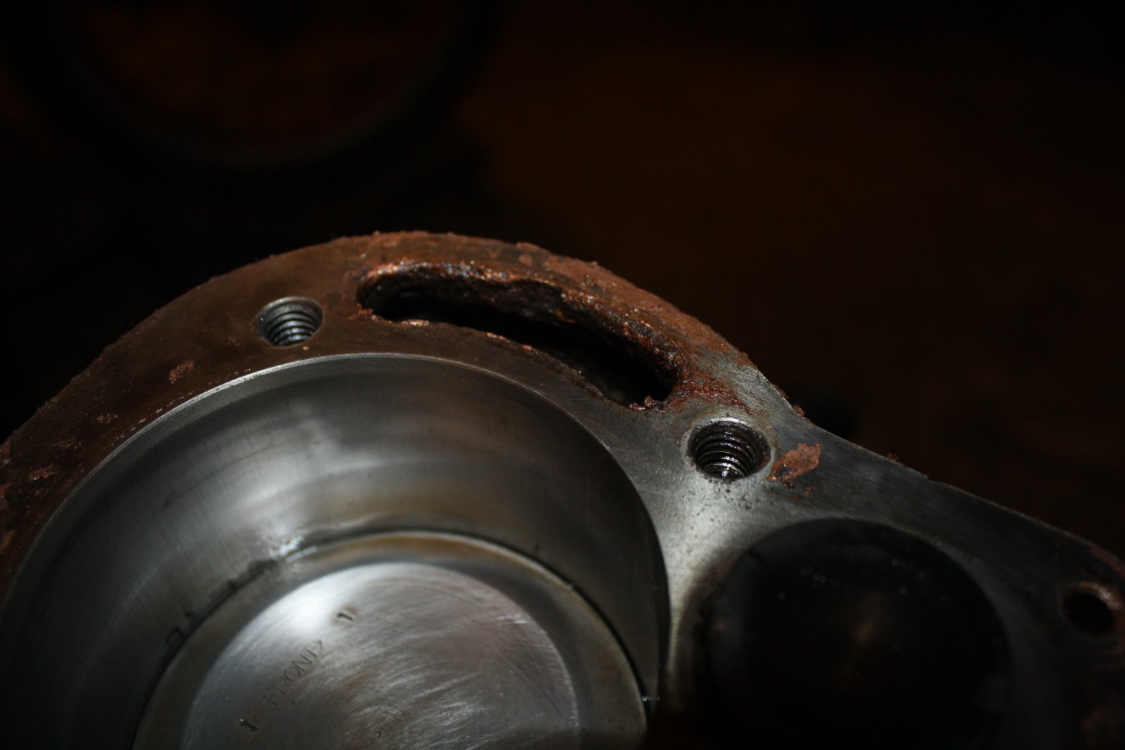

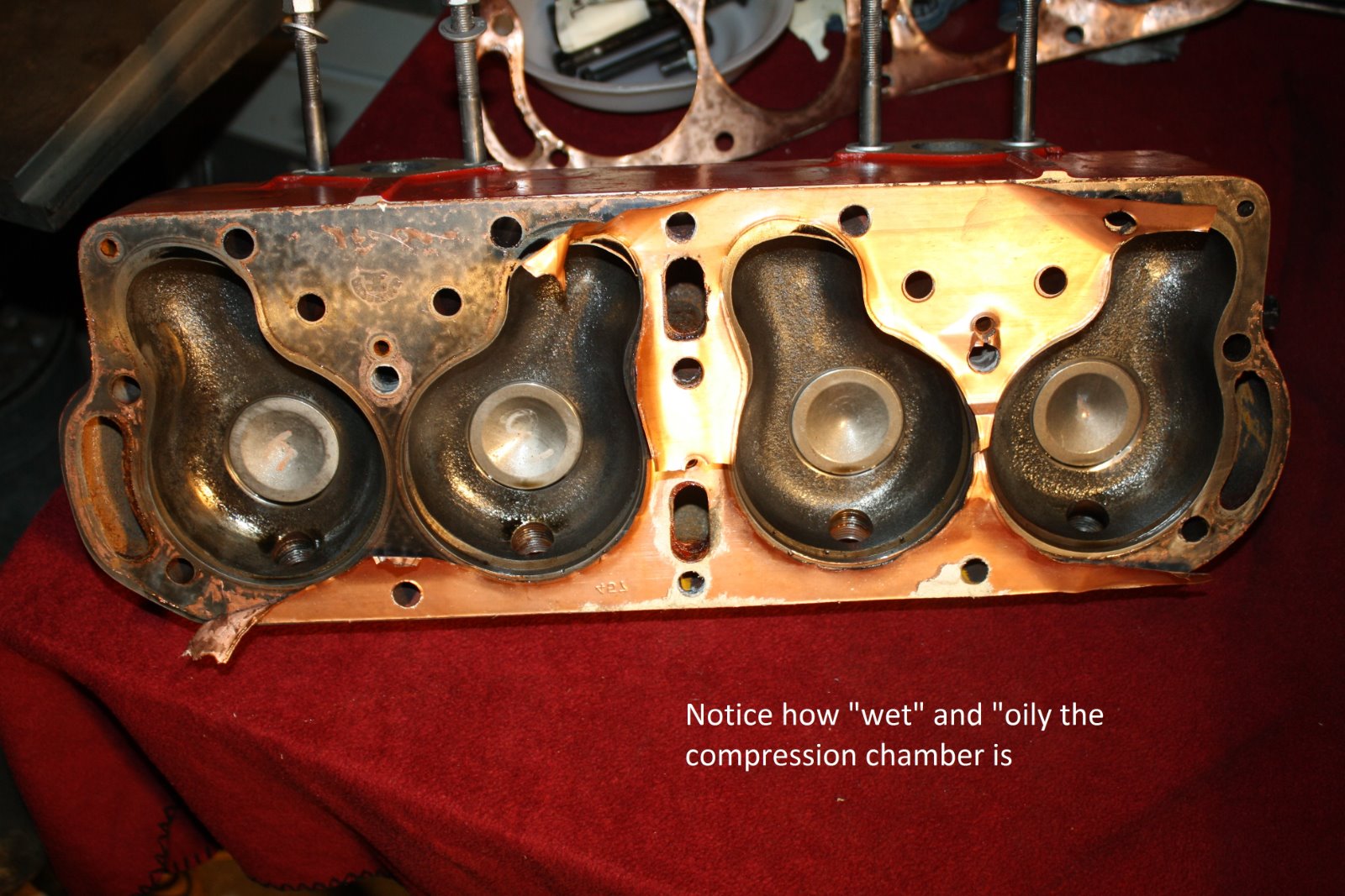

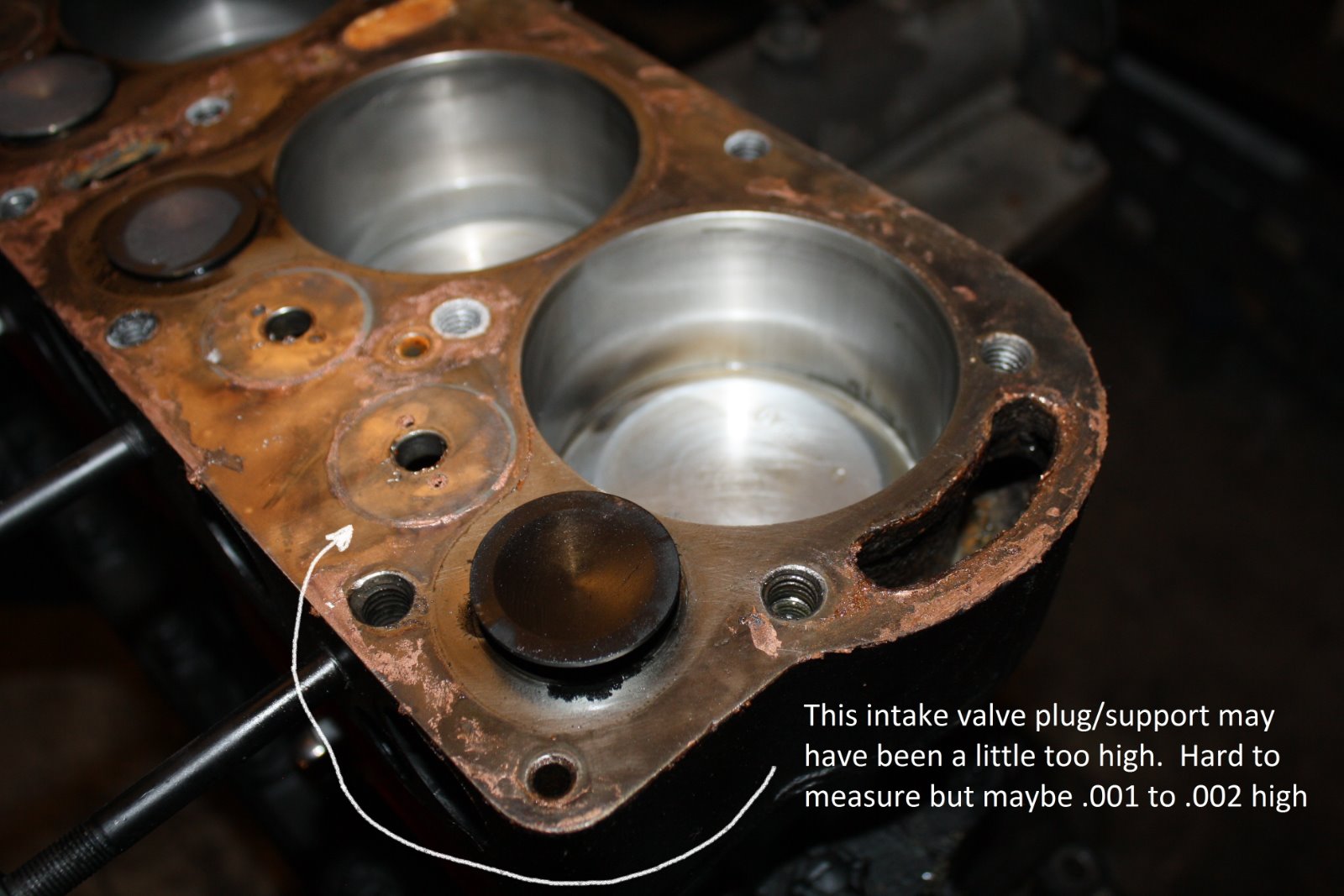

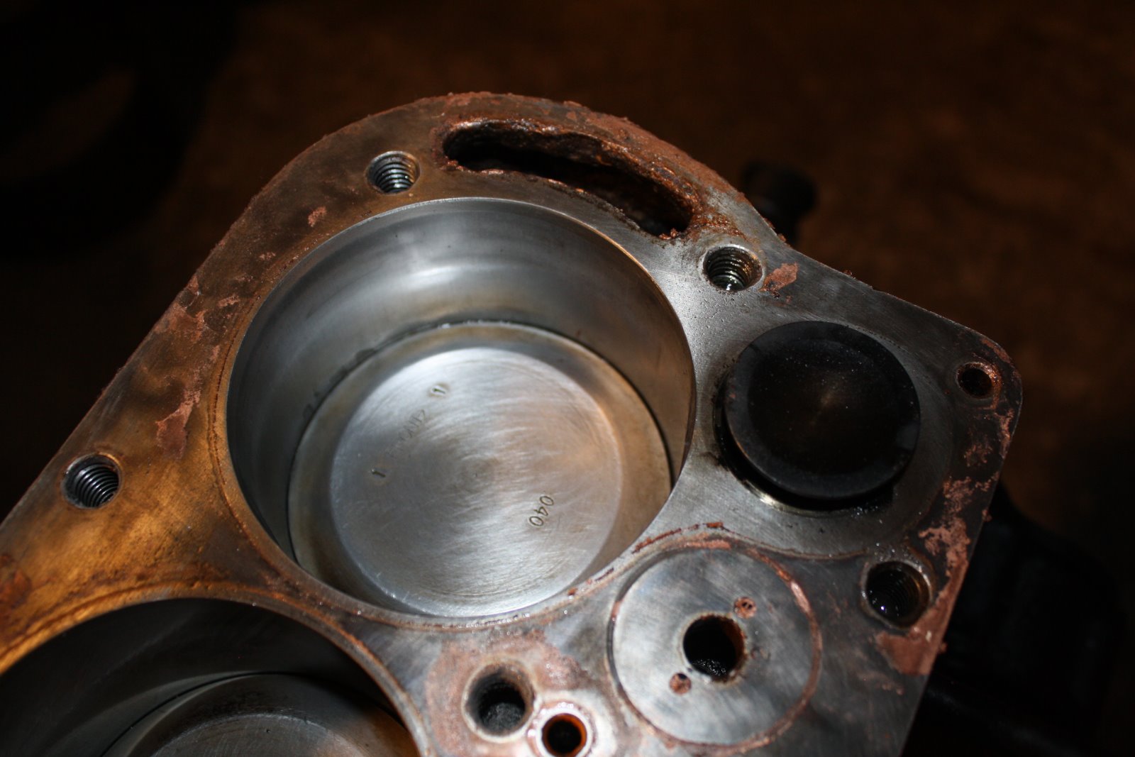

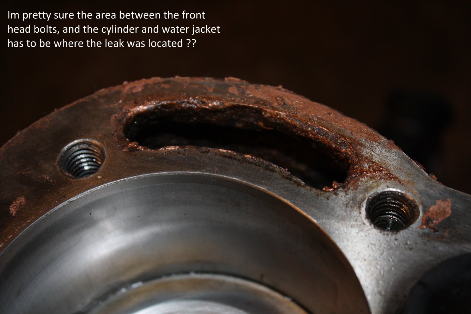

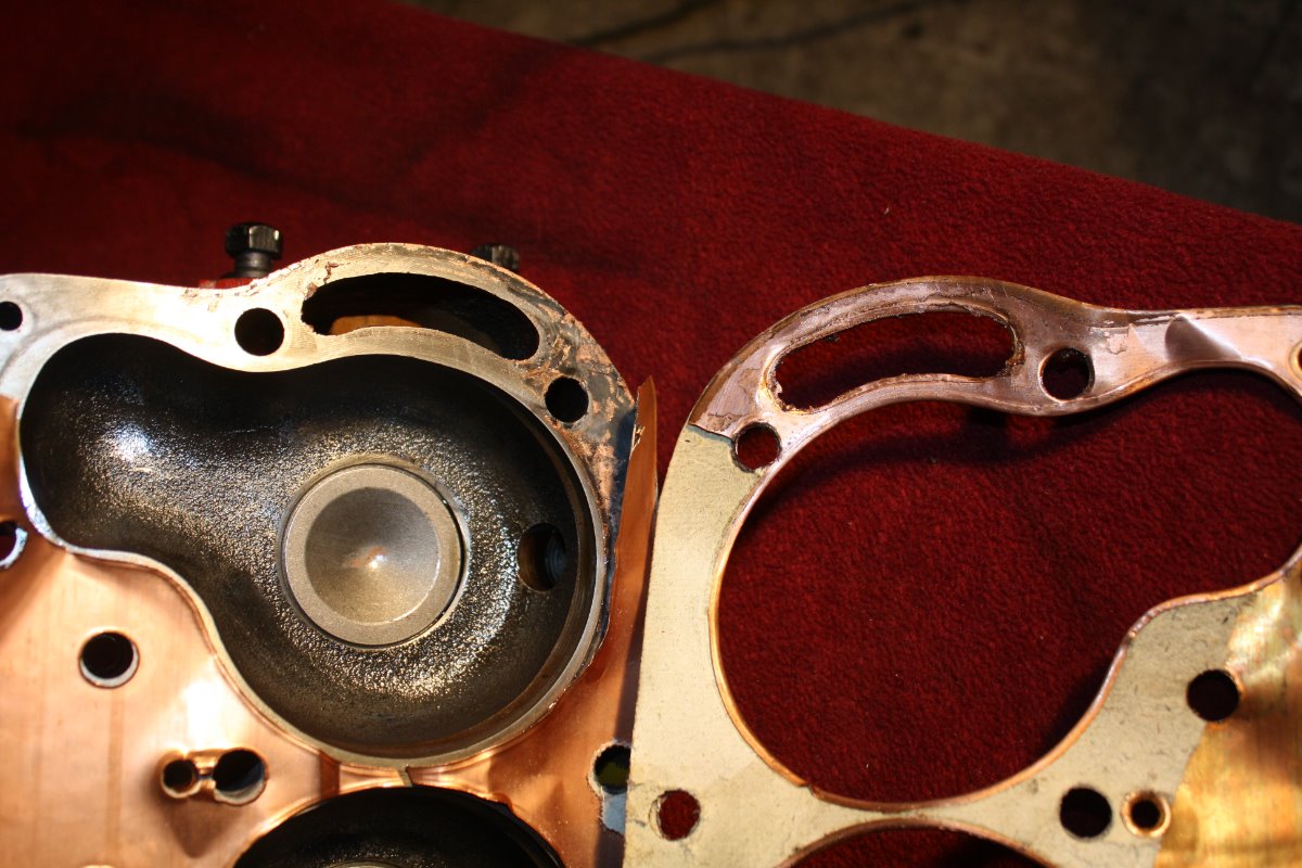

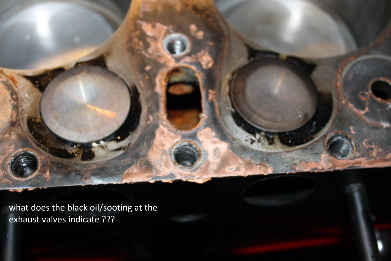

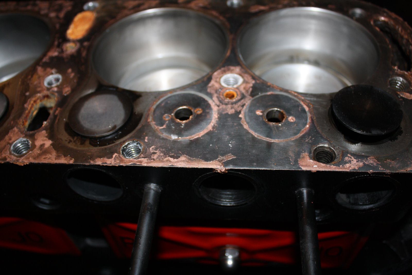

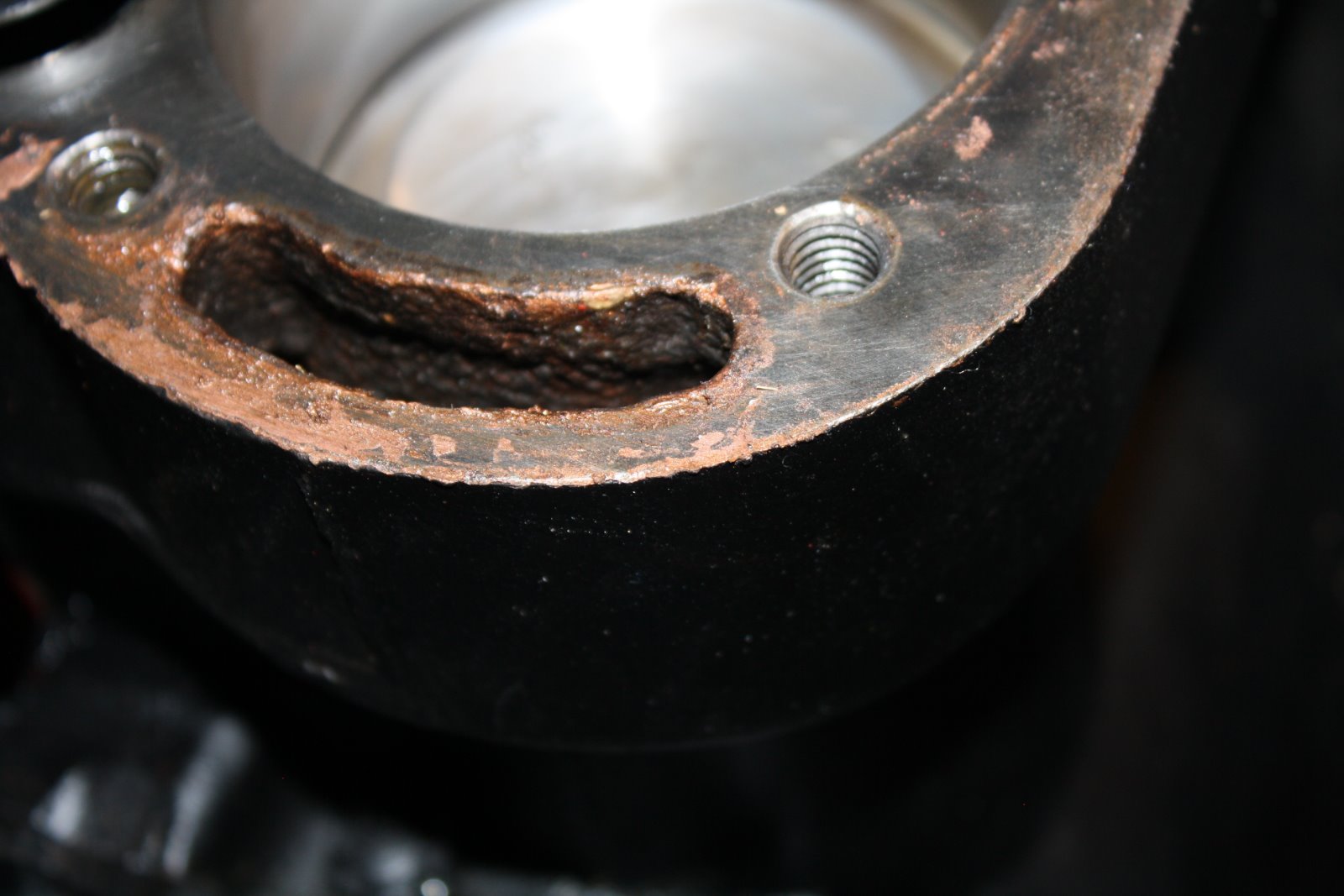

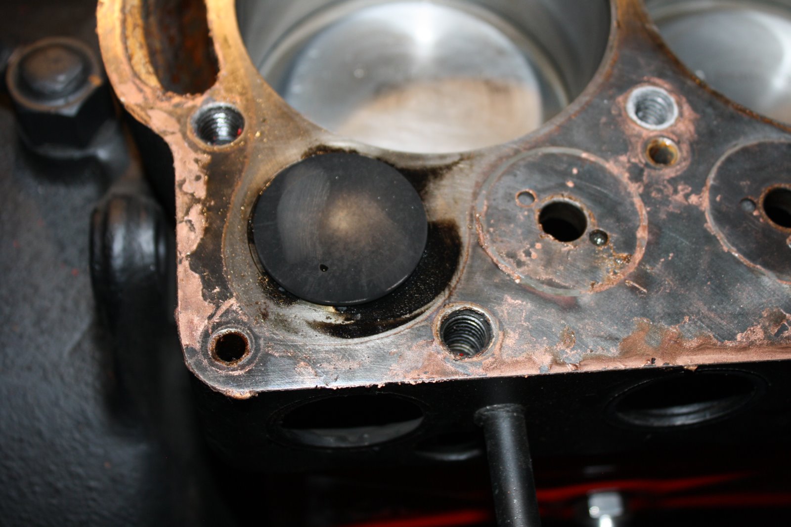

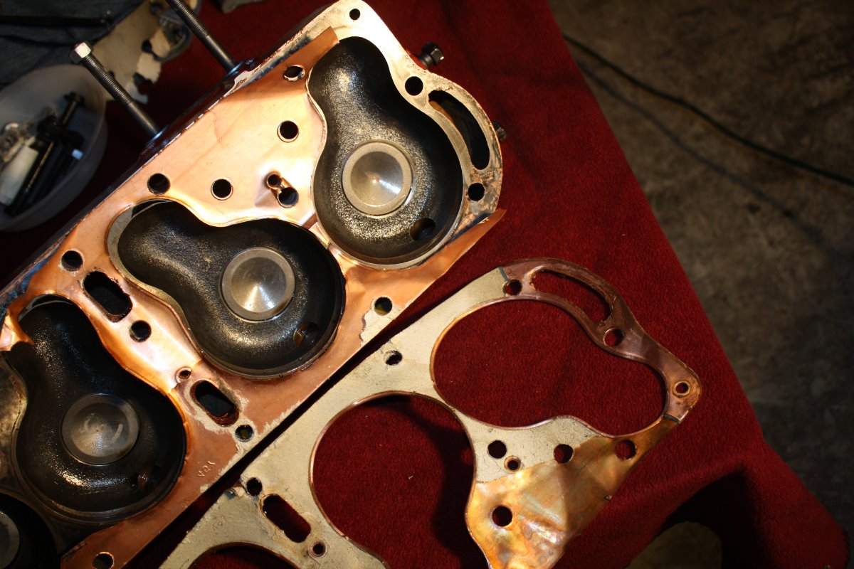

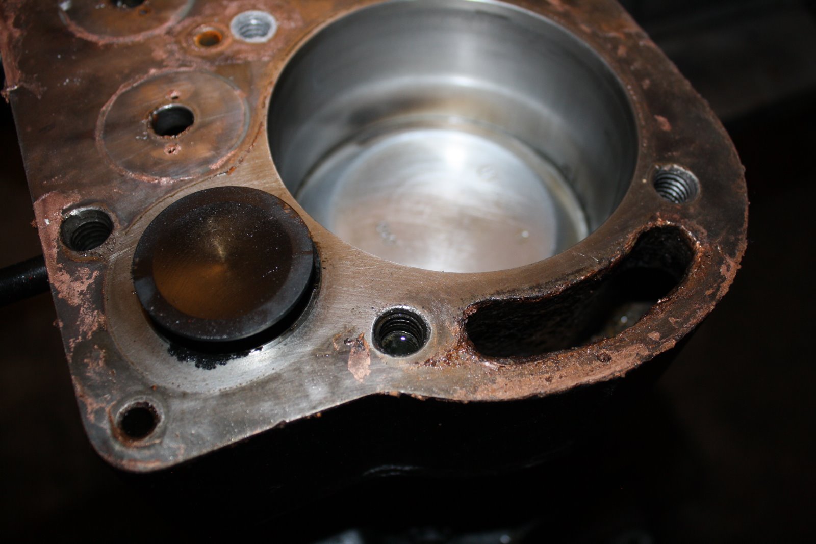

I could not stand it. I had to pull the engine and see what went wrong. So after two days of work the engine is out and on the engine stand. I have not pulled the pan yet. I want to leave it alone till I address the head gasket problem.
When I removed the head I did not see anything that looked like a "smoking gun" . Since the front two head bolts were bubbling water, the leak almost has to be in that area between the bolts. I see no cracks or any obvious signs. When I removed the head the copper head casket tore to pieces. Part stayed on the head and part on the block. The area of the block between the front two head bolts appears to be clean and the gasket did not stick at that point. One thing I want to mention is that the block and head have been machined flat and all head bolt holes were chased and checked for length before the head was installed. I could see no flaws in the head gasket itself at the failure point. The head gasket is an old "Fitzgerald" copper/asbestos gasket. The inside of the gasket does appear to be real asbestos. So maybe the gasket was just too old ???? It looked brand new with no defects at all when I installed it, but I have no way of knowing how old it is. I have one more "Fitzgearld" gasket and two solid soft copper gaskets. The solid gaskets are the ones Les recently made and are about a year old. I think I will use a solid copper gasket when I install the head next time.
So my next step was to do a complete "forensic" inspection. The only thing I can come up with is "maybe" the intake valve port plugs I made were too high. Using one of my machinest parallels as a straight edge, placed at each valve plug, and shining a quartz light behind the parallel, I could see that maybe the front plug was a 001 to 002 too high. I set the parallel on the deck surface and could see no light. Then I inserted a .002 shim under one end of the parallel and the light gap looked huge. The light gap was way smaller when the parallel was on top of the intake plug. That is how I came up with the maybe .001 to .002 that the plug may be high. Since then I have removed all the plugs and re-ground them to make sure that the plugs are about a half a thou to .001 low. There only purpose is to support the head gasket at the port area. 4-valve heads are prone to blowing head gaskets at the intake port area, so an old school fix was to make supports from old valve heads. So if that was the problem I have addressed it.
So now on to my next issue. When I removed the head # 2, 3 and 4 cylinders were very oily. #1 cylinder was not as oily but it had some water in it. So maybe the water/steam washed it clean. ?? The cylinder walls, and combustion chamber, had a thick oil film on them, as well as the plugs being oily. There was no sign of a head gasket leak at the rear 3 cylinders. When I rebuilt the engine last fall/winter I squirted some oil in the cylinders, as well as the pistons being soaked in oil when I installed them. The engine started easily, I have even hand cranked it a couple times. The first run of about 1 minute or less, the engine smoked very much. But that is to be expected. I have a total of less than 5 minutes run time on the engine. There was still some smoke coming from the engine, but not bad. So my question is "could the oily cylinder walls be the last of the oil I squirted into the cylinders. ?? I know it is hard to burn oil off something even with a torch, so has the oil in the cylinders just not had time to be totally gone. ?? I think So, but this is the first engine I have rebuilt that I had to re-open with less than 5 minutes run time. When I tore down the engine for the rebuild, the bearings were good and had plenty of shims left, the cylinder walls were almost perfect and still showed some cross hatch marks from the previous owners rebuild. The pistons were great and I very lightly honed the cylinder walls and reused the pistons and rings. The rings fit the ring groove as they should be. So am I worrying about nothing.. ?? There is one thing I did that has me concerned about the possible "oil pumping" . I installed a deep sump oil pan under the stock inspection/dipper pan. I also raised the oil level of the stock dipper pan about 3/16 inch by installing an oil dam at the rear of the crankcase. So I do have a little more "splash" going on in the pan. But that is a old school trick that has been used many times in the past by others. Any thoughts as to possible "oil pumping/excess splash"
I will post some pictures of the head gasket area. Maybe someone will see something I did not see. The weird thing is the "burnt oil" trail at the exhaust valves ??? But again, maybe it is just the remaining assembly oil trying to burn out. ?? Any help or input is appreciated.

Donnie, if the head and the block surfaces were trued, there must be a gasket problem. It is not hard to lose material from between the two gasket faces at the front and back between the end pair of bolts. Occasionally I have had to insert some brass shimstock between the gasket surface and its packing, not to replace lost packing, but to make allowance for the outside of the block water jacket being a little low. You have ruled out the low spots, so the gasket may be at fault.

A few comments- you never said if you got the engine warm enough to retorque the head gasket. If not, there might have been anything wrong other than the lack of retorquing the head a few times after heat cycling.
On your upper end oiling issue- it might be the pictures, but I see no evidence of any hone crosshatch pattern on the cylinder walls- they appear to be shiney.
If you go with a solid copper head gasket, make sure it has been annealed dead soft. I've had the best luck with using several coats of Spray Coppercoat on the gasket and letting it dry.

Dan, I ran the engine about 30 to 45 seconds for the first and second startup before I installed the radiator. With the radiator in place I ran it maybe 3 minutes. The water was hot but not very hot. I could still lay my hands on the head. probably too hot to keep my hand there long but would not burn. The paint on the exhaust manifold was just starting to smoke. You may be right. I should have checked the torque again. I think I originally torqued to 55 lbs. What torque does everyone recommend for a solid copper head gasket. The solid copper head gaskets I have were made by Les Shubert, and I believe they are "dead soft" copper. Less recommended Hylomar Blue for the gaskets when he had them for sale. I will either use hylomar blue or copper coat. Re-torquing the 4 valve head is going to be a pain in the rear. I have to remove the rocker arm assembly each time I re-torque. There is a head bolt under each rocker arm tower. But it will have to be done. As to the cross hatch marks. They are barely visable. Not deep enough to show up because of the glare.
I probably should have re-torqued first, :( Oh well Ill never know now. But the engine really needed to come out so I could check the crankcase/hogshead leak. I may have been able to just remove the hogs head, but it is really tight inside that speedster body ....
