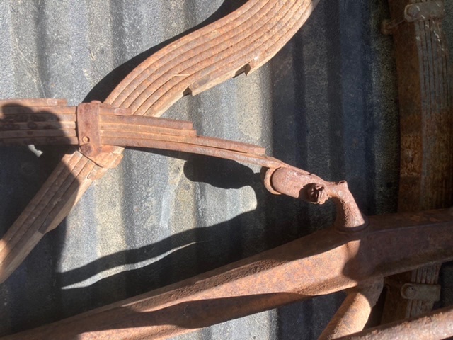

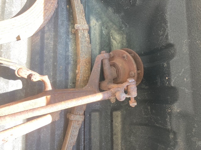

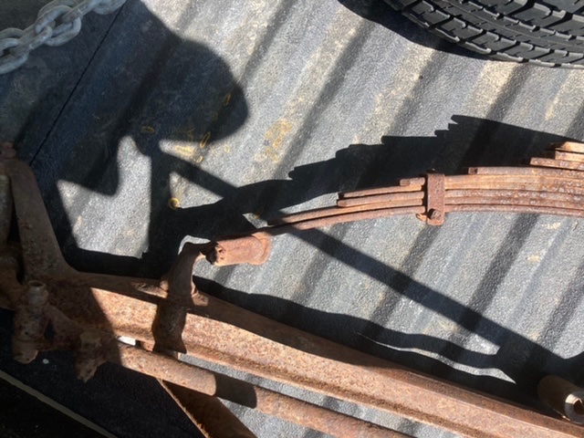

I have been trying to narrow down what I picked up this weekend for a project I have. It was on the front of a TT frame but the castle nuts on the spring holder didn’t even have a key in it so it was probably swapped out at one point.
Axle T-202 with a W without a circle on it no ford logo found on it.
Steel oiler caps on the top of the spindles or what is left of them.
Spring hanger had oiling holes.
Shackles are the two halves type.
Two piece spindles with the flat sides
Driver side spindle arm t 270 B
Passenger side spindle arm T 282
Has wood spoke center hubs.
Looks like flat metal was added to the top to raise the spring and no leather isolater was there unless it was stuck to the frame.
I also picked up a front spring and a rear spring from him.
Next weekend I will likely go back and purchase one set of wire rims from him. I am unsure of the size right now. And a complete rear end assembly from him to have one on hand.
I have been doing a lot of reading and still got a lot more to narrow it down to see if these spindles and arms are all matched and compatable set.

The front spring is a messed up put-together super heavy duty (I have a similar one in my pile). You would need to take it apart to see how many leaves are straight and decent enough to be used. I see some that are broken halves (must be drilled for the center bolt). There may or may not be enough good pieces to make one good spring. Otherwise, it is good parts to repair another spring. The broken halves may also be useful. The ends can be cleaned up on a good grinder to make shorter top leaves.
The tie rod appears to be an earlier (pre-1919) style which makes it a bit more desirable. The T-202 axle is the common for most years axle. A T/W in a couple forms (superimposed, stacked, in a diamond) maker's mark is Transue/Williams, one of the larger makers of Ford's front axles for many years. A "W"by itself I believe is another maker of lower numbers of axles, but I do not recall the name offhand. All in all looks like a good catch of decent parts. You might even find a wheel bearing or two may be usable?
Posts: 4055
Re: ID’ing front end set up.
Post by DanTreace » Mon Jul 13, 2020 10:01 am
Wayne's summery is great. Only can add that 'W'only maybe the combined mark used by Transue/Williams, one symbol they used is a mark with a bold W with a T stamped over the center of the W.
On a rusted up part that upper cross of the T may be obscured, showing only the wide W.
