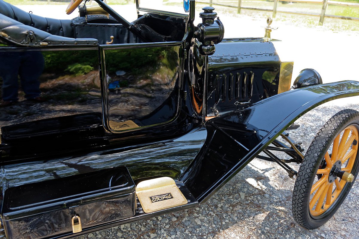

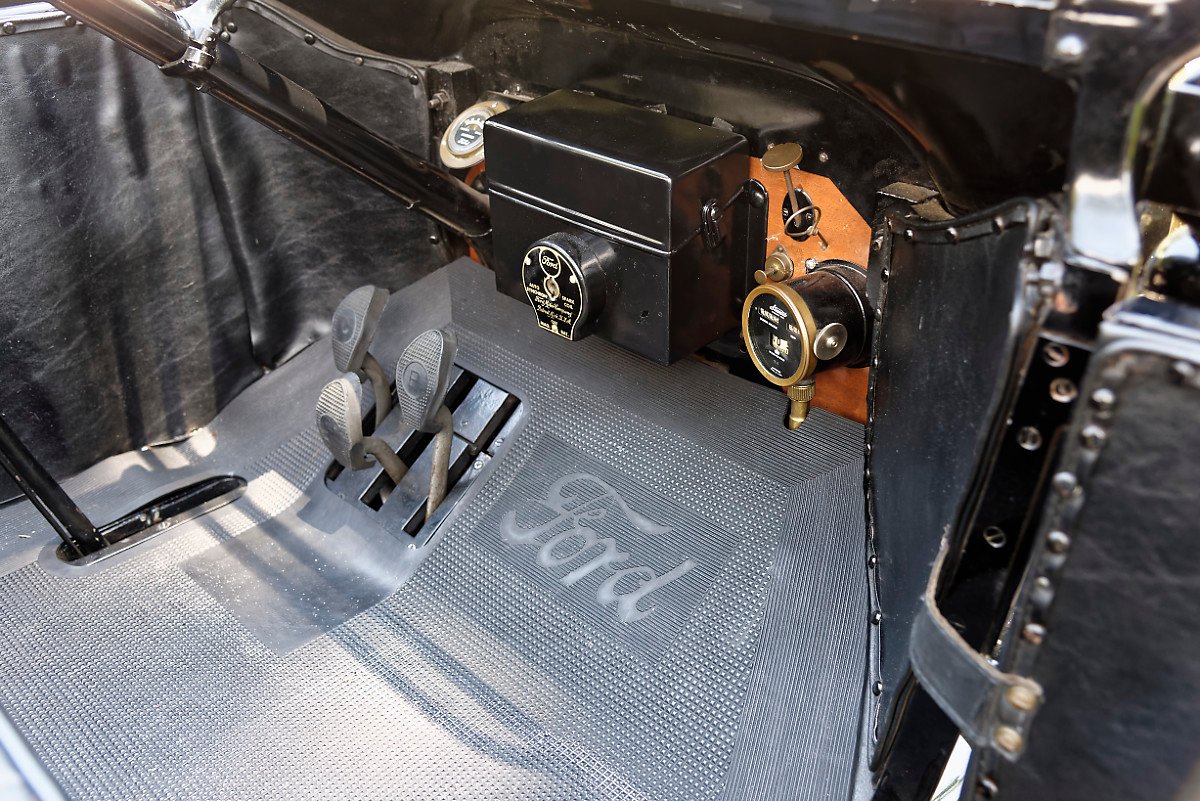

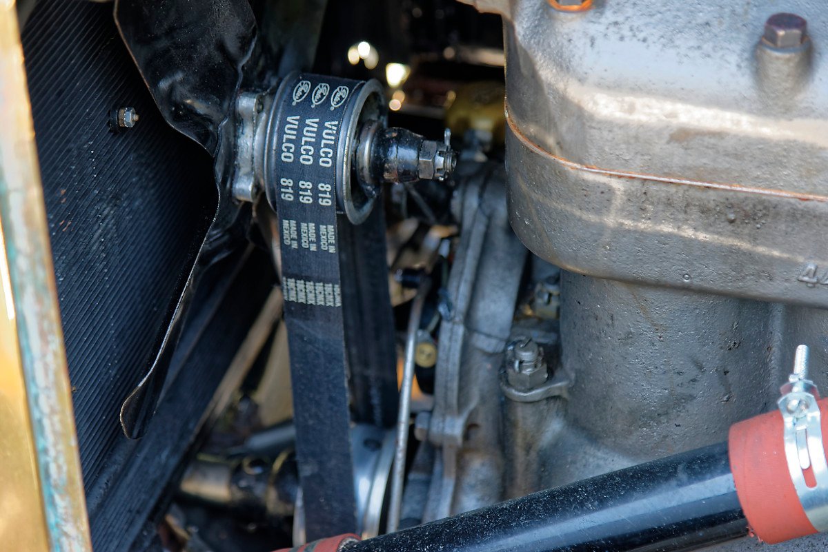

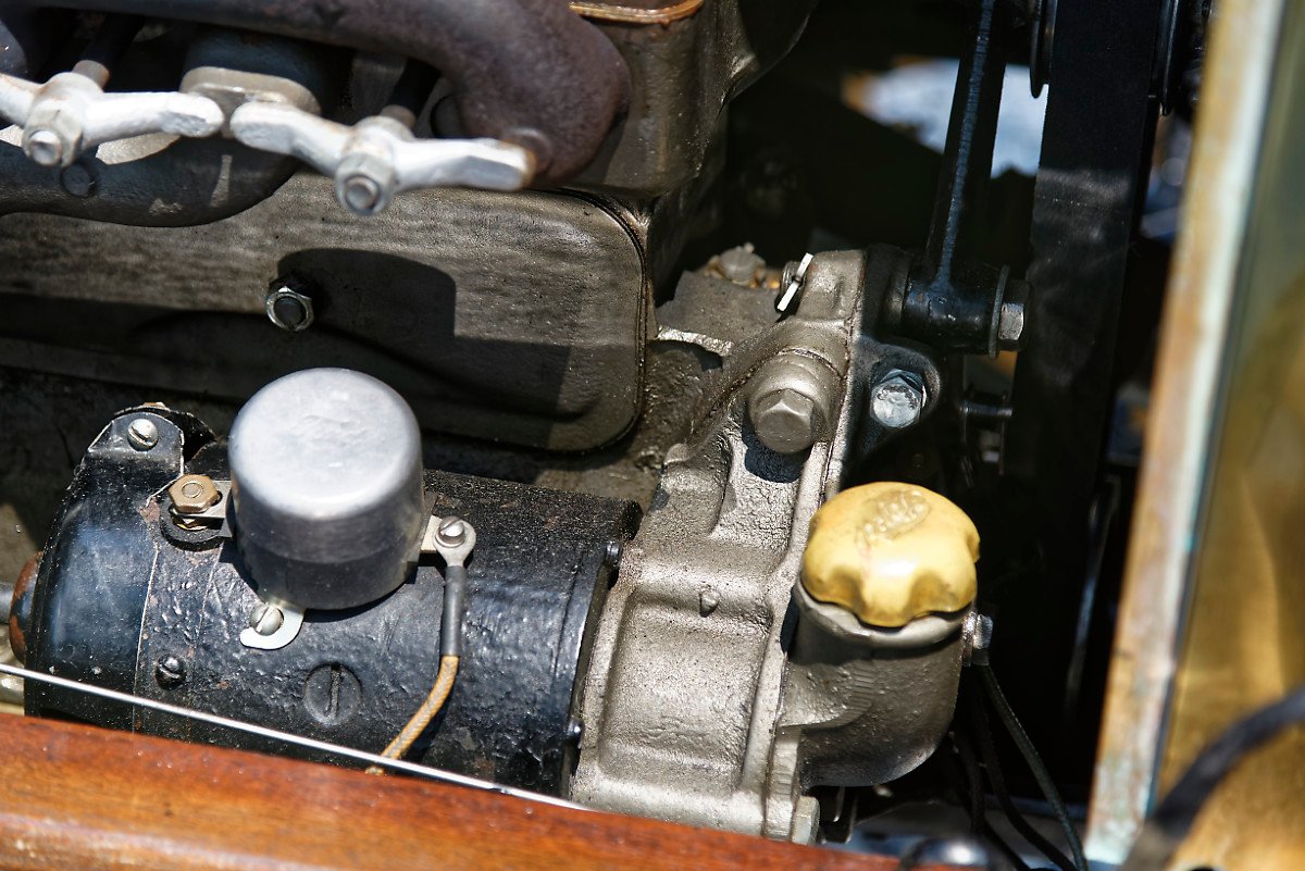

Hey guys,
I inherited my dad's 1916 Touring. I would like some of you to go over the pictures and tell me what's right, what's wrong and anything else you might add.
To begin with it is a 1916 (1222277), I have the original engine in my garage. It currently has a 1924 engine in it for ease of starting. It is 6 volt. I have changed out the spark plugs for modern ones because they all leaked. It runs well. I know I have a hot exhaust valve on number 3. (some may spot the paint coloration) I know the wheels and steering wheel came black from the factory.

Very nice.
The only thing I'm seeing, the front hubs have been up graded to later ones, a change that I would leave as is, they are a stronger hub around the outer bearing.

One item I see is the generator brush cover - the gap where the retaining screw & nut is what should be straddling the cutout post - someone seems to have done a little handy grinding of the band for clearance !

The speedometer drive is "whonky" - it should be loosened up at the pinch point & rotated so the cable attachment point is pointing towards the rear of the car.

Beautiful anatomically correct touring. Only things I can add are super picky: the 4 manifold clamps on the ‘24 engine are the heavier ‘26-‘27 and installed upside down. And someone smarter than me on this Forum said Model T s never had brass top prop nuts. Also, the front top prop nut left side is missing....I said left side-not drivers side-just for you Allan

The only thing I could find, outside the 24 engine, is a common occurrence. The upholstery nails in the doors are way closer together than is usual. Restorers often do that. The usual gap between them is approximately 2 1/2".

@RajoRacer, Thank you! Should I replace the generator brush cover or is it only a judging thing? I can take a closeup of the speedometer gears and maybe you could annotate to show me what to do.
@George House, I can reinstall the manifold clamps right side up. I think the 'brass' top prop nuts are actually painted. We're talking about the nut on the top rod anchor point just above and behind the rear door upper hinge?

A lovely car, mostly correct as far as I can see. Exceptions are the "natural" wheels you noted, mostly a modern fad*, the step plates, and the modern hose clamps.
No manhole oilers are being made as far as I know, so my 1915 wears the brass twist oilers on the shackles and the "modern" flip tops elsewhere.
*All Ford wheels came from the factory painted body color until 1925 when varnished "natural" wheels became an option. I believe very few people ordered that option. Other than advertising, how many period photos show Fords actually wearing "natural" wheels? Mighty few, if any.

Jeff, the manifold clamps are on the correct way round for 1924, but they are 1925-7 items. The foot which rests on the manifolds is flat on each side, so the clamp can be installed either way, allowing the dealers to stock just the one part for any T. On the later cars, the manifold studs were shortened, [to save a cent or two?] and the new style clamps were installed In the opposite orientation to those on your car. These shorter studs had a rolled in ridge, up to which the studs were inserted in the block.
Regarding the upholstery nail spacing, in Bruce McCalley's book "Model T Ford" there are illustrations showing how it was done. They are not uniform, but generally there were 6-7 down each side and 5-6 across the top and bottom, the spacing often being somewhat random. There are clear photos on page 217 to show this.

Personally, I would not worry too much about anything on the engine as long as it is working well and safe. A wrong engine is a wrong engine. The wrong manifold clamps work fine either direction, and as long as the generator cover keeps most dirt and rocks out,? No big deal.

If you choose driver, just leave it as is and repair only those things which give you problems. If your choice is show car, then try to upgrade everything to the original standard. That would include replacing the fan belt with a leather belt.
