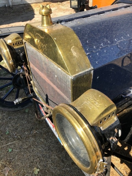

As usual, the cautious reply would begin, “ . . . It depends . . .” I’m a slob. All summer I use my Lizzie (‘13 runabout) as a farm vehicle, hauling feed, changing the irrigation, chasing water, etc., through deep mud (sometimes) in all weather. Come late fall, she’s in for an annual cleaning, R&R, tuneup and whatever repairs are necessary. This includes polishing the brass, which takes a while, but I consider it good winter therapy. She won’t look a lot worse come November, this is the state of tarnish now. Once I let it go two seasons, the process wasn’t noticeably any harder. I use “Blue Magic”, it works very well IMHO.
I’ve worked on items so tarnished they looked like patinated statuary, and years of deep tarnish is very difficult to bring back.

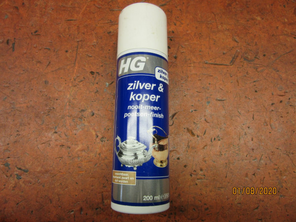

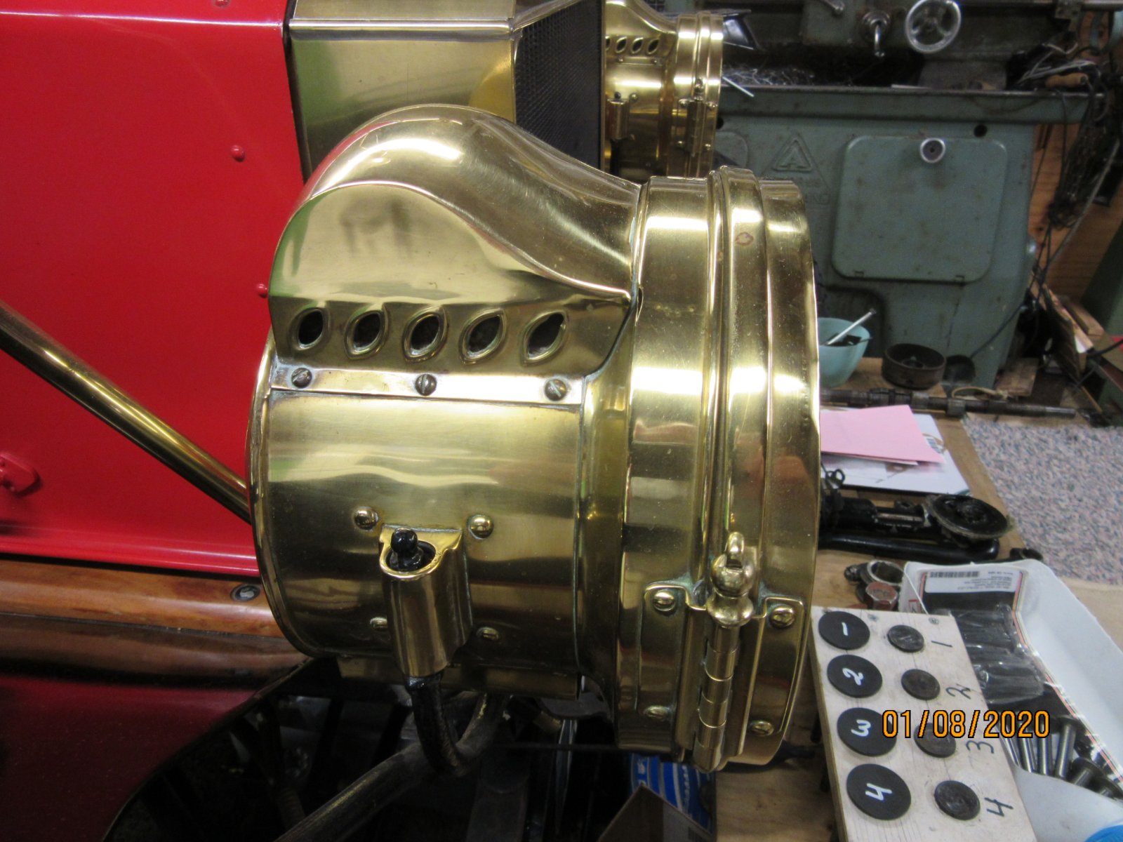

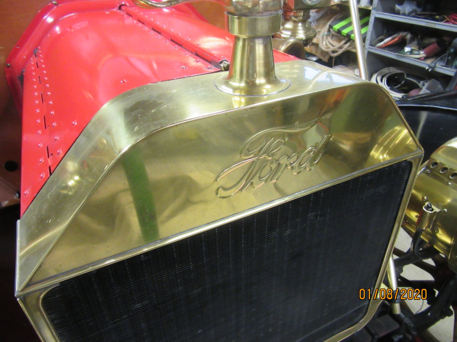

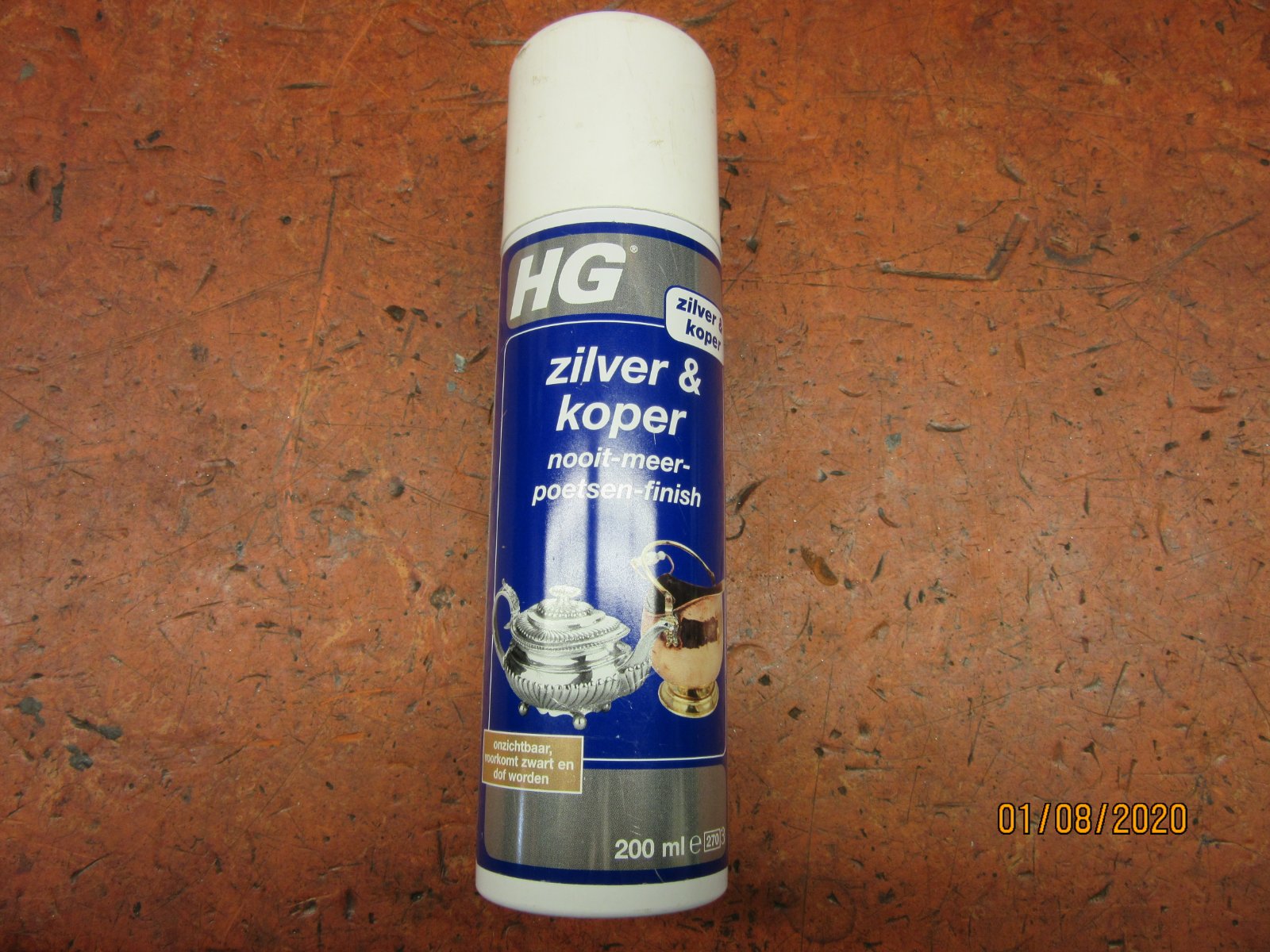

Two years ago a Model T-Friend told me he know something to spray on brass to coated that .
I used that, and till now I am very happy with that .
It is ; From HG [ a Dutch Company ] The name is : Silver & Brass never polish again .
If you like you can take it off with Aceton .We have it for two years now and we had a lot of rain, but it is still nice .

Looks good Toon. I am surprised it holds up so well on the hot radiator though.
