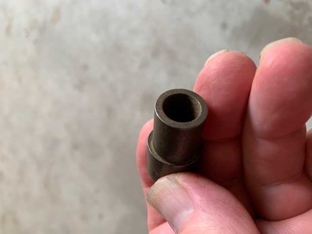

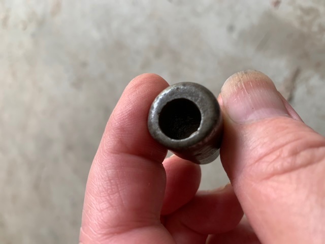

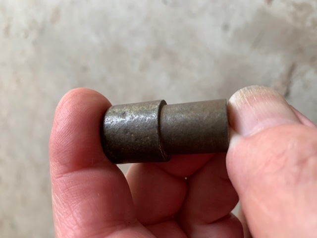

Post by Dan Hatch » Mon Aug 24, 2020 2:33 pm
Guys: Have not looked this up in old parts book, but is this a replacement guide for open valve engine? My 2 open valve engines look to have bronze guides, but they may have been changed.
Or these just replacements for all T engines. I am sure there must be something in the Ford Service Bulletins about them if so , but mine are buried under stuff.
Anyone know for sure? Thanks Dan
Walter Higgins
Posts: 292
First Name: Walter
Last Name: Higgins
* REQUIRED* Type and Year of Model Ts owned: 1911 Open Runabout
Location: Realville, PA
Re: NOS Tappet Guide?
Post by Walter Higgins » Mon Aug 24, 2020 3:51 pm
While I have seen these listed for sale as open valve lifter guides, I have only ever seen bronze guides in open valve engines.
Kerry
Posts: 1458
Last Name: van Ekeren
Post by Kerry » Mon Aug 24, 2020 5:41 pm
1912 parts book say, Push rod bushing, 1909-11, Iron.
Posts: 3821
Location: Lomita, California
Post by Original Smith » Tue Aug 25, 2020 10:32 am
Bob Bergstadt has had lots of them over the years.
