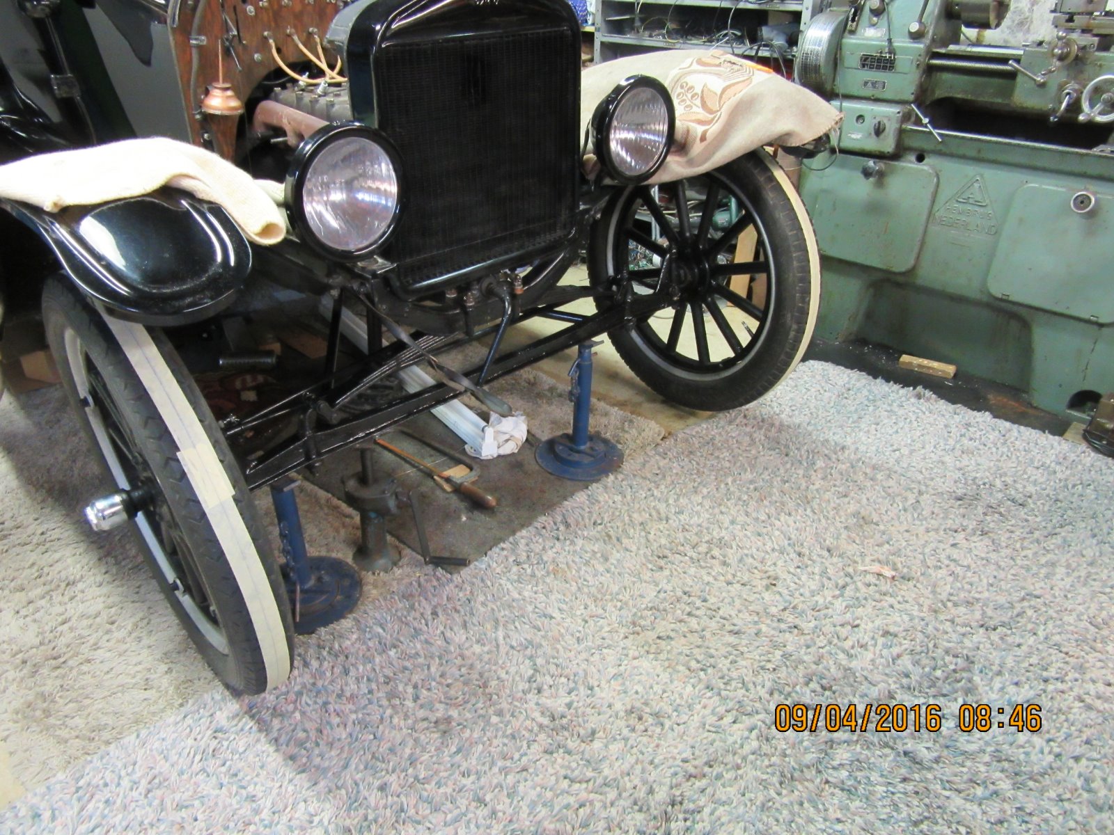

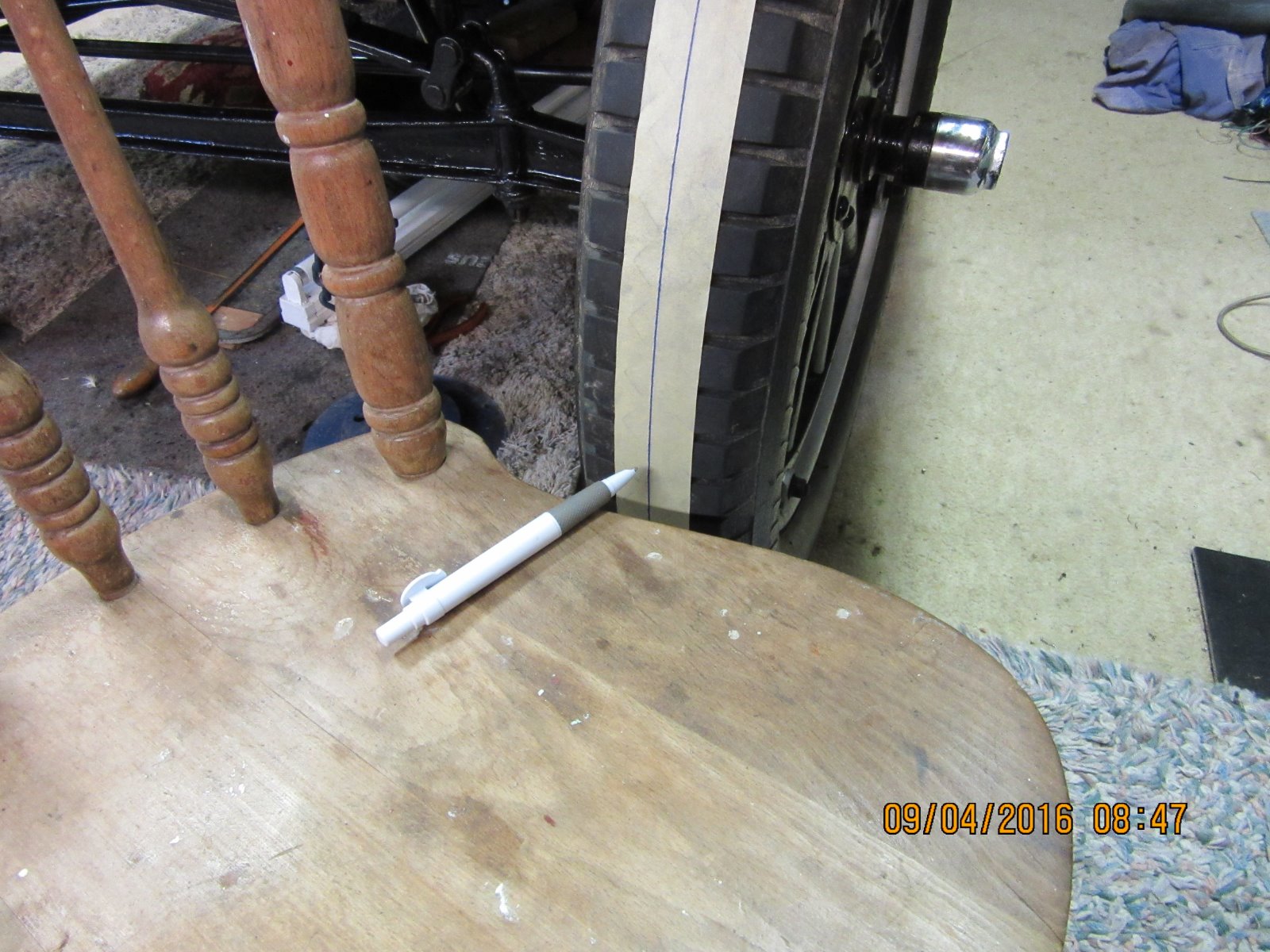

Re: looking for easy way to check toe-in
I do it this way .
