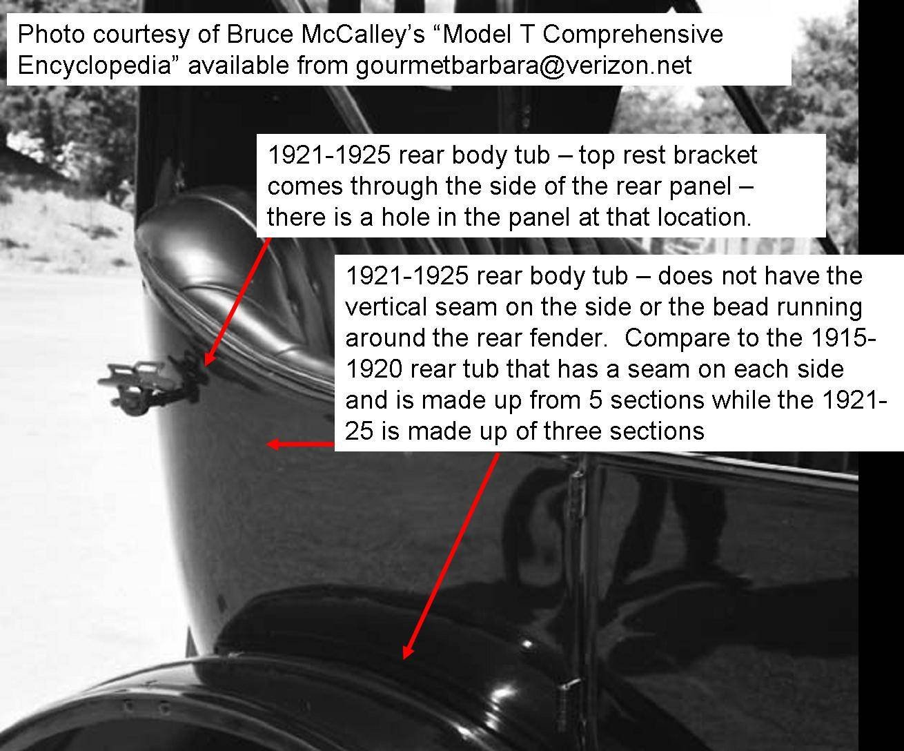

I've also suggested that it might be easier if he obtained a 1917-1920 front section to go with his current 1917-1920s 5 piece rear seat section or that he could obtain a 1922-25 rear seat section to go with his current 1924 front section. In general any rewooding project will take some fitting etc. but I'm wondering how easy or difficult it is to put the 5 piece rear tub on the high cowl 1924 front. Is that about the same effort as fitting the more era correct 3 piece rear tub? I know I have seen a mid-ish 1921-1925 3 panel rear tub fitted to the earlier 1915-1920s car instead of the earlier 5 piece rear tub. And of course the arm rest are wider on the earlier bodies and narrower on the later bodies. And the top rest comes down from the top on the earlier models and out through the side of the body on the 3 piece tubs.

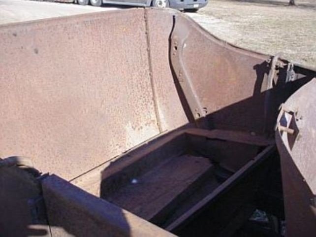

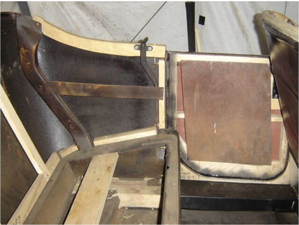

I like to say the rear tub changed during 1921 -- when I believe both the older 5 piece rear tub was replaced with the newer 3 piece rear tub. The 2 photos below show a 1919 5-piece rear seat section for a touring (used by permission of Model T Haven -- this one sold several years ago. Thank you Mark for letting us use those. See https://vintagecarsandparts.com/cars-pre/cars-pre-2 for other photos on his site. )
1919 rear seat tub 1.jpg (24.11 KiB) Viewed 1104 times
1919 rear seat tub 2.jpg (22.75 KiB) Viewed 1104 times
I'm having a little issue with the computer and the photos so I will post the next part in a minute or so.

Below shows the metal brace that was introduced during 1921 with the 3 piece rear tub. That is not in the earlier 5 piece rear tub. I can't find where I had it filed. I think I owe Mark of Model T Haven another thank you for allowing us to post his photos. But if you recognize that it was your photo -- please let me know so I can add that to file info. This one is a 1925 but it show the metal bracket:
The photo below was posted by William L. Vanderburg (see: http://www.mtfca.com/discus/messages/50 ... 1438574224 ) Thank you Will.

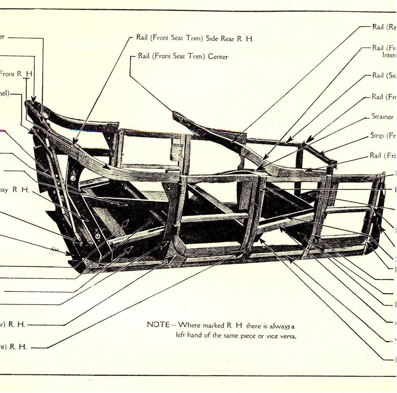

And below is the sketch from the 1923 Price List of Parts for the wood parts for a touring:
