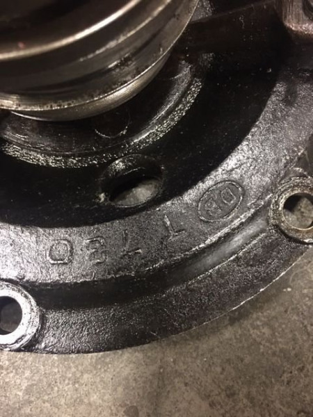

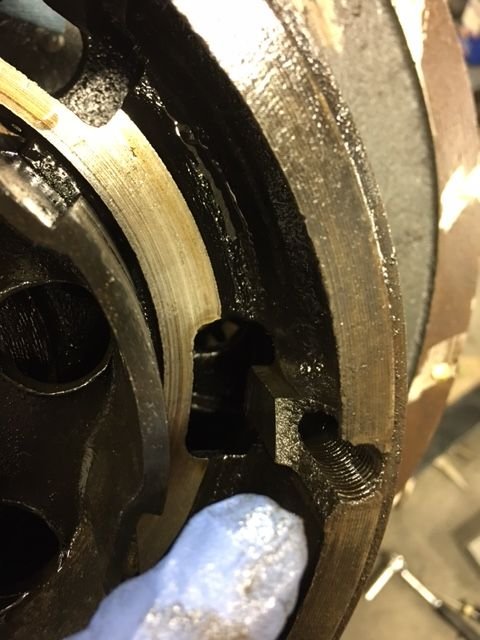

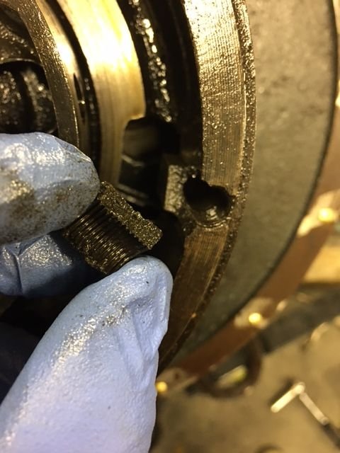

Last night, I was working to intalling WATT clutch and I found a little crack on my break drum. I just touched the crack slightly with my finger and a piece of the drum fall down... It is not a fun discovery but that save me from a disaster for sure. My friend Hank will help me to fix that. We never know what we will discovering when we open the heart of a Model T Ford. I thought I'm lucky with my unfortune discovery. That will postpone my project but that gave me the opportunity to make it right for another 100 years...

All the drums should be magnefluxed prior to assembly - I don't like surprises !

We have Mario taken care of. Complete rebuilt early one fully balanced ready to install.

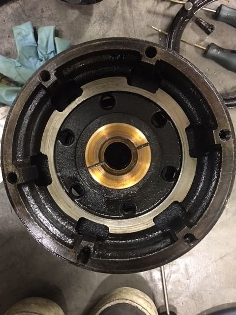

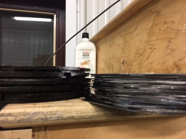

My drum look to be a late drum instead of early Drum... See the picture bellow. I also have another question because when I compare WATT side discs with your procedure it's look higher compare Ford stock discs... The Ford Discs together is 1'' 1/8 height. May I miss something here? I have no experience with WATT discs.

As I posted above, and as is borne out in your photo, the Watts style stack is thicker than the Ford stack. That's why the push ring pins have to be shortened to compensate.

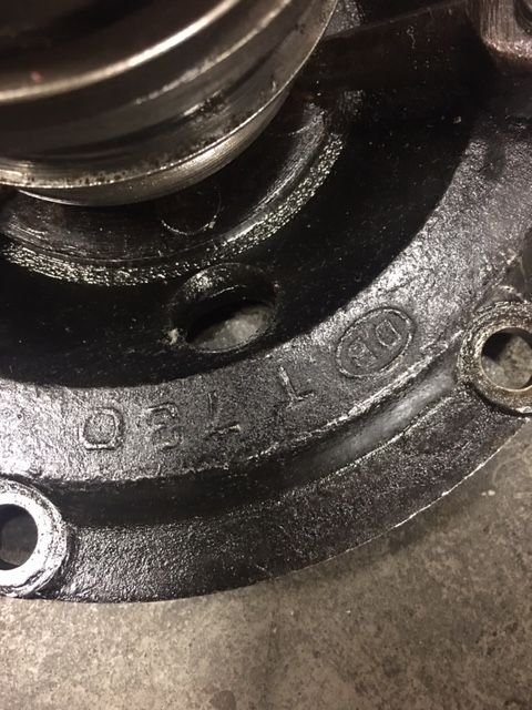

Mario - your photo shows an early brake drum with the "top hat" bushing.

Thank you Steve, I thought it was late drum because the link provided by Mark... RV said : Early drum have the flanged bushing. The late drum has the standard sleeve style. I'm Always learning every day with Model T.

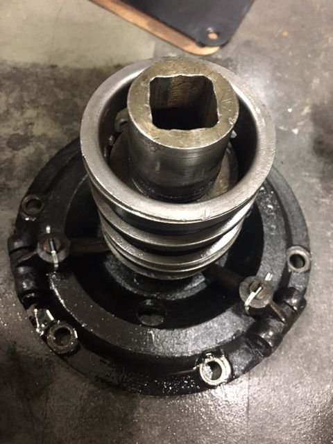

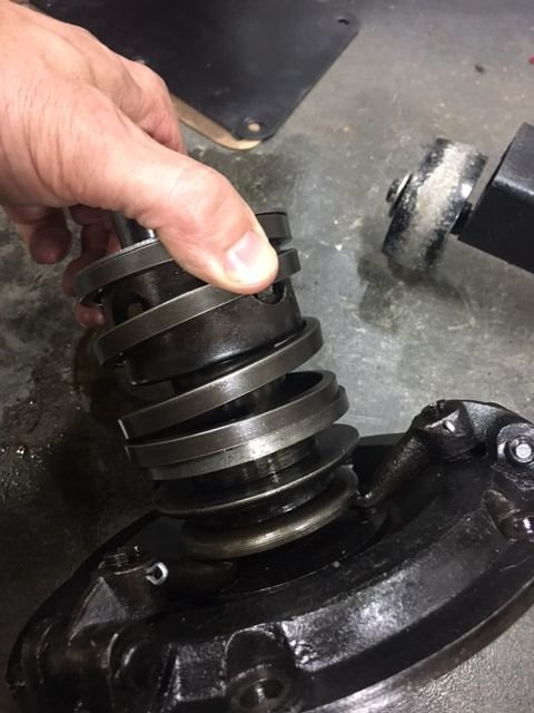

Here, other pictures as well... We could see it is made by DB

Dont expect the 13/16 inch distance to work with a Watts clutch even with ground push ring studs. Compress the spring to 2 1/16 inches.
