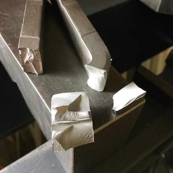

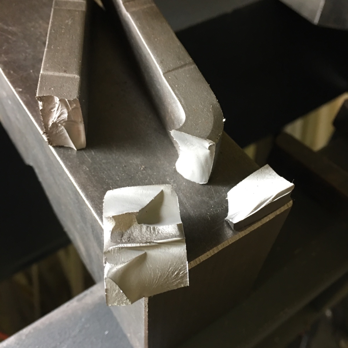

While cleaning up the magneto magnets this evening, we found one cracked magnet, and with the lightest tap it broke. Looking in the catalogs, you can not purchase a single replacement magnet. Have any recommendations for a replacement? I was thinking of calling on Andy Loso.

Ford magneto magnets are basically a hard tool steel. They are made of a very hard steel because it was the optimum material to hold a good magnetic charge for a long time. Because the steel is hard, it is also brittle. If you put a good Ford magnet in a vise and squeeze the ends together, it will break. If you put a similar piece of hot rolled, cold rolled, stainless, or various other grades of steel in a vise, they can be bent without breaking. My advice is to never use any “potentially destructive” method to check Ford magnets. I have seen “break testing” or “hammer testing” of magnets recommended on the forum several times over the years and I respectfully dissagree with the method because it is very likely to cause more defects than it finds. Hammering a magnet against a larger metal object will break the magnet that is “just about to fail”, but it also stresses and fatigues the seemingly good magnets in a way they were never meant to be treated. What may have otherwise been very good magnets before they were “fatigue tested”, may be “just about to fail” after they are pounded against something.
In industry, the method of evaluating a part that you still wish to use is called “Non Destructive Testing”. In checking Ford magnets there are 2 basic tests the average hobbyists can use: Visual and Ring-test. Magnets should be solvent washed to remove all oil, grease, and loose dirt. They can be manually scrubbed with a wire brush and/or abrasive blasted. A gentle abrasive such as glass bead at a medium pressure works best. The first test is a good, careful, visual examination of each magnet. If you don’t have excellent eysight, then use a big magnifier or have someone help you. Generally speaking, MOST defects that ever may cause a magnet to fail in use can be SEEN on a clean magnet. An alternative visual test if they were solvent washed and immediately abrasive blasted, is to not remove the haze of abrasive dust and lay them out on a table in a single layer and leave them undisturbed for a couple hours to overnight. Upon a close visual inspection, imperfections that held traces of the oily solvent thru the blasting process may show up as small oily lines and be easier to spot. The second basic test is the “Ring Test”. The magnet can be hung by its v from a piece of string long enough that your hand is at least 6” above the magnet. Then tap the part of the magnet that would be against the brass clamp screw with a very small ball pien hammer or similar object. Only tap the magnet enough to cause it to ring like a bell. Hold it up to your ear and it should hum like a tuning fork and take several seconds to fade. Any magnet that only produces a dull thud is generally cracked 1/3 of the way thru or more. Any magnet that rings a noticably shorter duration than the rest should be noted as “suspicious” and probably best off to replace.
In addition to the simple tests that the average hobbyist can perform at home, there are two professional tests. One is a liquid dye penetrant test. And the other possibility is Magnafluxing. I would not recommend regular Magnafluxing for these magnets, but there is a pulsed-direct current Magnafluxing yoke on the market that is preferably used with a liquid particle solution and can be used on these magnets without risk of changing their original poles.
The “professional” tests are overkill in my opinion, unless maybe you are working on a ‘08-‘11 with great original parts and desire to “pay for additional insurance”. I own the proper Magnafluxing setup and when I first purchased it 10 years ago I experimented with its effectiveness on magnets and found the visual and ring-test to have about the same effectiveness.

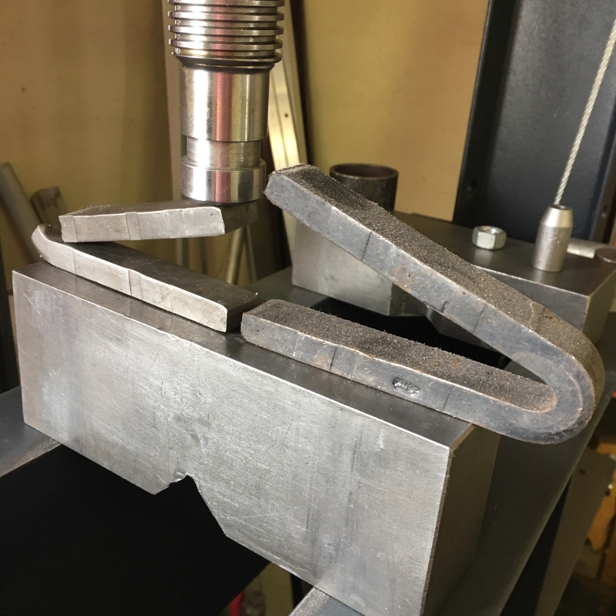

I put a magnet in the press yesterday to illustrate how easily they break. The pressure gauge on the press never rose off its stop. The height of the ram is where the magnet shattered. The un-broken magnet is there for comparison. Note that the magnet didn’t just break... It shattered.

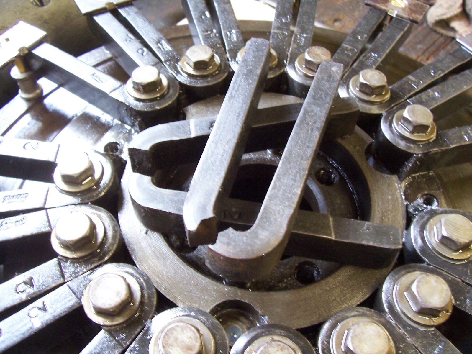

A variation on the method that Adam describes is to soak clean magnets in mineral spirits for a half minute, then wipe them dry. Lay them out and sprinkle a light coating of baby powder, talc or starch, all over but especially into and around the vee. Cracks will show themselves as the solvent leaches out into the powder.

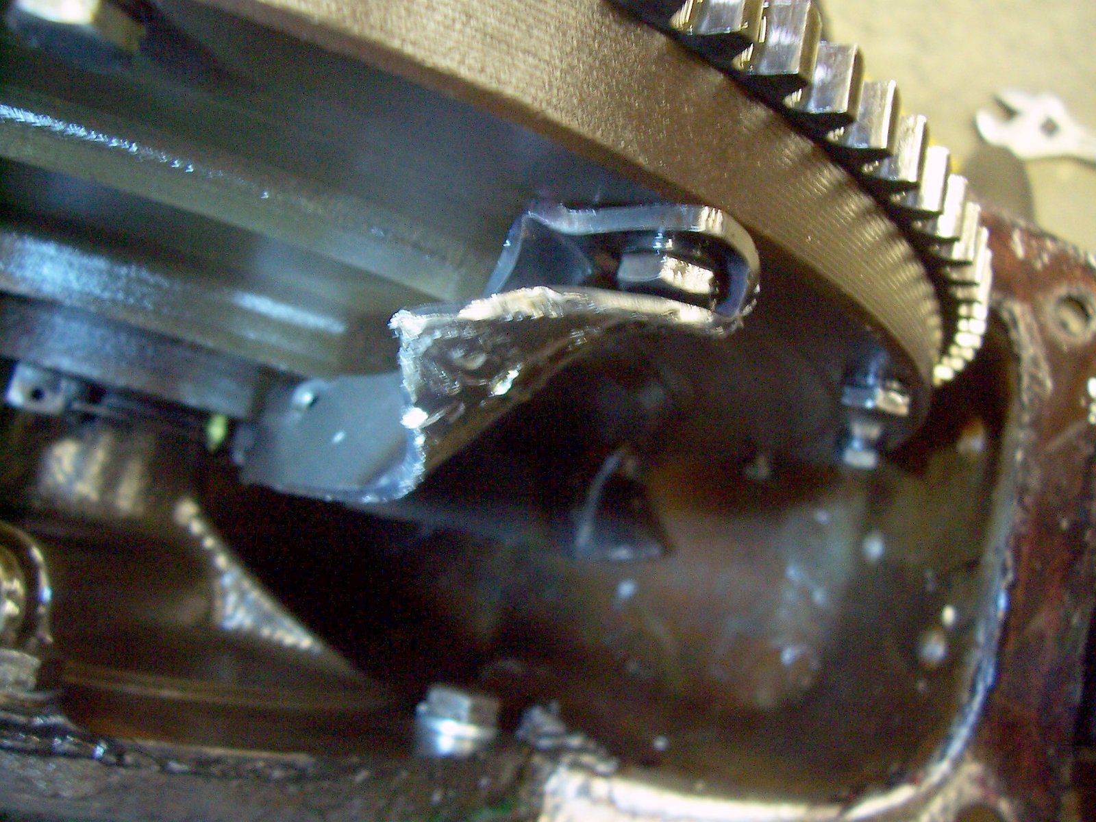

I found two magnets broken on my last motor. I could see the break from the metal fuzz collected along the edges of the break. They stood out pretty clear.

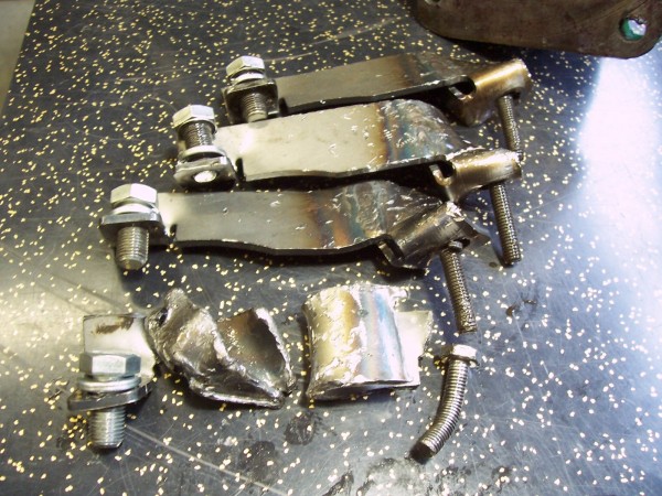

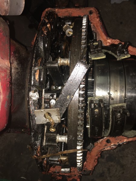

You are so lucky that they didn’t escape. I have had two engines where the magnets let go and hit the magneto coil with horrible results. Unless you remove all the magnets and have them magnofluxed, I don’t know how you can avoid the potential for a problem. Of course you can remove all sixteen and run on a distributor but that will get me banned
My Coupe still has magnets as does the 09, but the 14 Touring and the speedster have them removed. I miss the noise of the coils and moving from a stop is more challenging due to the lower inertia of the flywheel without magnets.
Tony Bowker
La Mesa, California
La Mesa, California

Re: Magneto Magnet Questions
Tony, yes this motor has a Bosch front plate distributor. So I did remove the magnets and put on slingers. At least when they come off the damage is minimal.
