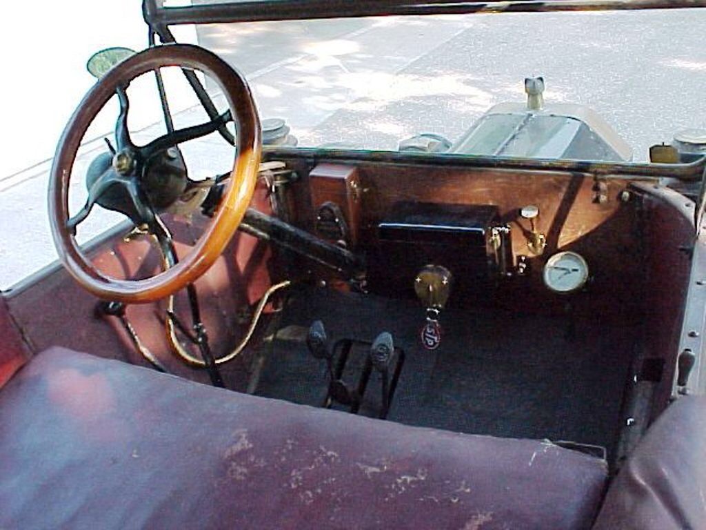

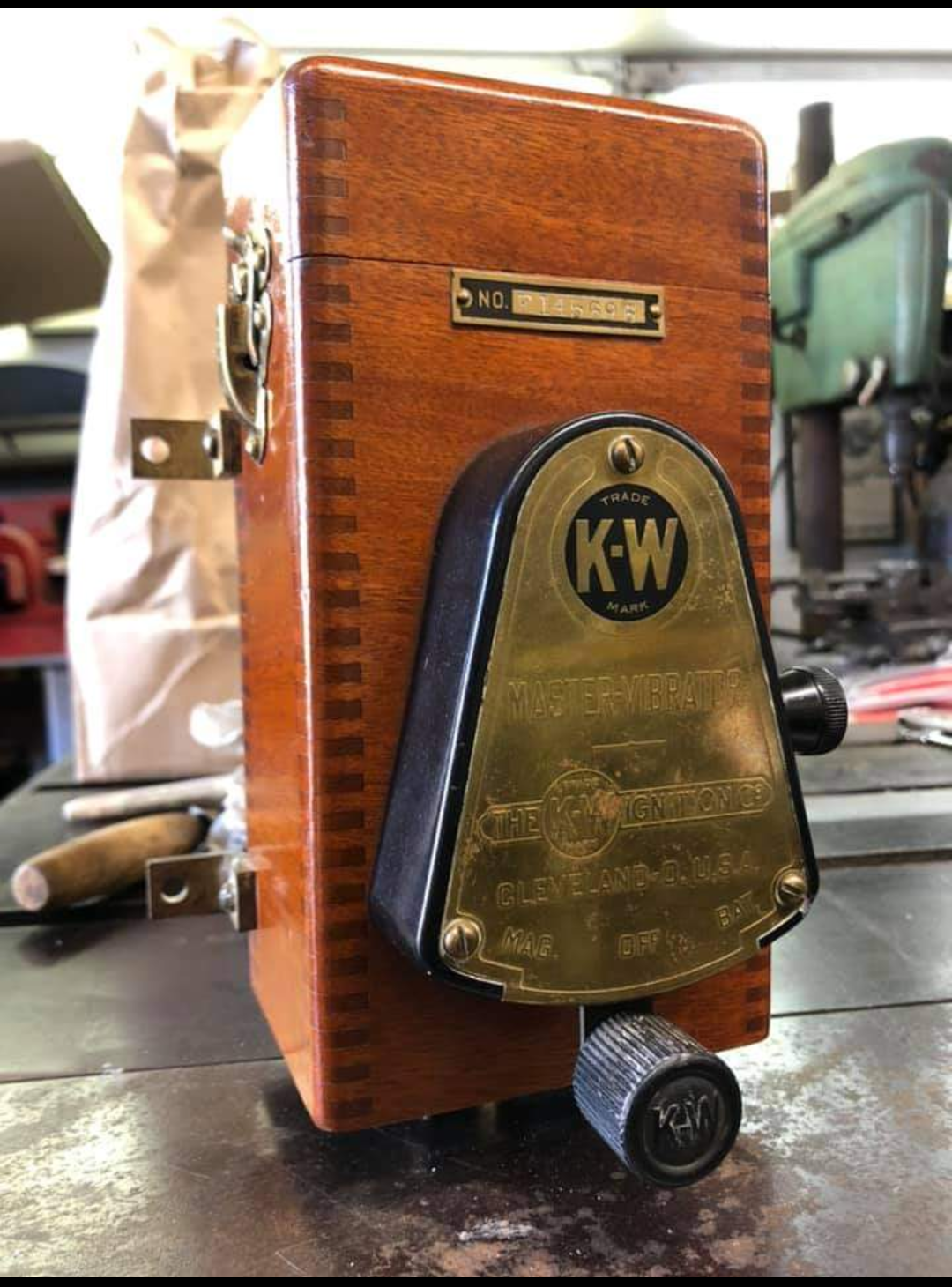

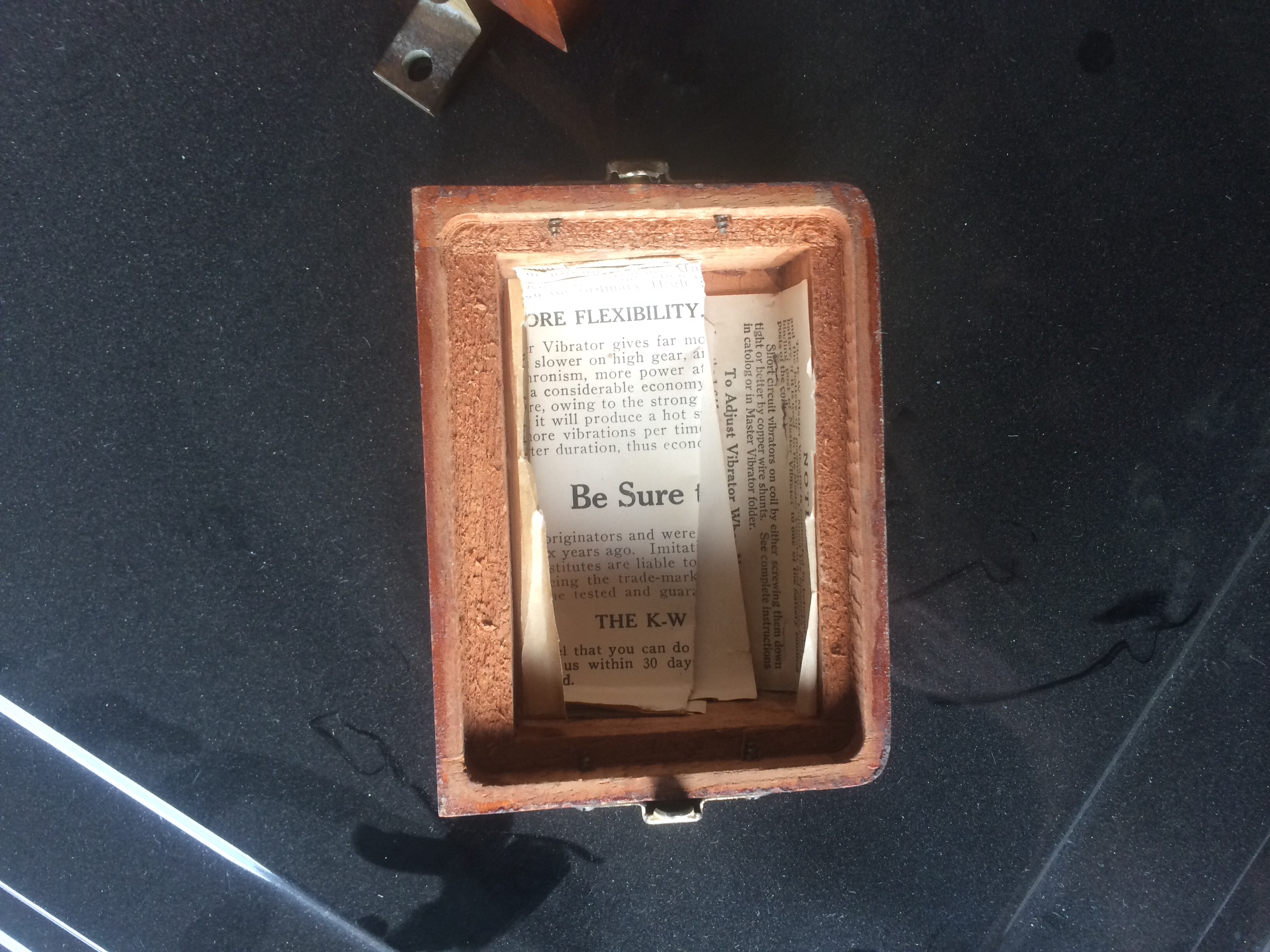

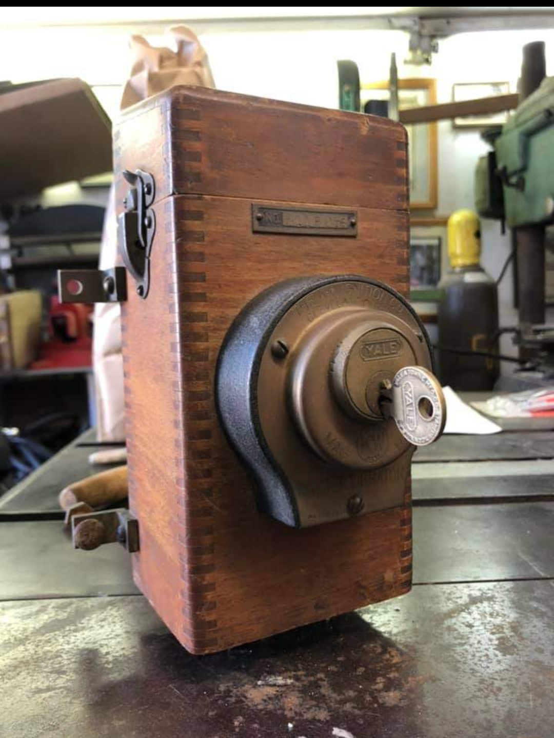

Merry Christmas friends.. I recent acquired this early KW Master Vibrator and wanted to use it in my ‘14 runabout. I really don’t need it because the 4 Brent Mize coils are excellent but just desired the ‘bling’ factor. And I understand it’s purpose and how it’s wired but don’t seem to have any room on the firewall. So, in the Forum’s collective opinion, are speedometers and master vibrators mutually exclusive ? FYI, I really think it’s NOS and the excellent original instructions are folded in the lid..

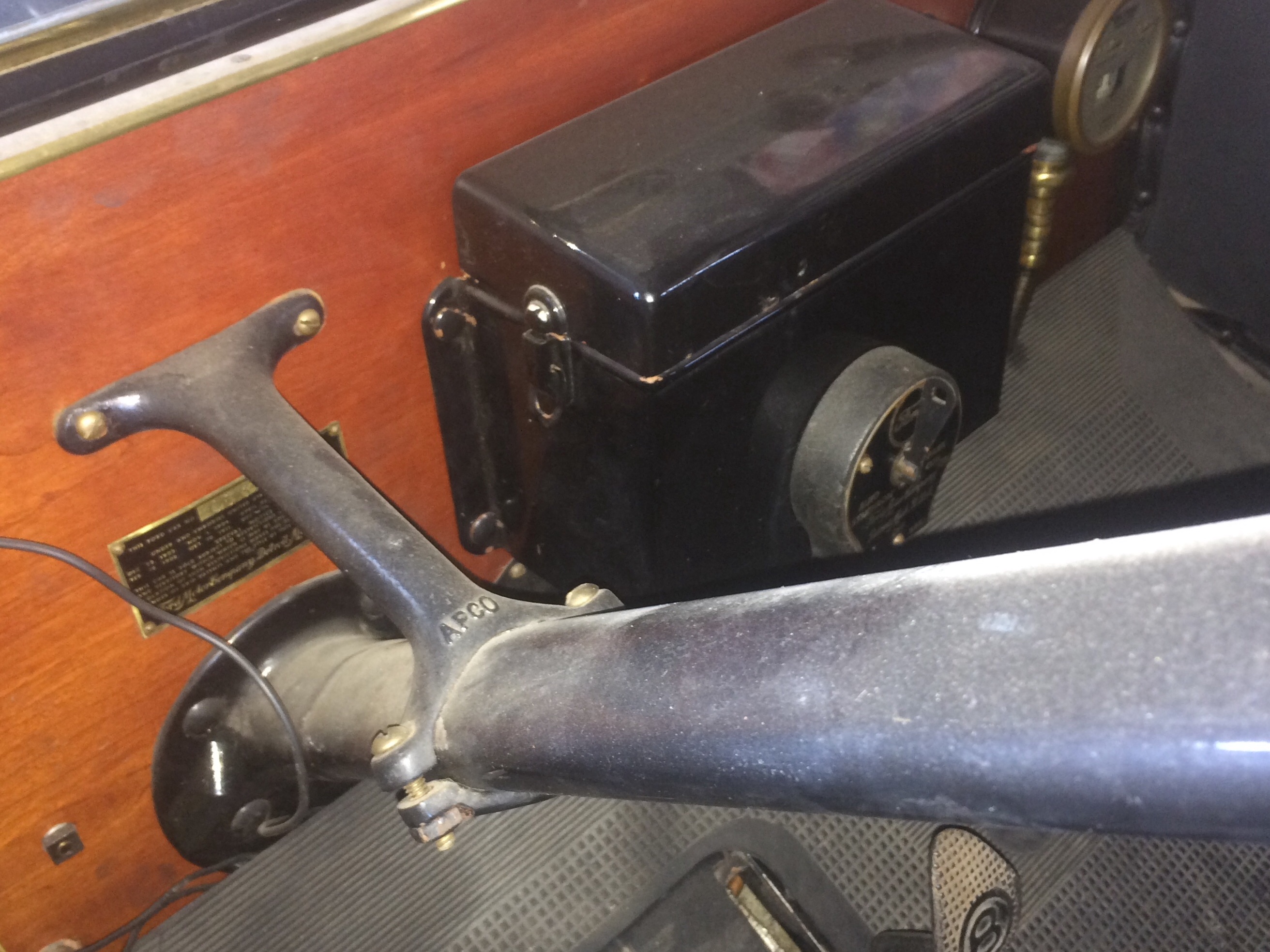

Is there room to the left of the steering column?

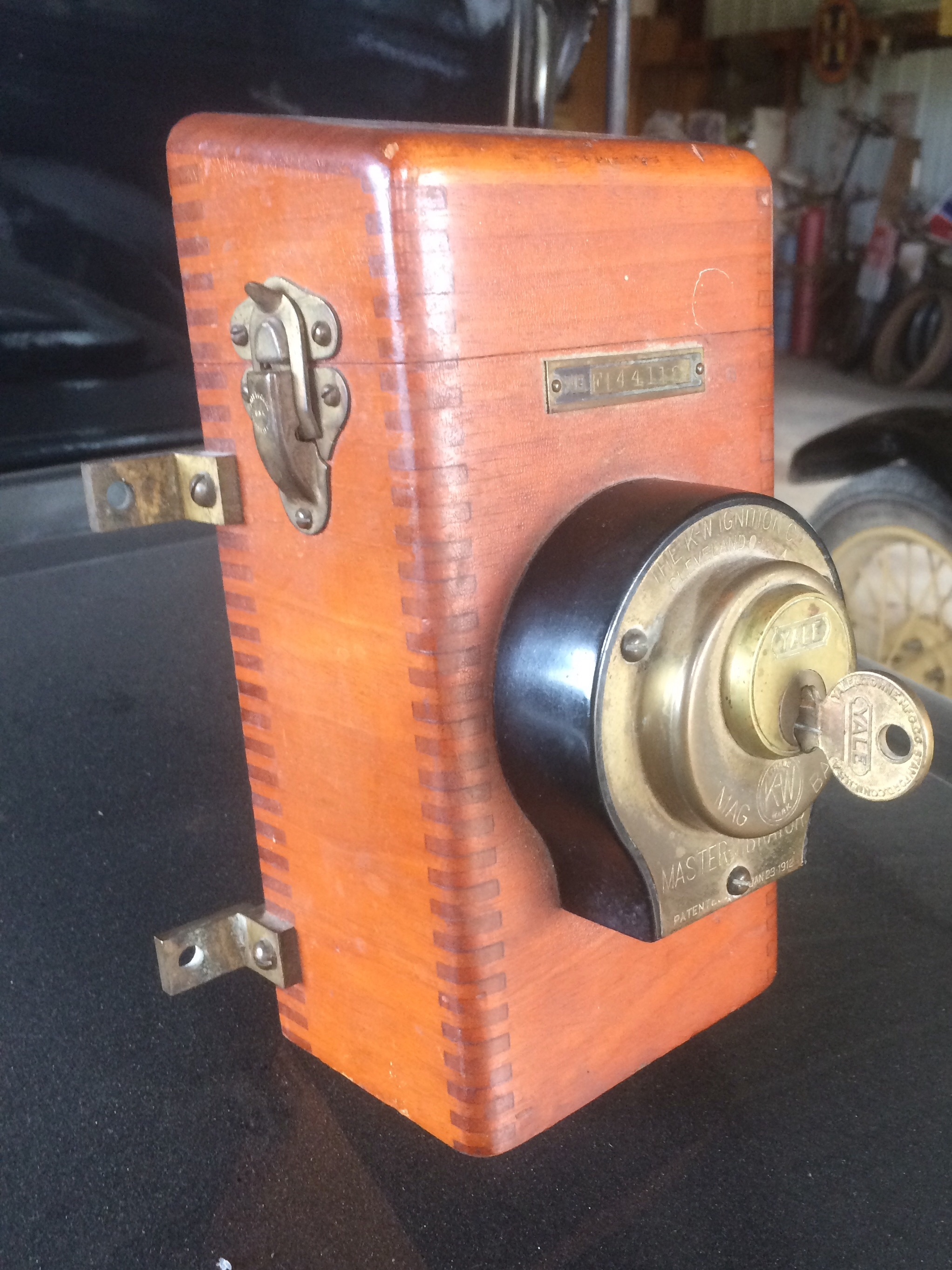

A KW master vibrator would have had a KW switch. Very nice master vibrator but with an added on switch.

Looks like a KW Master Vibrator to me John. May be an earlier version of yours. Les, none of the 4 brass brackets can find a place to mount wood screws to the left of the steering column

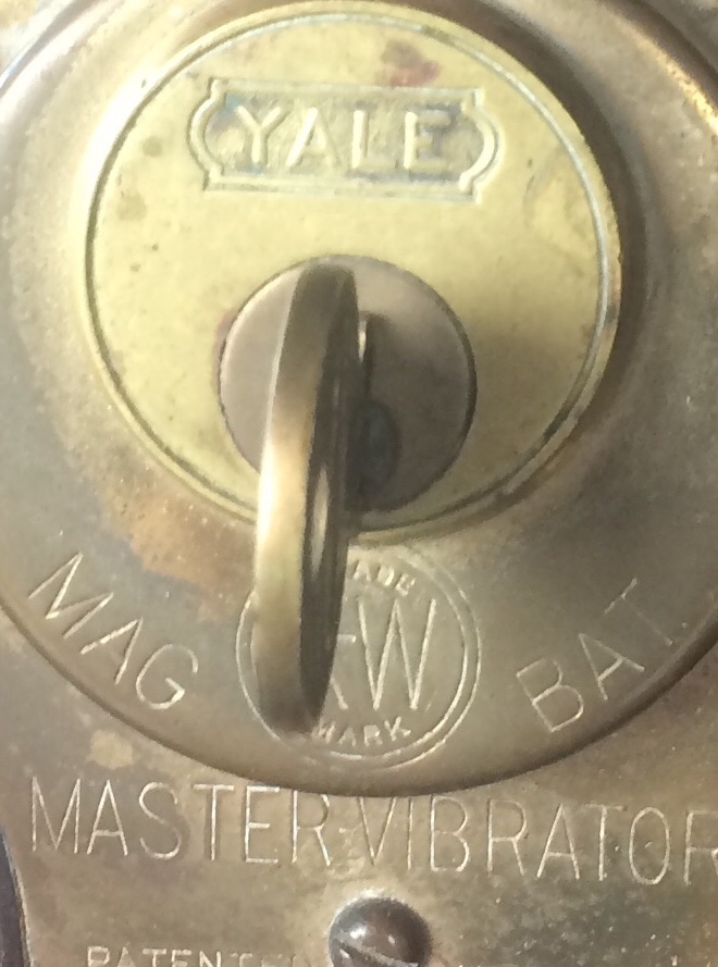

- Posts: 5470
Re: Mounting a KW Master Vibrator on a 1914
That's an anti-theft switch - I have one like it on my KW Master Coil also.

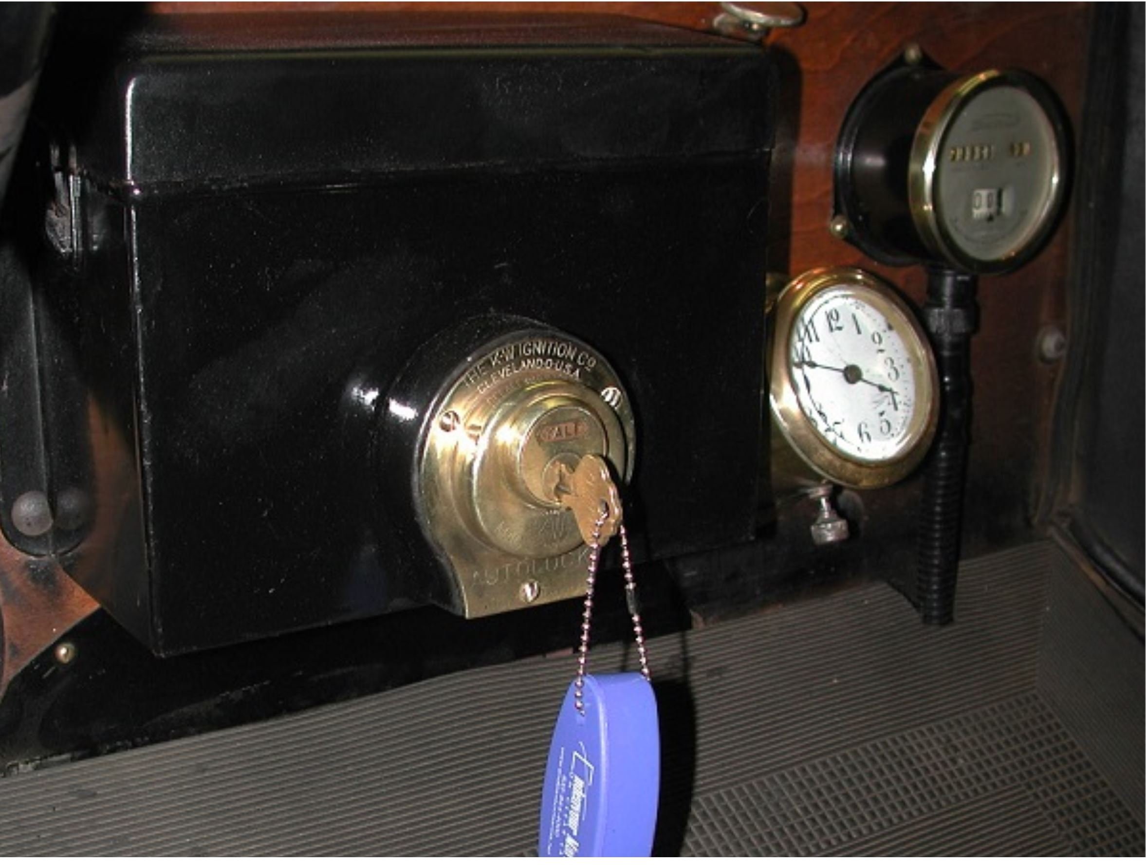

The KW Master Vibrator could be purchased with the regular kick switch or the autolock switch. Here is a advertisement and photos showing both styles.

Very good ! Great information all ! I never considered covering up the data plate Ed. Is it difficult to access the switch that close to the top of the steering column ? And both styles were offered at the same time according to Todd. This might be the earliest version of a unique key for a Ford instead of the common coil box key of 1909-1922 that’ll start all of em
And if I mounted it above the steering column I’d have to lose the APCO column bracket. think I’ll forego the MV Installation..

KW also made the "AUTO LOCK" switch for the 1913/1914 coil box.
The only difference is "AUTO LOCK" stamped just above the lower mounting screw.
I have both and the internals are the same.
Also, the locking KW switches don't have the same internals as a regular
Ford metal coil box switch but they mount the same.
Doesn't help with the Brassitis, or Woodboxitis, but a bit easier to just change your two switches.
