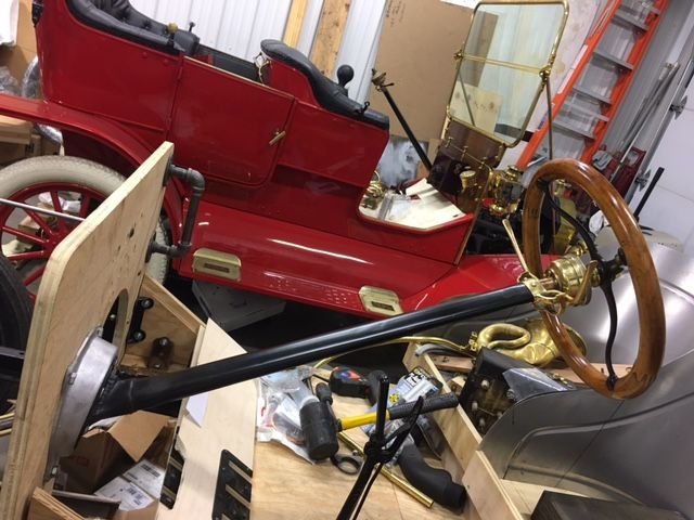

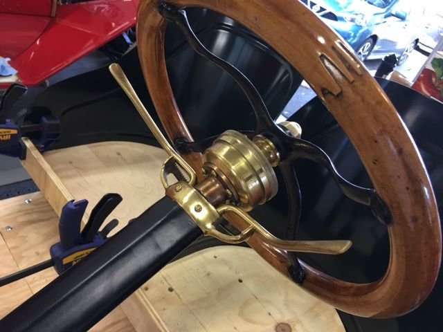

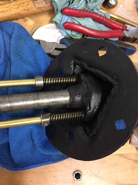

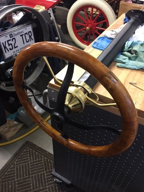

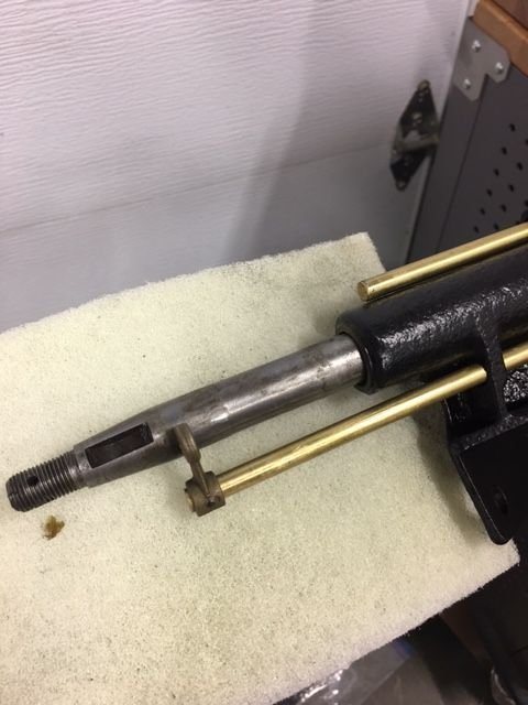

Hi Larry, I followed step by step part I & part II. It was a success. Very well presented.
The link: https://modeltfordfix.com/restoring-a-m ... ng-column/
Picture when is done, hope that help.
Super Mario Bross ;)

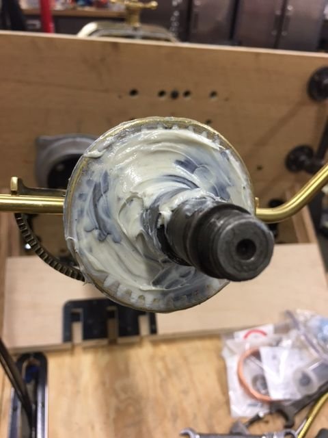

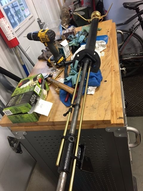

Quickm007
Posts: 1202
First Name: Mario
Last Name: Brossard
Location: Quebec City Canada
Re: 1914 Steering Column
Post by Quickm007 » Tue Mar 09, 2021 5:17 pm

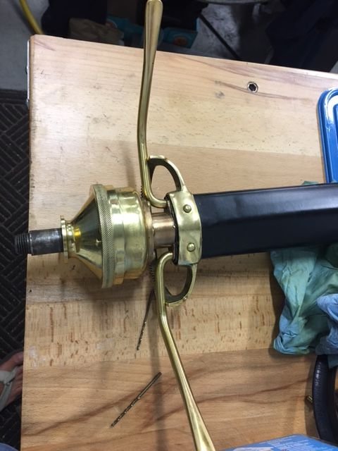

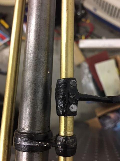

Quickm007
Posts: 1202
First Name: Mario
Last Name: Brossard

Thanks for posting! I've done a 1925 steering column, which is similar, but must less difficult. This '14 column is way more involved, and I have come up with some interesting ways of driving out the small rivets that hold the spark and throttle levers to the rods. I see from the above photos the spark and throttle rods appear to be solid brass, which I don't intend to do. I'm willing to bet they don't have the holes pre-drilled for the spark and throttle levers? I'm going to have the original rods brass plated part way down as original. The brass plating doesn't show in the engine compartment.
Quickm007
Posts: 1202
First Name: Mario
Last Name: Brossard
Post by Quickm007 » Wed Mar 10, 2021 11:48 am
Hi Larry, the brass rod have have the holes pre-drilled for the spark and throttle levers as well. I bought them at Lang's and I'm very please with it. But restoring 1914 steering column it is not an easy task. Need a lot patient and time...
