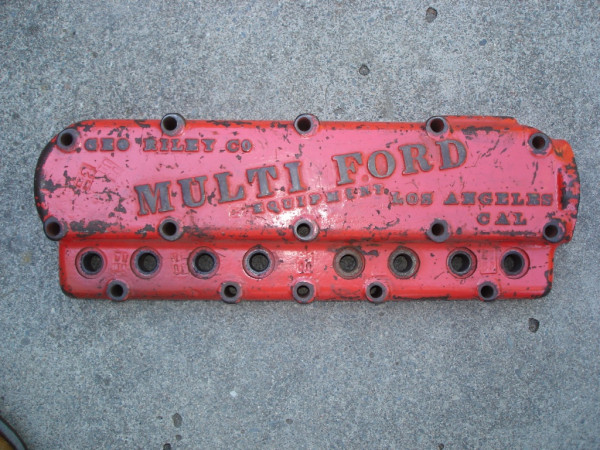

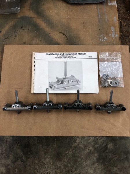

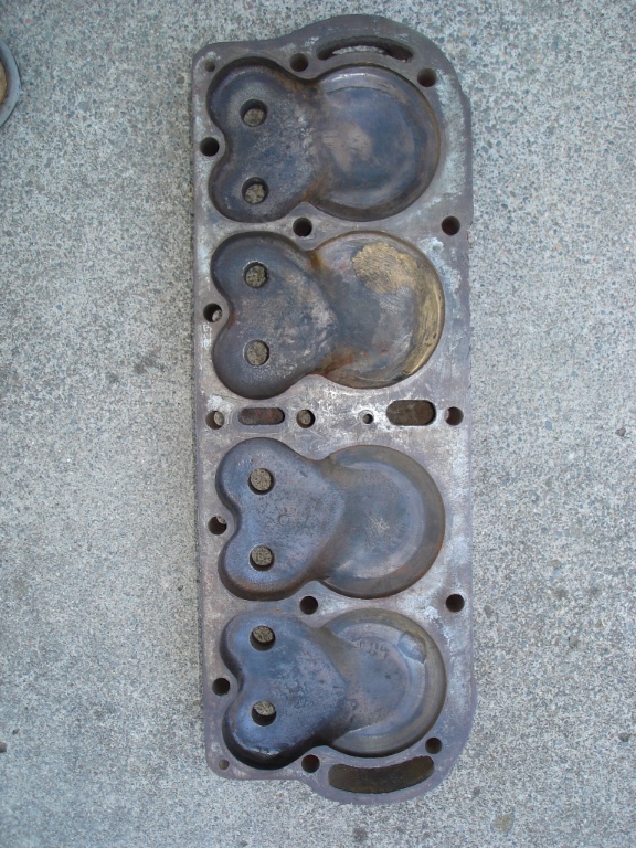

The late Jerry Hunt reproduced Multi Lifts a while back and sets pop up from time to time. When Riley was originally making his Multi Lifts he was also producing a head to be used with them.

A question that is related to the double spark head. I finally got one after a looong quest. What spark plugs are best suited for these heads ? As to the lifters, I wonder if it is a challenge to get the bases locked down good and tight so that they do not move ?

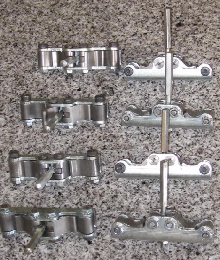

I have a set of new reproduction multi lifts. I am thinking about installing them just on the intake valves. I know some people that have run them quite successfully

Heres a set for $410.00 with shipping.

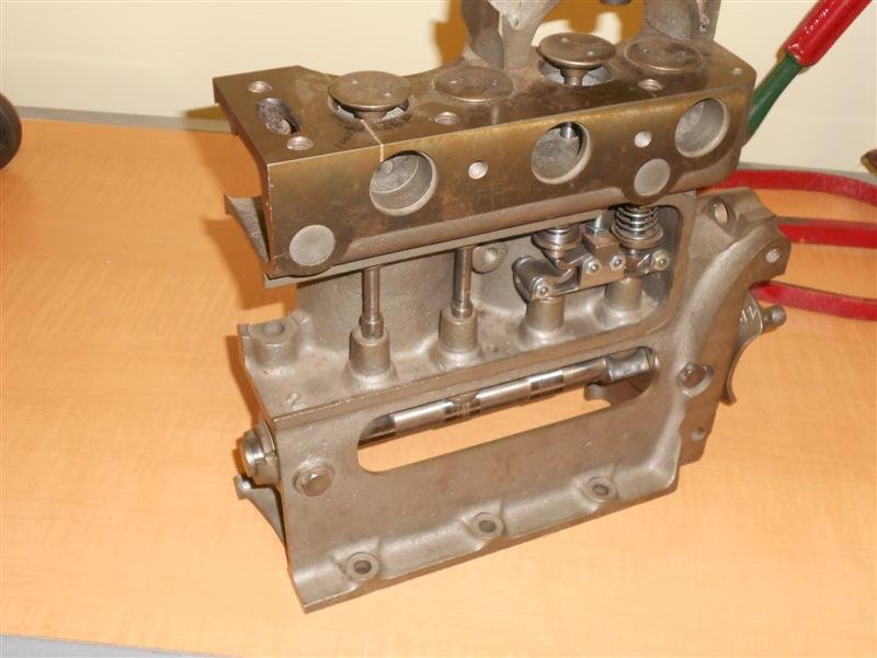

The device for holding the multilifts in place and lubrication seems to be the big issue. The very colorfull pictures show a beefed up version as for this picture. Running a line from the hogshead or drip oilers may solve the lubrication issue
Craig.
